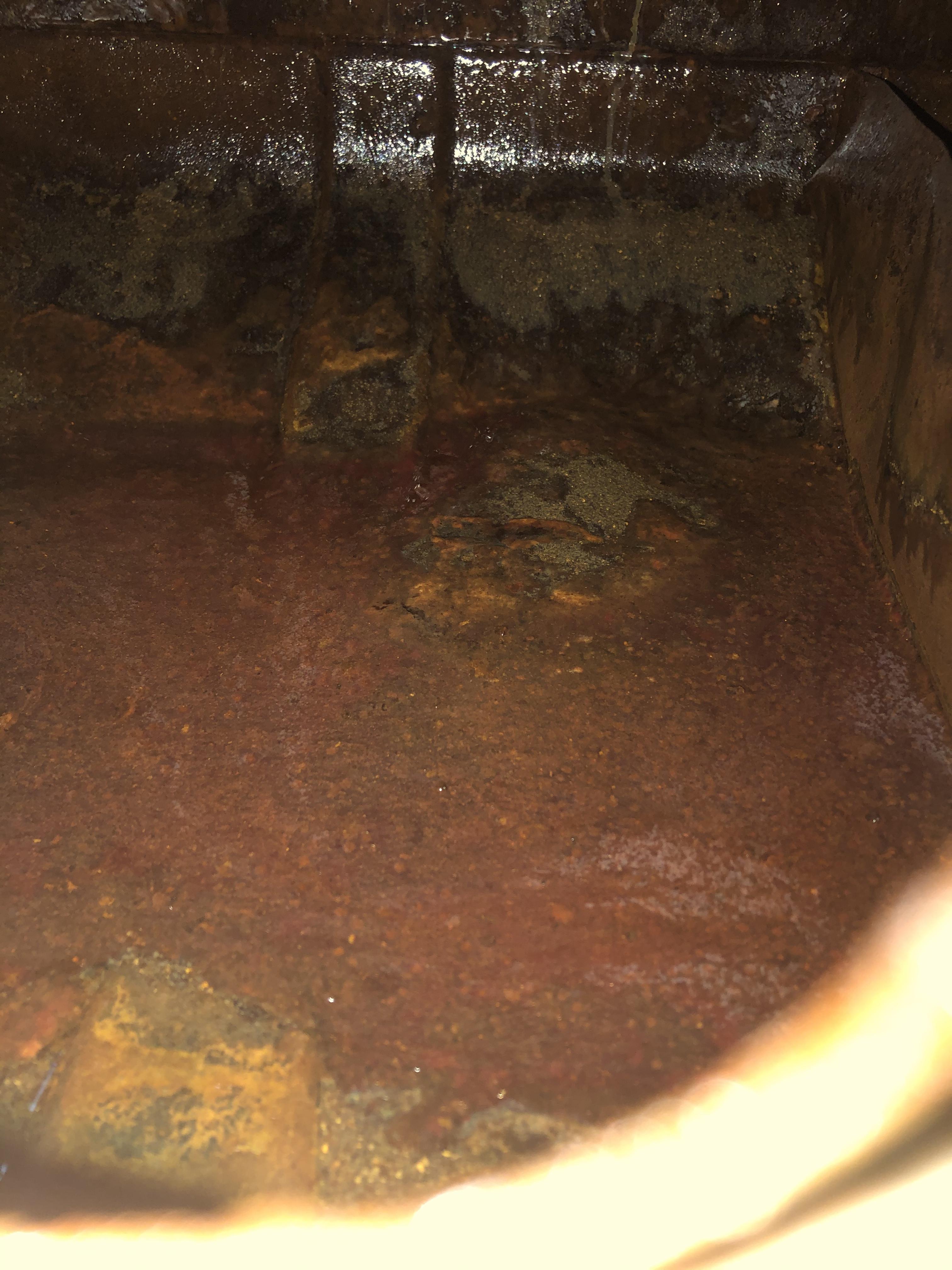

1 hour ago, siteunseen said:
Awe man that's needing an acid wash. I don't see any red kote just rust. I can find some info on my cleaning tomorrow. The Tide is on now so I'm OUT.

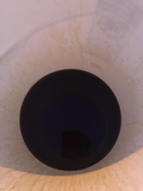

lmao , that is after the first quart of acetone when i poured it out came a dark brown/orange color.

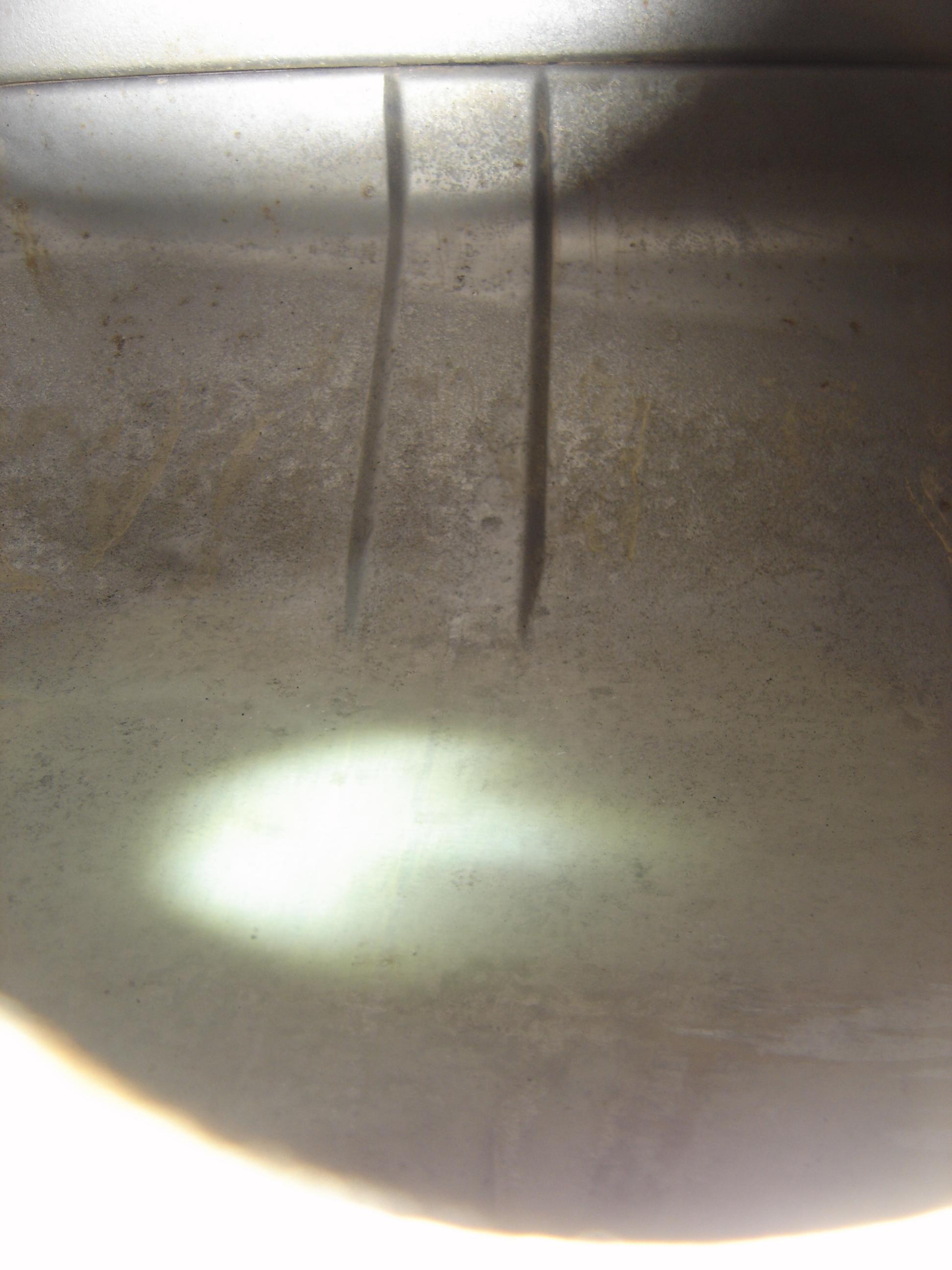

this is how it sits currently. after spraying it out at the car wash , 2 tanks of water/baking soda and 2 acetone cleanings.

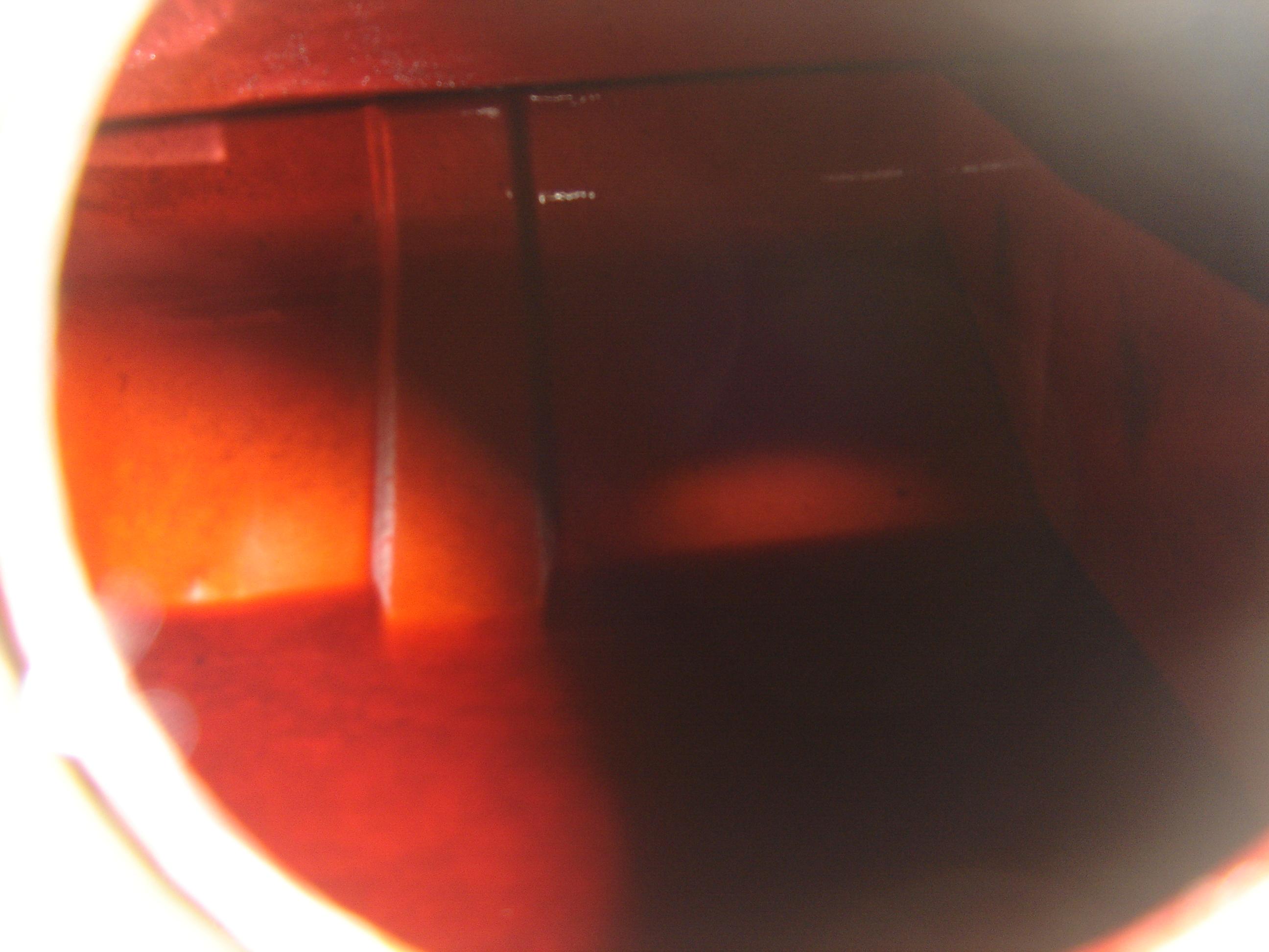

After acid and baking soda then acetone.
Then Red-Kote

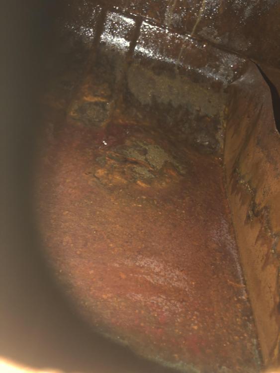

I think your's has coating settled in the bottom. At first I thought it was rust like the sides have, definitely rust on the sides. I think the previous owner had it cleaned and coated either himself or a radiator shop did it. He put it back in and then fuel too soon now you have what you seen.

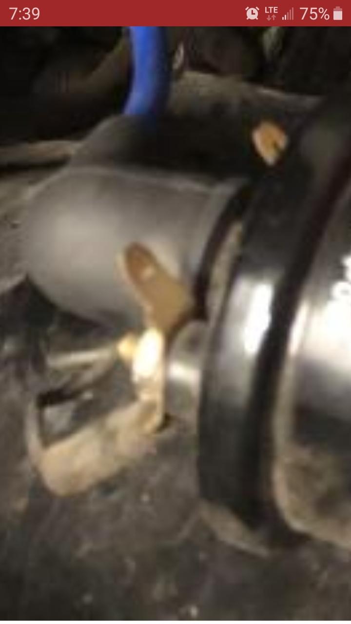

Here's the new sending unit you may want to replace...
