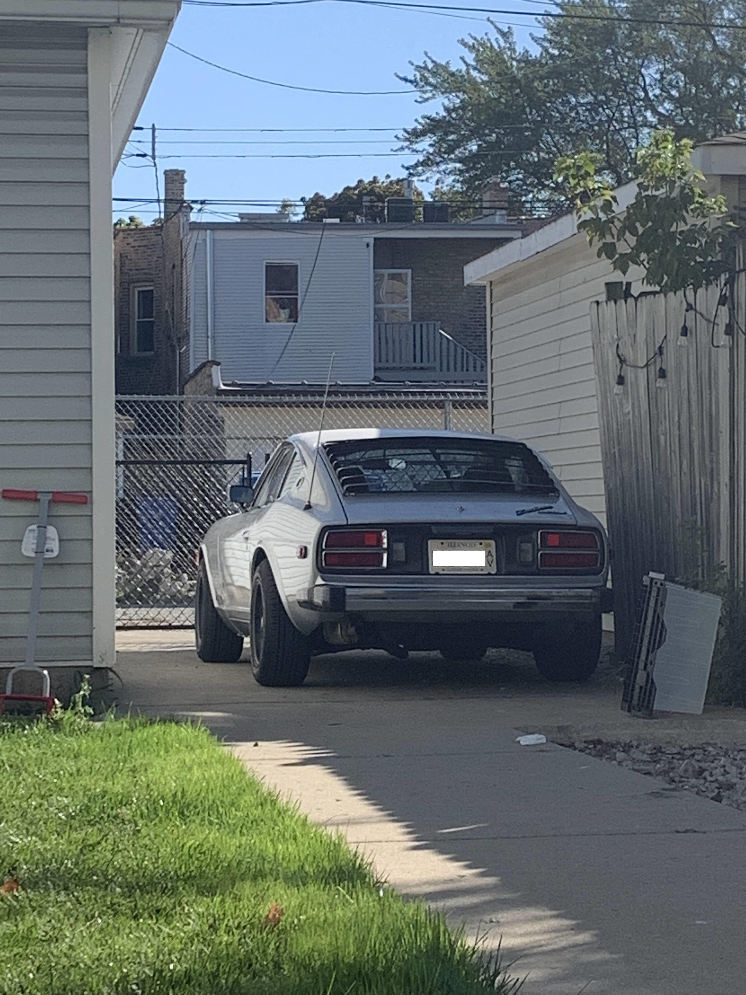

@Zed Head, @Patcon, @iscnetwork IT LIVESSSSSSS!!!!!! Put the starter it back on the car and jumped the car from the starter and that got it to turn over. Not sure why that did it. I can now start it using the key and battery. Maybe it just needed a little extra juice to break it loose the first time? Or the process worked loose some corrosion that I wasn't able to see. Either way, its running!
