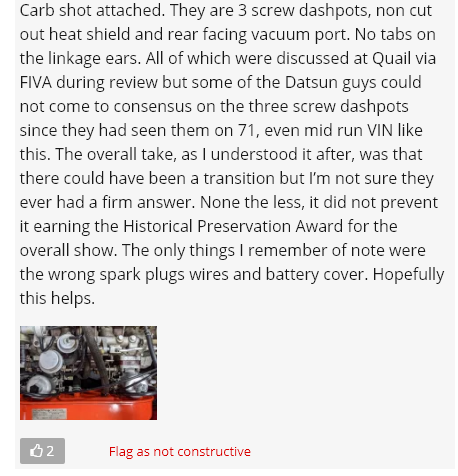

Well!  For all your consideration of how the Wob was going to account for the carburetors, what you didn't consider is no answer at all.  Of course this speaks volumes but we are watching a sham anyway.  We all know it.  I find this all very entertaining.  The testimonials are vomitoriously delicious.
Right! And taking a cue from Arlo, there was a third possibility that we hadn't even counted upon.
"Yes, they are the three screw carbs and someone at the big important show already raised the question if they were correct. And at the big important show nobody knew for sure if it was right or not, so they gave it a nice trophy anyway. So with my trophy as evidence, I claim that they are the right carbs for the car."
I believe it's a variation on the 34th street defense.
He says that people had seen three screw carbs on 71 cars. Well no duh. The transition date (according to the admittedly little research I did) is August or September 71. I could see those cars could maybe be titled as either a 71 or a 72. But......
The car in question on BAT is a whole year BEFORE that!!  Door jamb plate says 8/70.

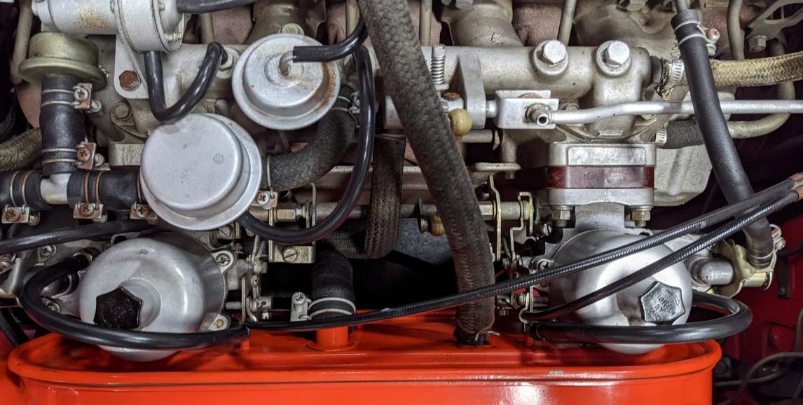

I'm nearly 100% certain that the intake manifolds are the E46 version that works with the four screw round tops. The three screw round tops were not matched to that manifold because of the coolant scheme. Instead, the three screw carbs were paired with the E88 intake manifolds. So my question is... What manifolds are on there? If they are three screw carbs bolted to the E46 manifolds, then shapes of the carb faces do not match and the coolant holes on the carbs are hanging open to the wind.
So it's a 70 head, a 70 block, 70 manifolds, 70 everything...... Except for the 72 carbs. Came from the factory like that.
Yes, factory parts manuals state that the ('4-screw') HJG46W-3A carbs were used up to the end of 08-71, and the '3-screw' type was fitted from 09-71 up.
No doubt some people will be satisfied with the HVA award somehow proving that the car was 'preserved' enough in the opinion of judges, but I'd say a much more likely scenario is that they didn't really know enough to make an accurate judgment.
The carbs currently fitted to the car are at least a year later than its 08-70 build date.

And I don't think the carbs would even be that big of a deal if we knew what happened. I still suspect that sometime long ago, the carbs were sent off to be cleaned and tuned and all that, and the ones that came back aren't the same ones that were sent off. From what I gather, some of the big name players in the round top carb realm do that. You send them a pair, but the pair you get back are not necessarily the ones you sent them.
At this point, it's mostly the denial that gets me. The seller knows the car is worth more if it's that "beacon of originality", and hence, isn't giving up on that.
If I were a judging this car at a show in a high quality, high profile stock class, I would ding it for the wrong year carbs. I just hope the new owner understands that could happen to him. And a defense of "Well the guy I bought it from said they were OK." wouldn't change anything.
