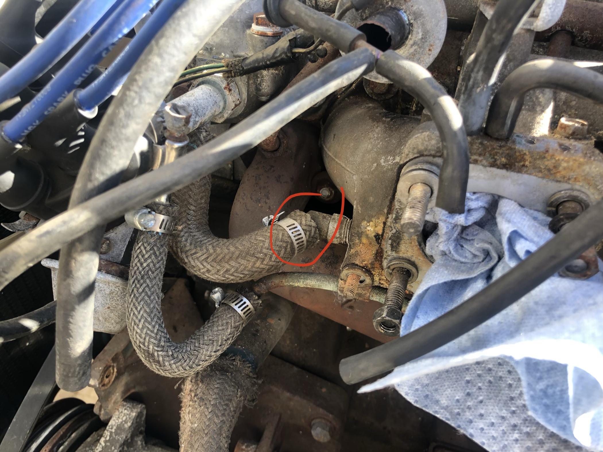

A seemingly good idea I’ve read is to just bypass the intakes by putting a hose straight from the thermostat to the hardline at the rear of the engine. Can anyone tell me if this is a terribly bad idea?

It’s intent is to warm the carbs when the engine is cold, to improve drivability and reduce emissions. It was found with the issues around heat soak and vapor lock that they wanted to turn that hot water source off so they added a heat activated valve at the back of the last carb to turn the hot water off once the engine was fully warmed. No need to heat the carbs once the whole thing is all toasty. You can see the 73 version in your picture above just behind the red circle.
The early Z’s had that line with no restriction.
The common thing to do is just lose that coolant line altogether and, if you drive in cool weather, put up with maybe slightly poorer drivability until the car warms up. If you want to keep all the lines and such for nice correct appearance and ease of plumbing, then I’d plug the line internally at some hose connection and get the best of both worlds

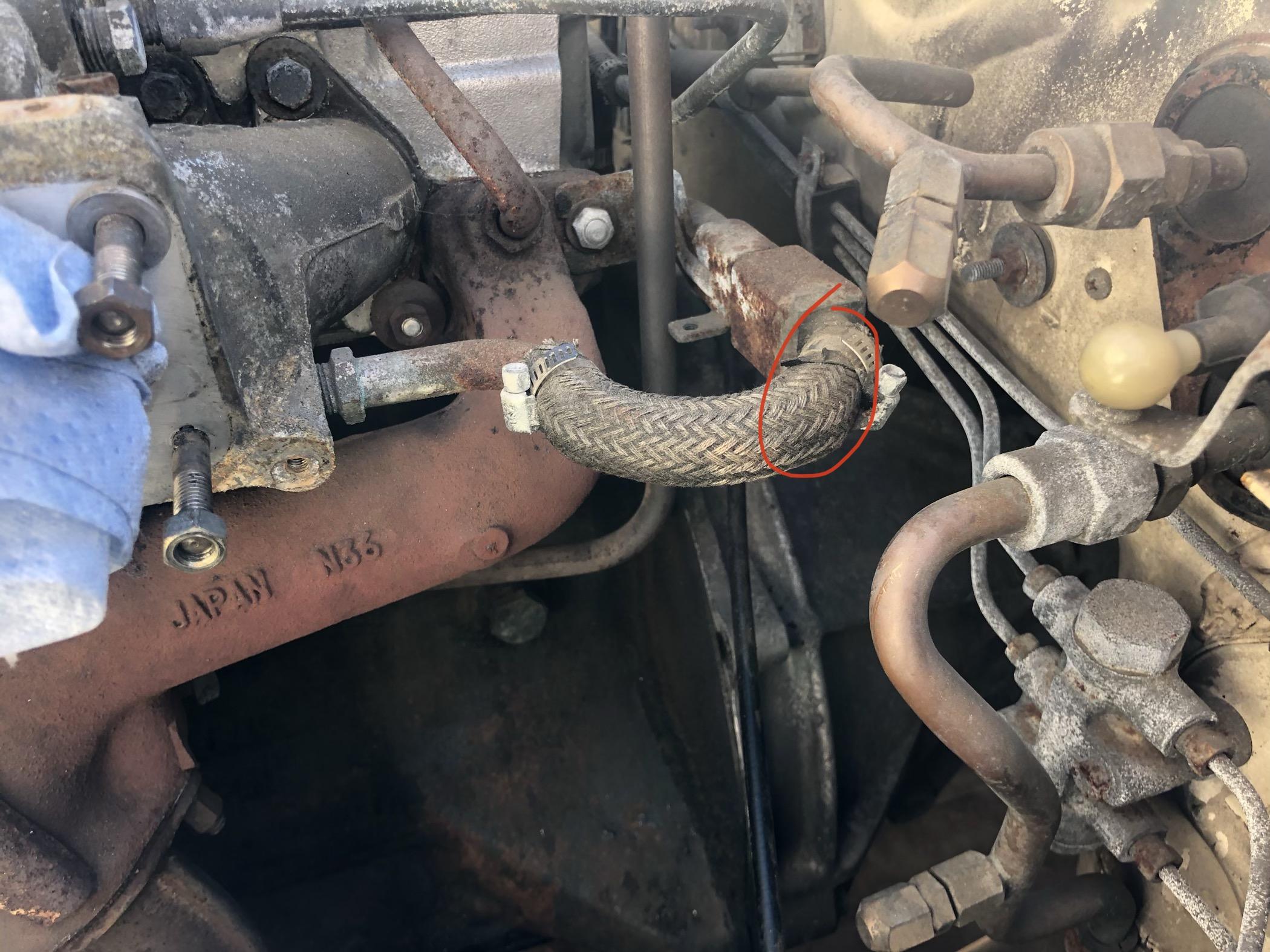

@Zed Head if I’m understanding you correctly, you’re saying I should a keep a line there to retain the flow of water? Which is my thought on the matter, that more water moving is kinda better for cooling purposes? Which is why I want to keep a line there, just add like a rubber hose to effectively replace the hardline between the manifolds that is rusting and leaking.
Though I guess completely deleting the that water passage is an option as per what @zKars And @AK260 said which is interesting as seemingly that line isn’t crucial to the circulation of the coolant.

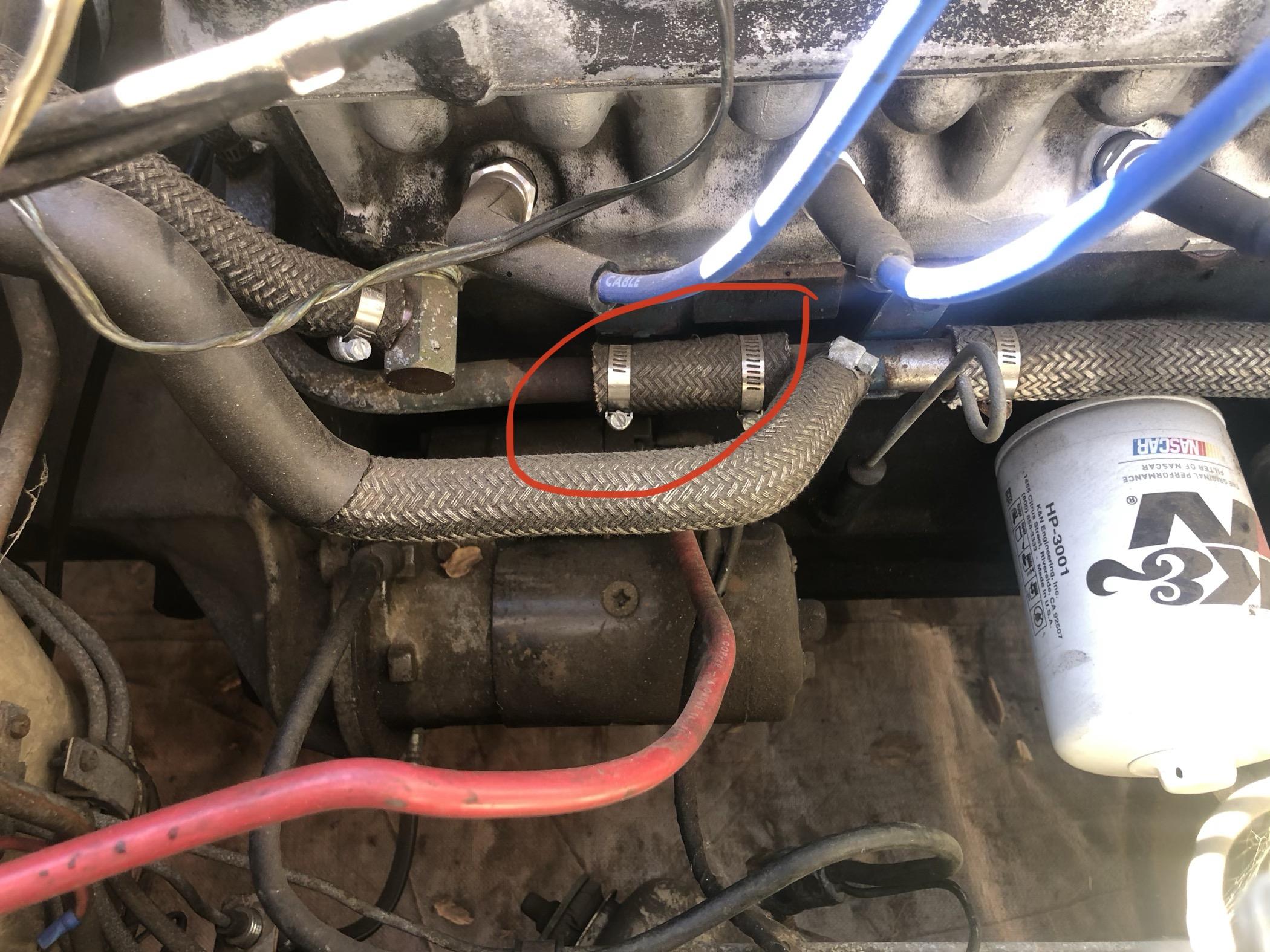

The only janky thing is the plugging you'll have to come up with for the coolant that runs under the spark plugs that hooks to the hardline behind the cylinder head. I put a steel threaded plug in mine with a hose clamp. I don't care though, it's no show car. Function over fashion.
@siteunseen Are you saying to plug the line on the spark plug side of the engine (Pictured?) I was thinking to plug it just behind the intake manifold. but on the other side would be a bit cleaner I suppose. Doing that would also stop the water from flowing through the balance tube, which I don’t believe is an issue since earlier cars didn’t have it that way, but I could be wrong.
