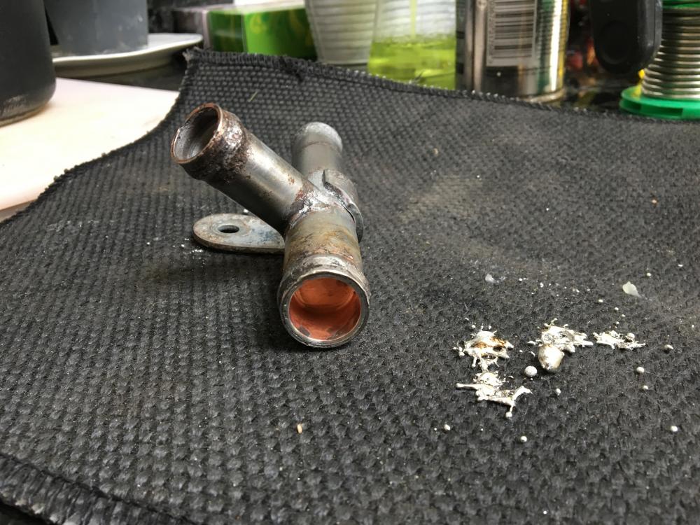

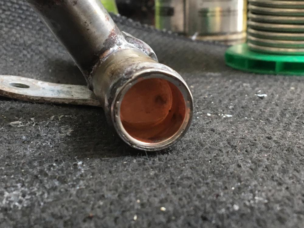

As for the Y pipe, I kept mine but blocked it with some 15mm copper pipe plumbing end stops. They are just the perfect diameter to hammer in and for good measure I added a tiny bit of solder - which really wasn’t necessary but I sleep better with it there!

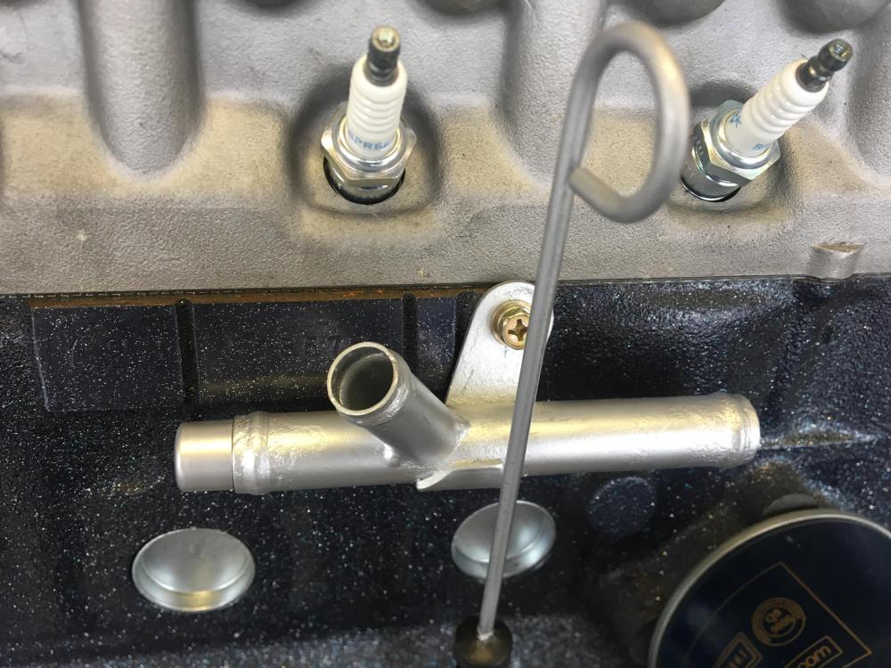

f1af247b3b6190b456f1ab295cffe6ae.jpg&key=304cb79024ffd1ec82e239e9c7fe71c96ffef72c92a4597d63cdebb1cc04aa31c63824174c745f71c8e2b5ea8da95827.jpg&key=c4171693ce0f705591ec267bc662f9a10c20a335d7620ffd13e1faad2261826490057cdf1c98949fc5cf3e9b1fc7ac2f.jpg&key=ebb079006ed3fedf0c9a40b4e7923494a4a4967f65ee497ebdfeca3e68d06479
Spray the whole thing with silver VHT paint and it looks the part!

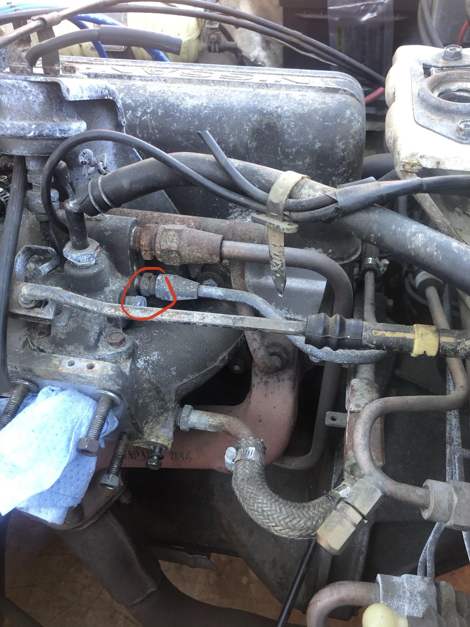

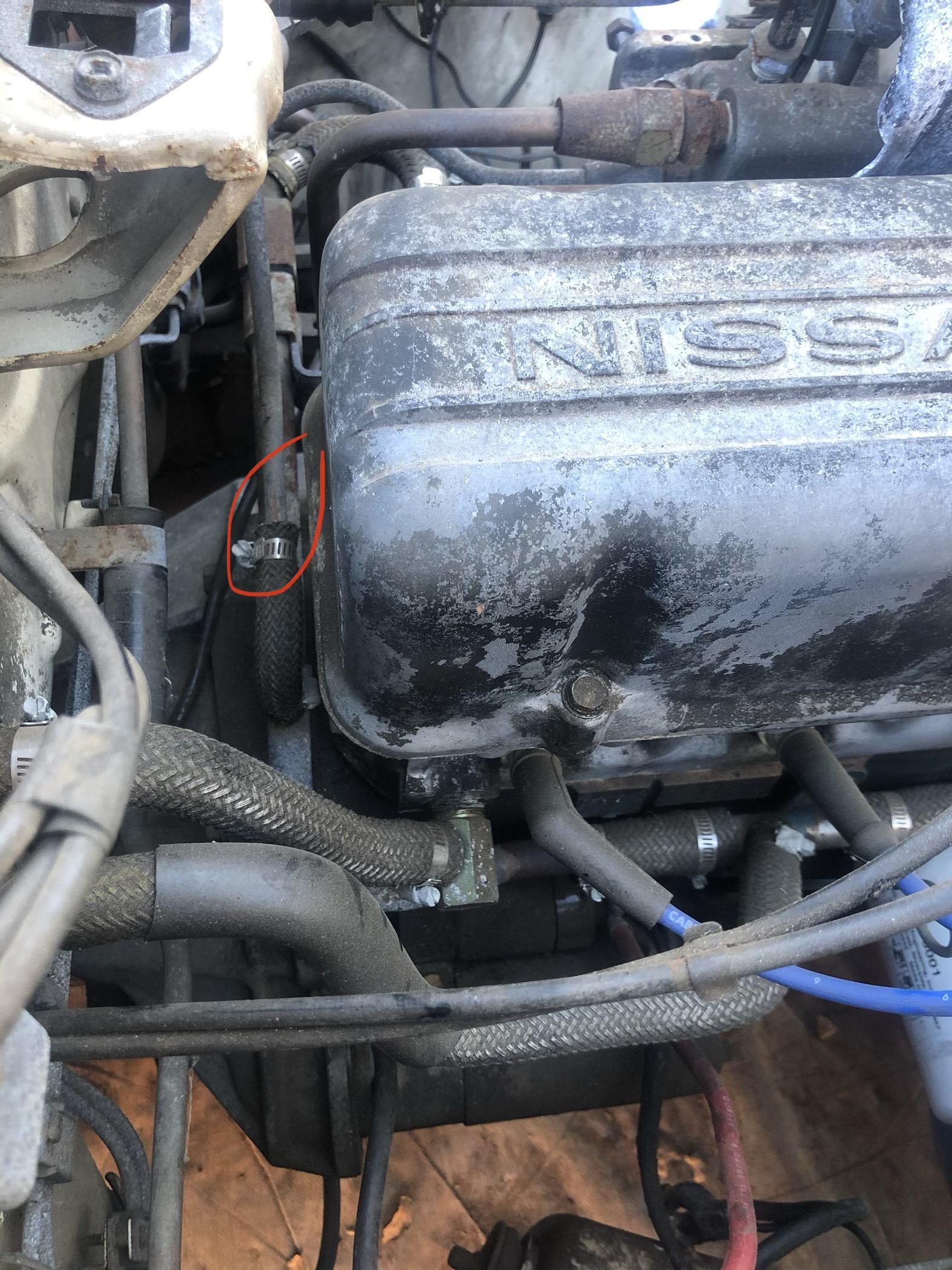

I wanted to kind of make sure we're on the same page here. You say balance tube but that's the one up top with vacuum ports the balance the air between the two carbs. No coolant.

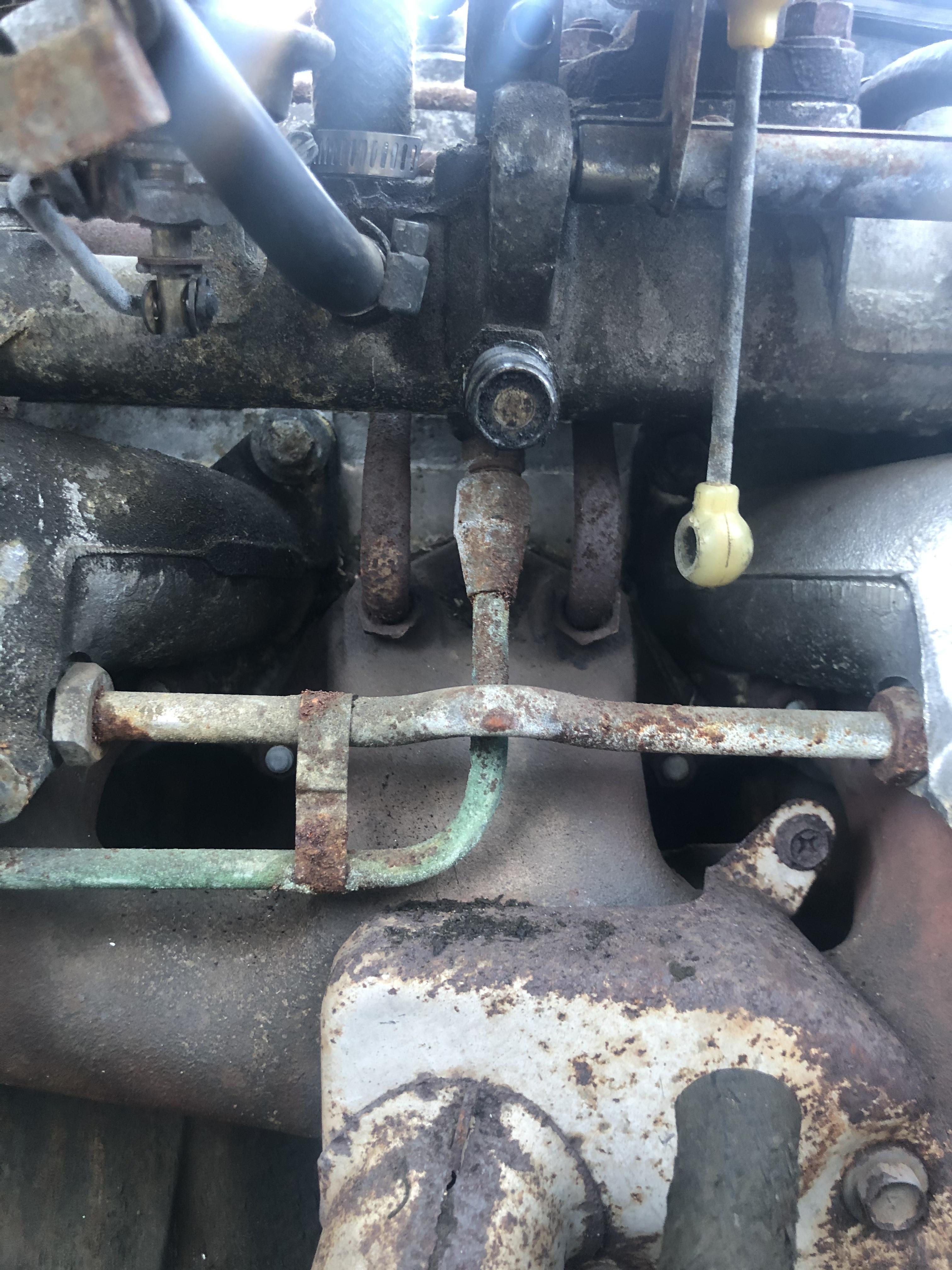

There's a smaller hardline between the intakes for coolant flow. The balance tube is the bigger one on top with the pcv hose connected.
The coolant tube is the smaller one down about 6 inches. It's cad plated is this pic. In between those reddish looking spacers between the carb and intake. I'm using my phone so no paint program to make markings, sorry.
Just wanted to be clear on that.
[mention=23570]Siteunseen[/mention] - nothing wrong with a functional engine bay! It’s how she drives that counts!
Dude, that's genius! Now I'm going to have to do that. Thank you??? LOL
Dude, that's genius! Now I'm going to have to do that. Thank you??? default_laugh.png
Brilliant, glad to be of service! ;)

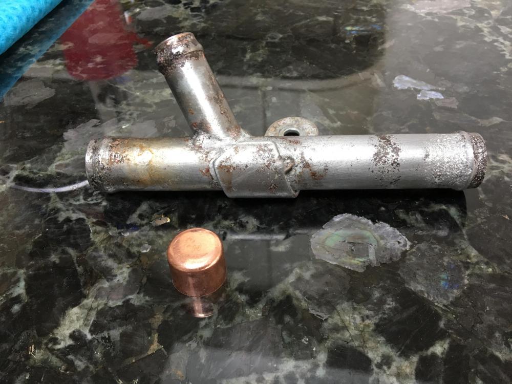

BTW, I was getting complaints about it looking odd, so I got another one, a piece of 15mm pipe just long enough to fit into two cap and hammered them together. See below ...
1c498e0cf76bda1e09c39b8ec18dde78.jpg&key=02f8de26a35430963d387fe8e6e7cf8cea8f1ad3973d423a44f77f8077e59e94

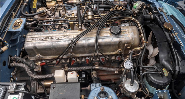

I get the urge to make what you have work.  But, the "other" solution is a long piece of hose and use the guides/holders that a 280Z uses.  Removes many potential leak areas.  On the other hand, a person could put a valve/stop penis on the Y port and use it for flushing the cooling system.
Stole this from the internet to show the 280Z hose.

@siteunseen thank for trying to clear things up! That’s exactly what I’m hear to do! Coming out of the water line at the back of the head, it has a port that goes off and into the balance tube seemingly, as well as there’s another hardline that comes out of the balance tube, right behind the intake water line and then goes to the thermostat.
