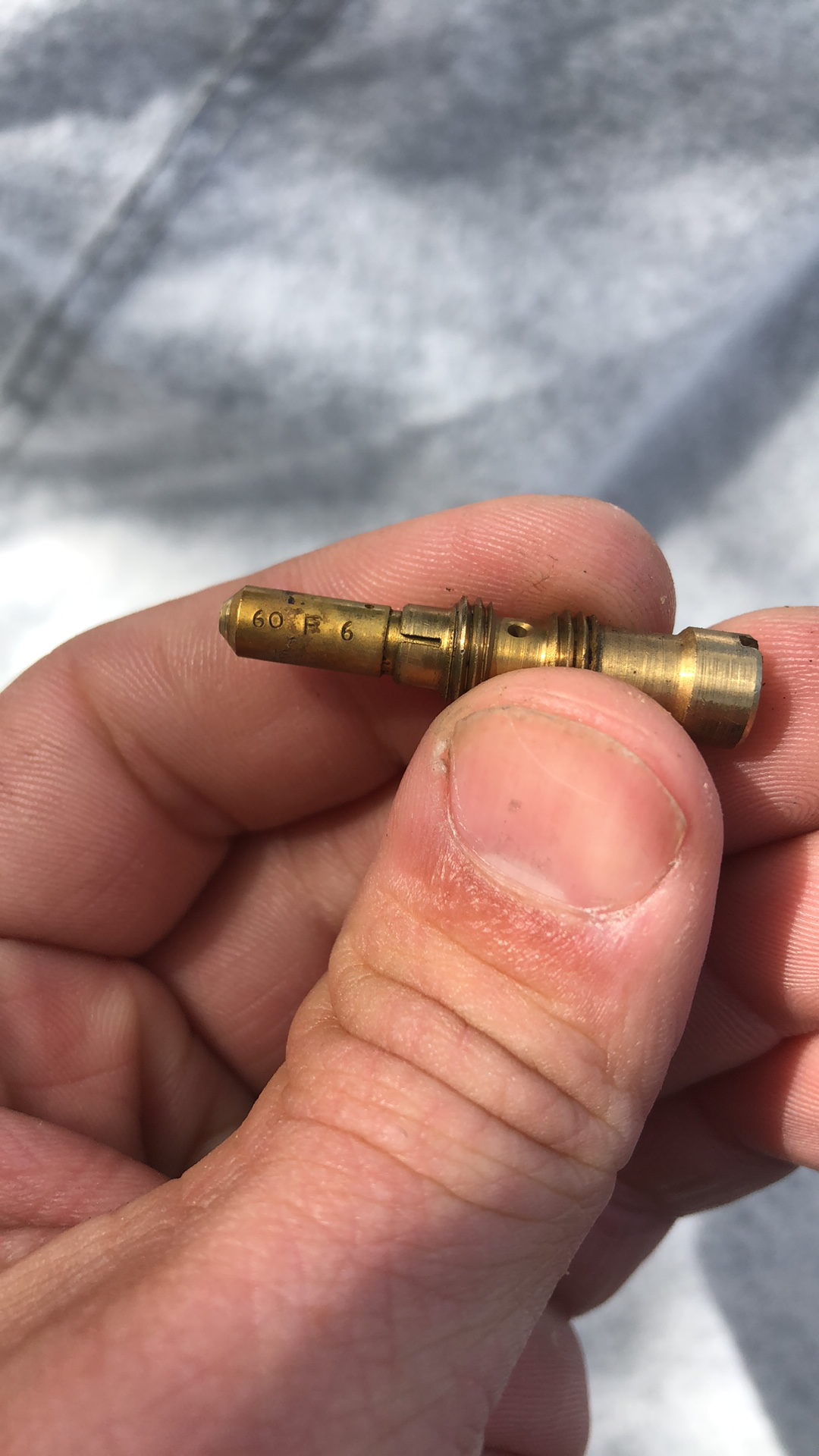

Idle jet lean to rich goes:
F3, F1, F7, F1, F4, F2, F13, F11, F8, F9, F12, F6
At 60 I'd say the pig rich is because it's the richest possible AND too big.

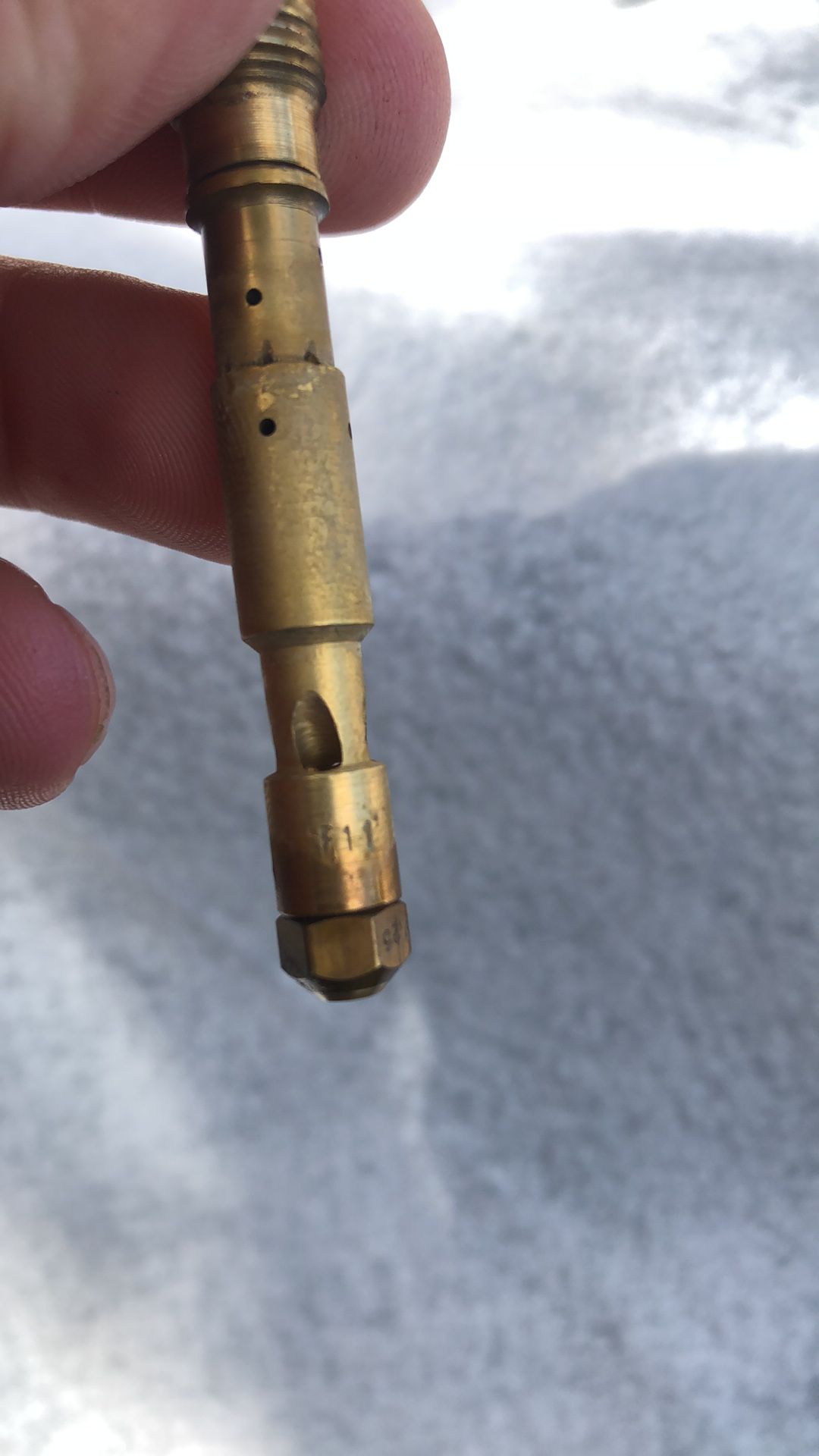

Lean to rich on Emulsion goes:
F11, F15, F16, F2, F8 and F7.
The F11 you have is a lean choice, but emulsion tubes are a bit tricky. They change how and when you main jets work under acceleration, so impact how much the idle has to do.

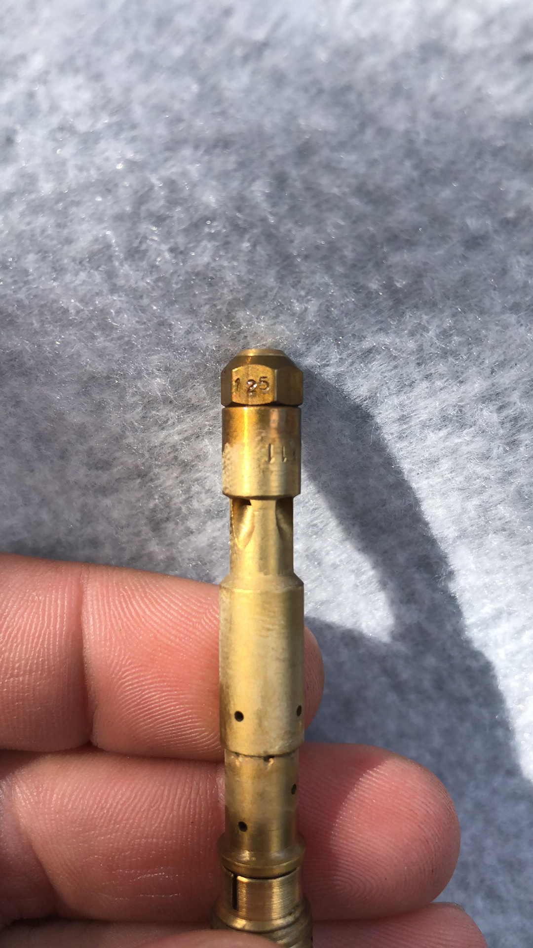

The 125 main jet might be about right.
For now, I'd scale way back on the idle jet, like 55F2, and leave the main and emulsion. I prefer to go one step at a time but 60F6 is way out there.

In this case I'd have a hard time believing the 60F6 idle jet is the right one for the L26. I'm sure it guarantees the car will start when you bolt on the Webers by virtue of being so rich, which might be why they spec the kit with them.
