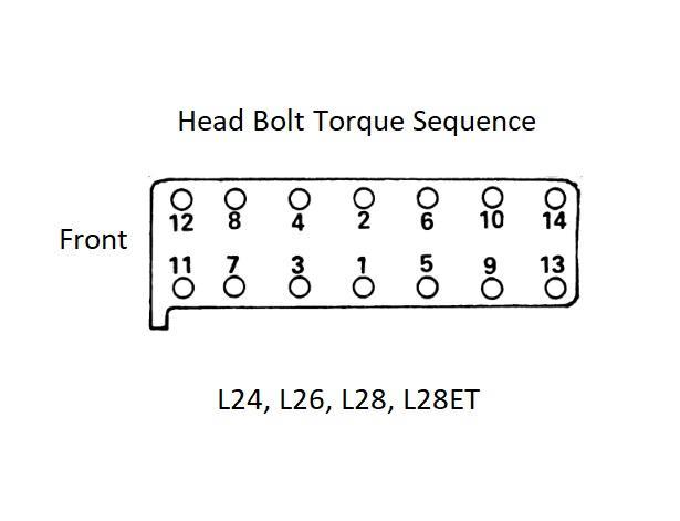

hi again siteunseen , I was not thinking about removing the bolts, I was just going retorque them . do you think I should remove them and anti-seize ? [I do not want to brake the seal even 1 bolt at a time] and thanks for the bolt sequence !!!

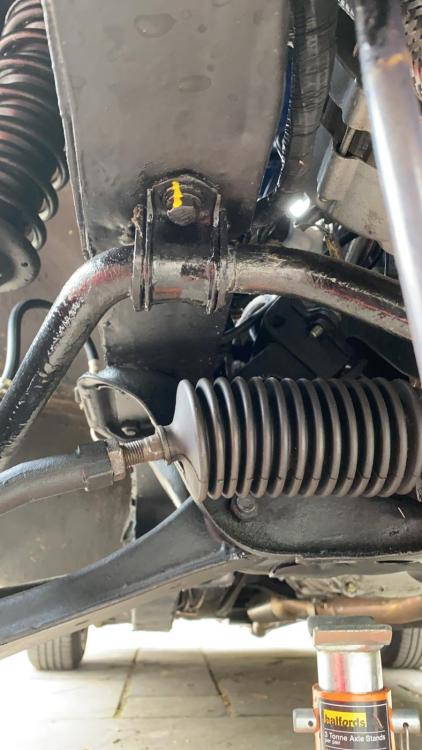

I even do this to my load bearing bolts with yellow paint, so yeah, paranoid!

I always check the headbolts after running the valve adjustment. Set the torque wrench to the specified torque, and pull on each bolt, following the sequence specified in the manual.  Not trying to make them tighter, simply checking that they are all tight. Occasionally one or two will turn a bit, but generally they are OK.
