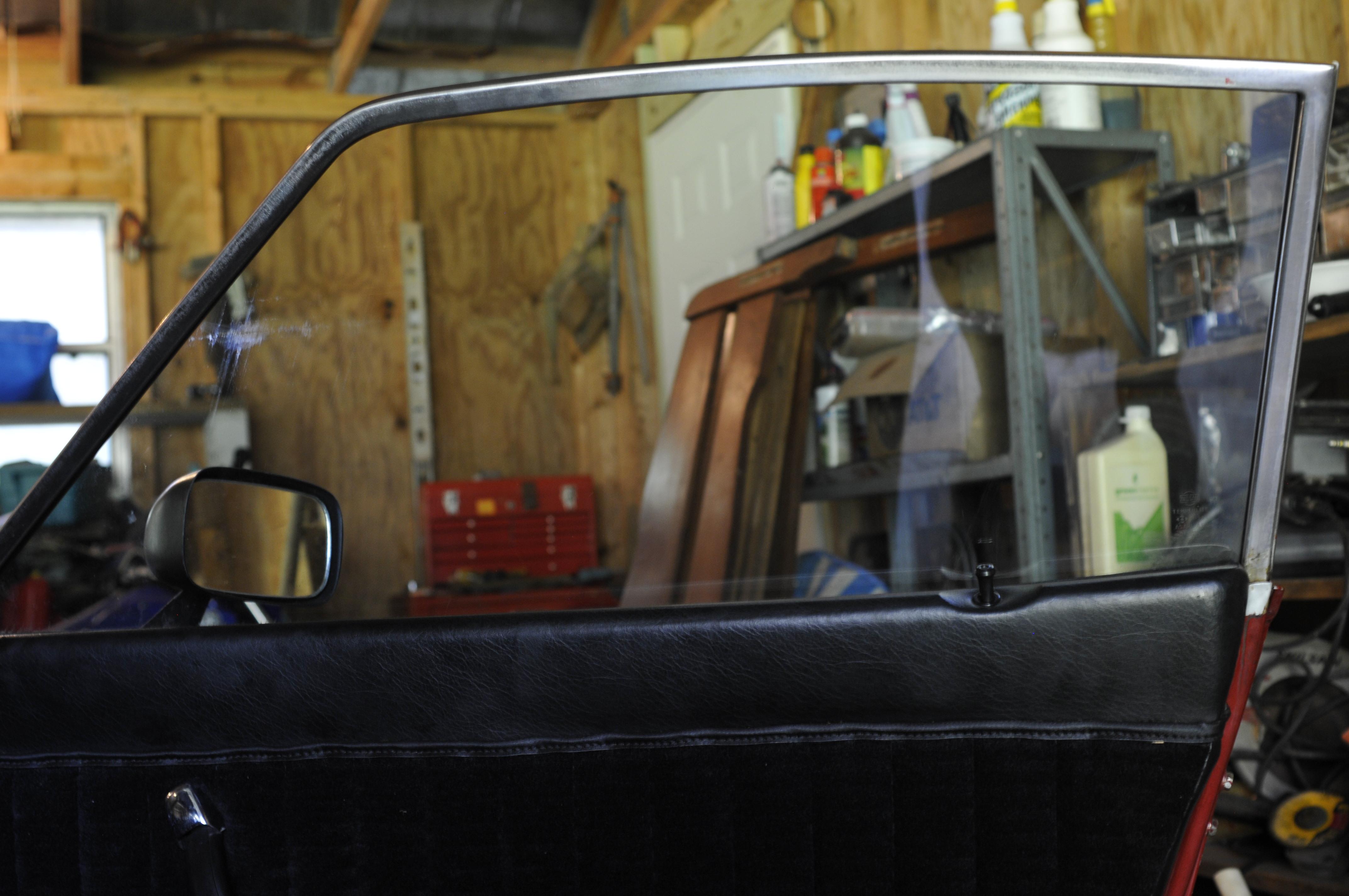

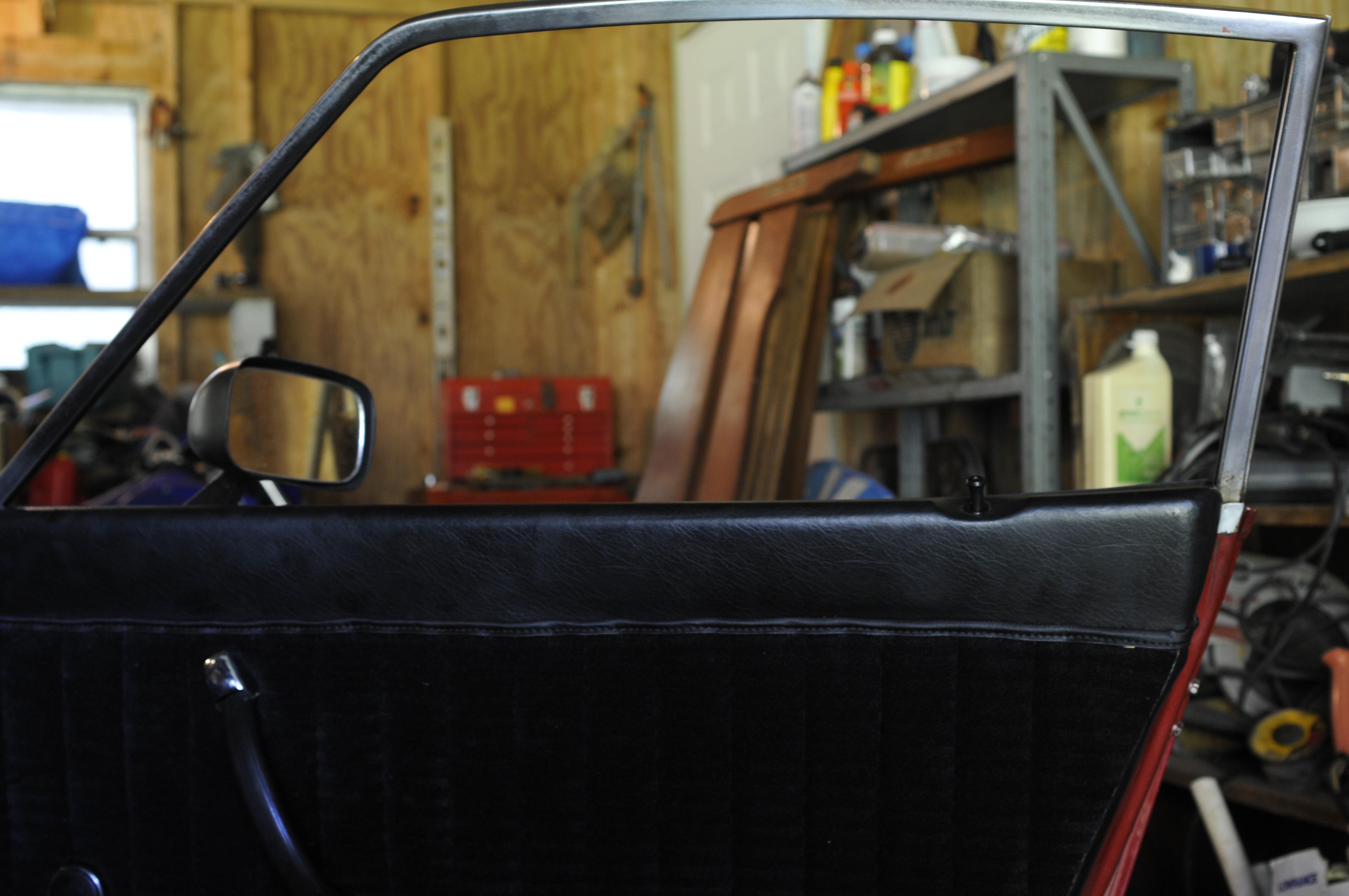

It's all reinstalled and working properly! Put it everything back in the door yesterday, but didn't have the opportunity to takes pictures until today. I believe the smudge you can see on the window is from excess grease - not a scratch. Thanks everybody!
