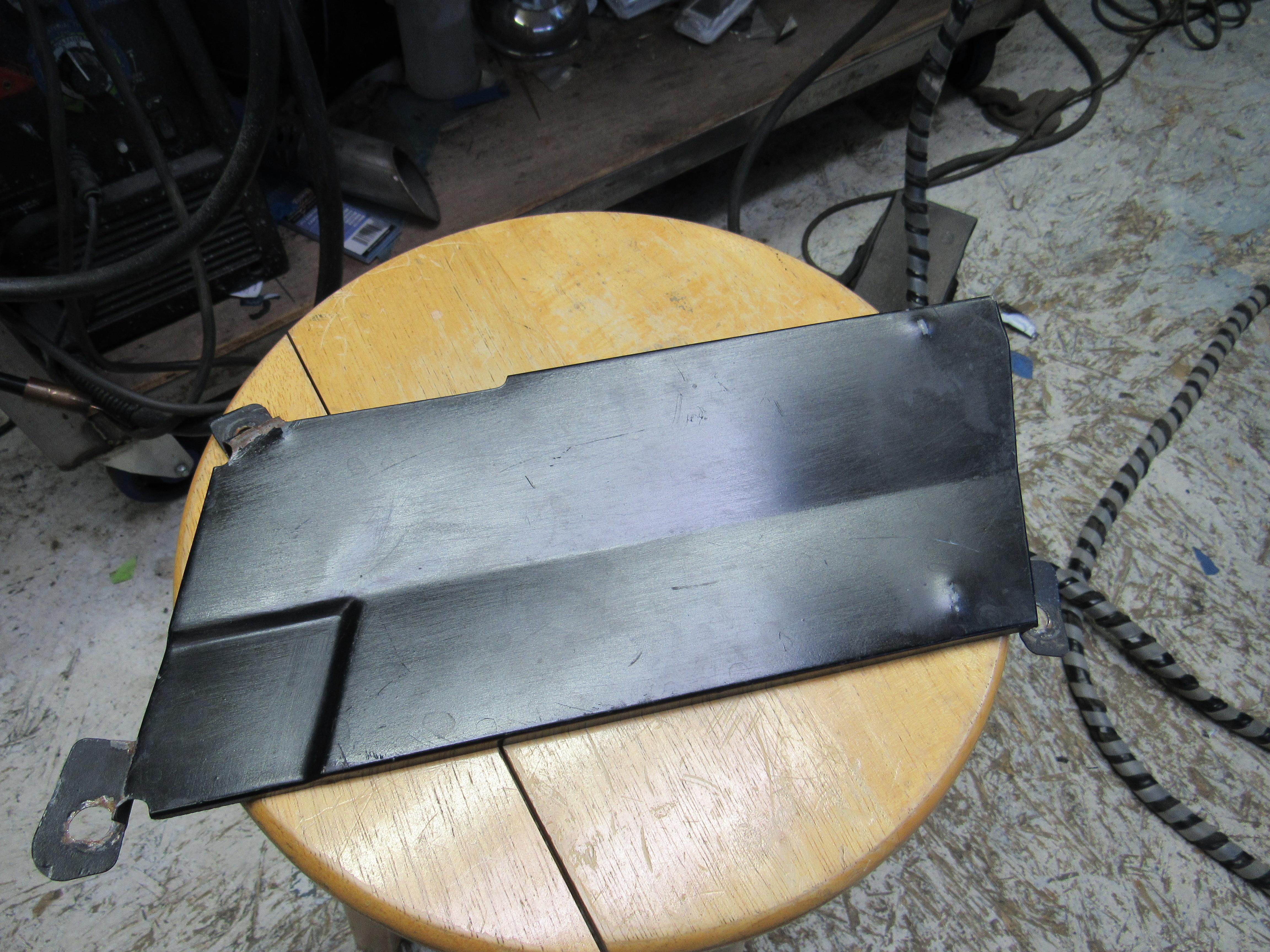

This piece was in the rear cargo area along with the easily identified parts and pieces that find their way into the cargo area of a car that had been sitting for quite some time.  The clean and paint parts process has been going on for some time now on the resurrection project.  This piece was painted the original body color and had some remnants of decals on it.  I was able to read "air filter", "oil" on the label as well as a corner of a Champion spark plug decal logo.  I cleaned the rusty portions and gave it a quick coat of rust primer.  Just trying to prep the part and put in the appropriate box for the parts and pieces that have been been completed and will be ready to install.  Thanks for all the help from the great group of Z people here, John-Lugoff, SC.

This is the drip tray which mounts under the hood and  left ( driver ) side hood vent on the 77- 78 280z vented hood.
There was never a similiar piece for the right side but one can be custom fabricated out of a left side hood vent.

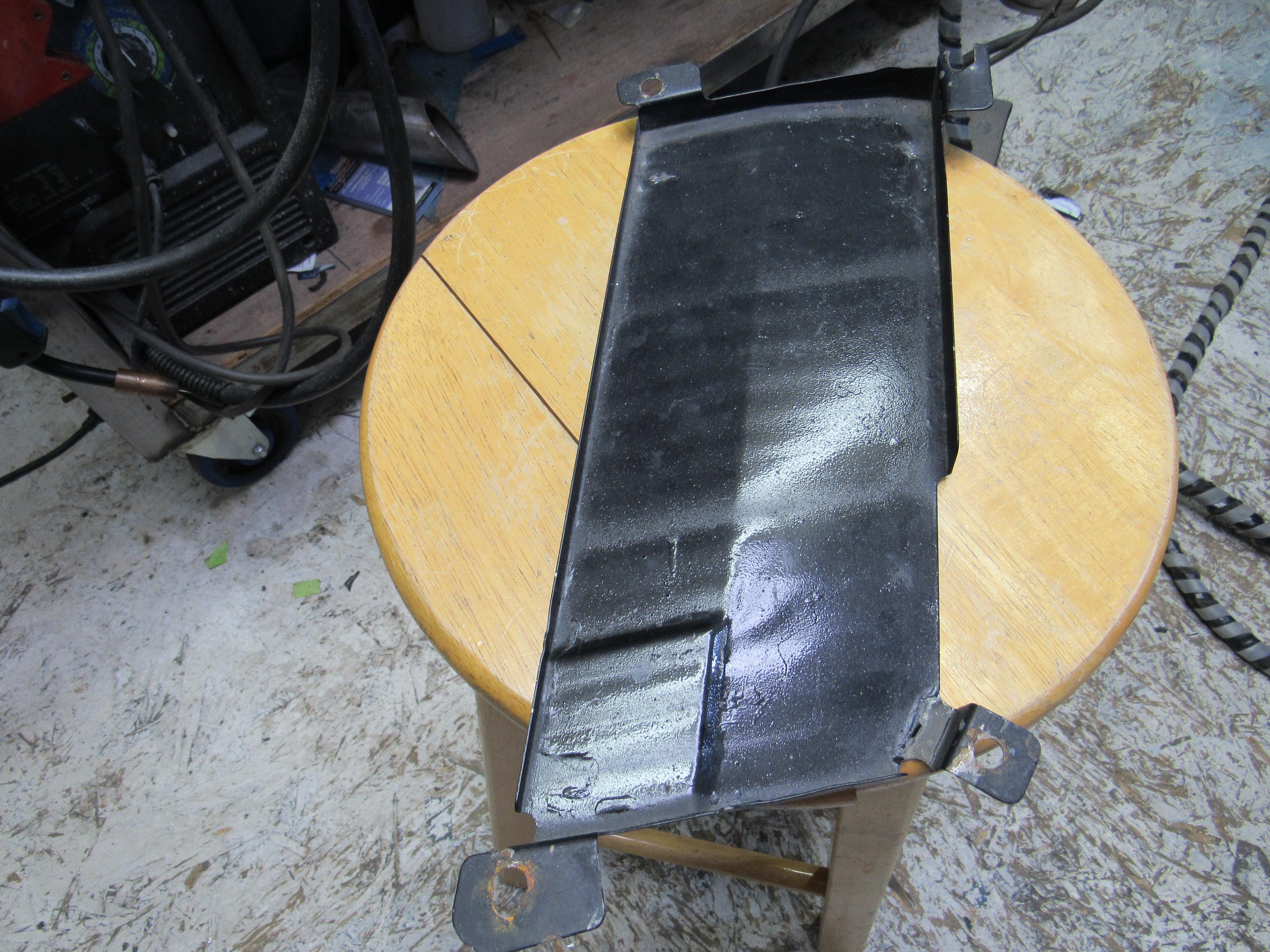

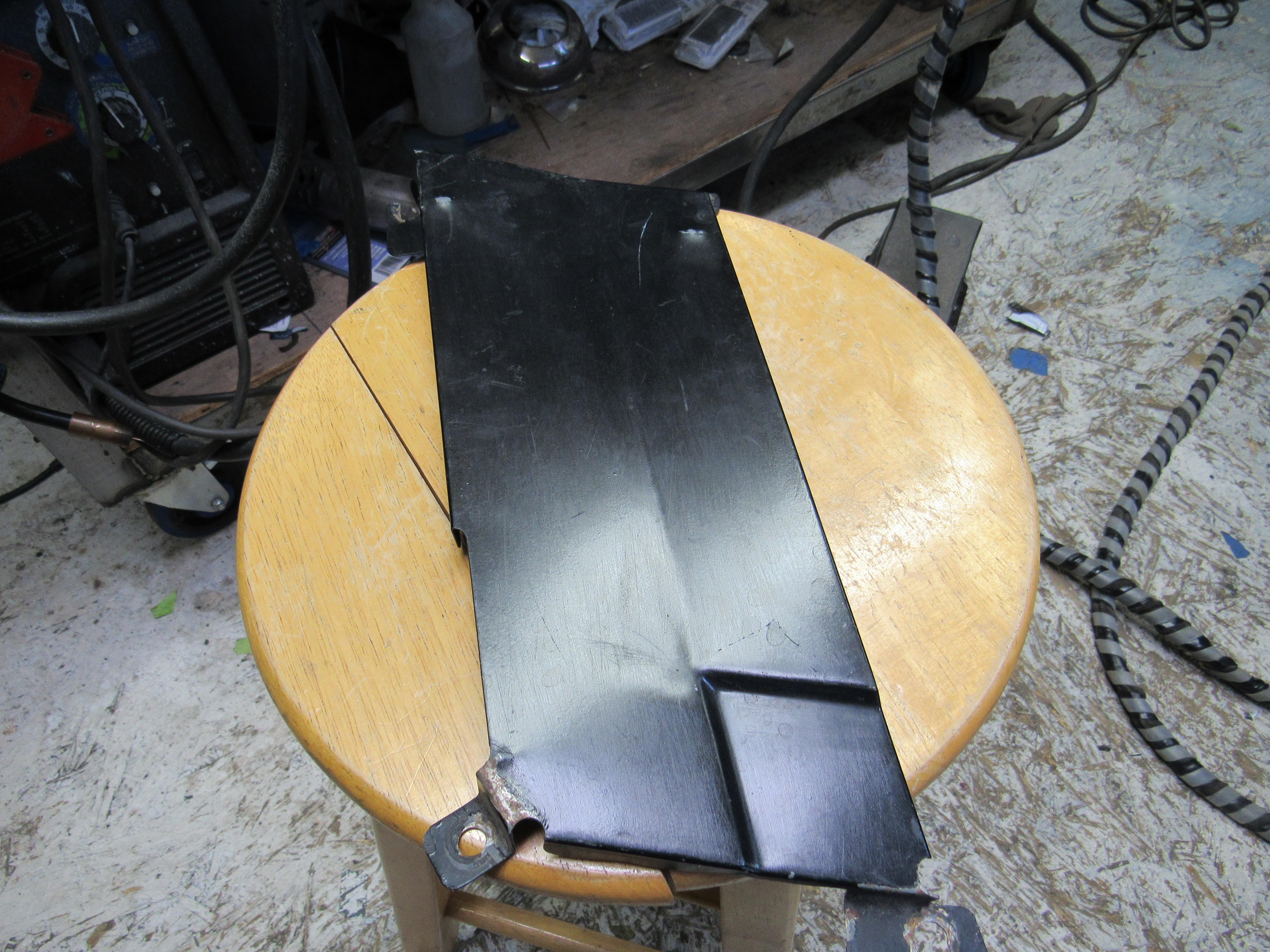

@One Way, I think I have a unicorn you might be interested in.  Back when I had my 280z it was missing the D/S hood vent drip pan so  when I was at our local Z clubs swapmeet I picked up a pan for my car.  When I got it home I could not figure out how to mount it, it wouldn't fit, it was then that I realized that some clever guy had made an identical pan for the passenger side. Here it is, it's very well done.
It is useless to me as I don't own that car anymore, it's all yours for the price of shipping.
