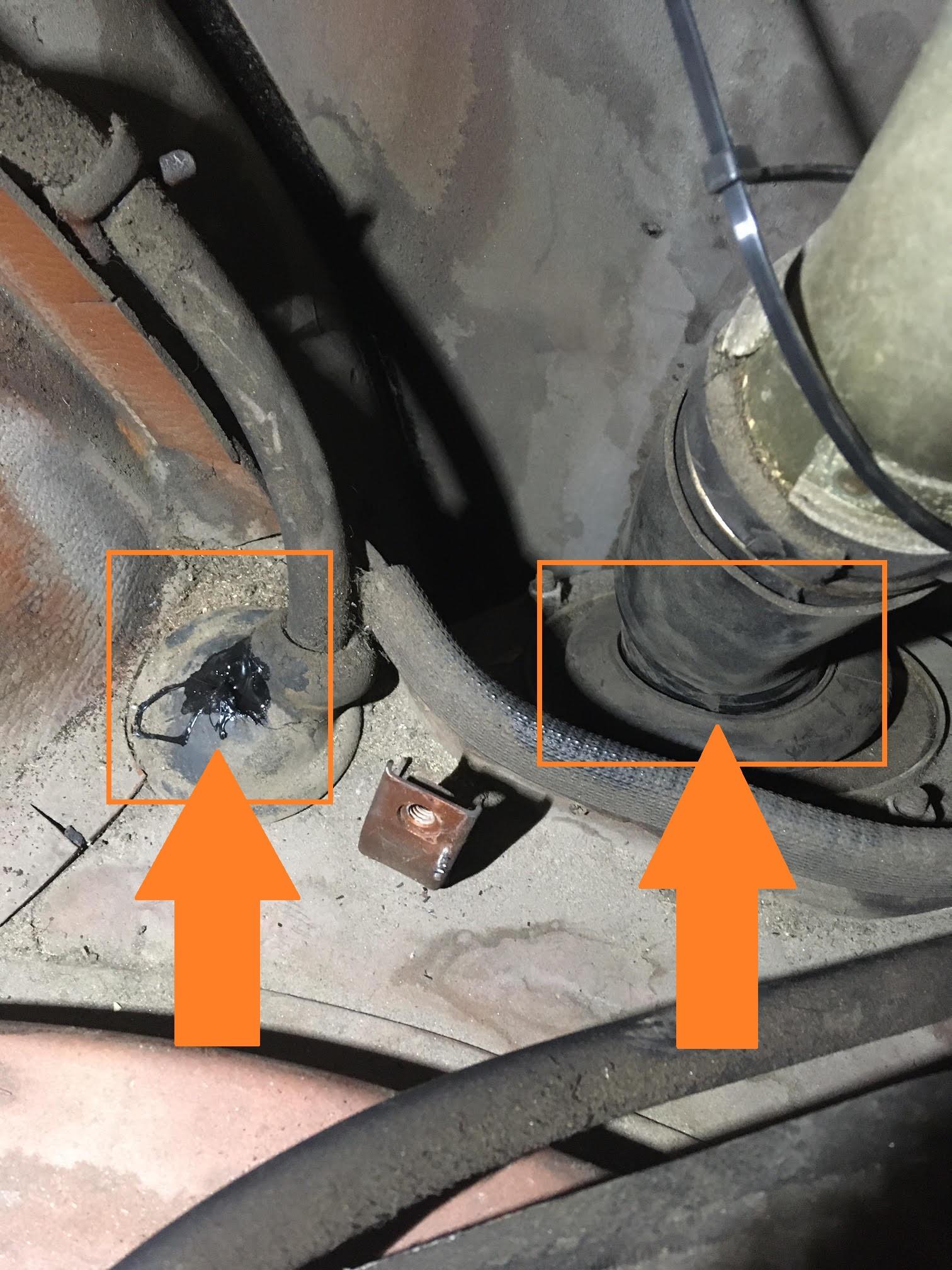

Hi guys,
Is it possible for worn/torn vapor tank floor grommets to be the culprit for exhaust fumes in the cabin?  If the holes were on the exhaust pipe side, I'd say I've finally found my leak but these hoses/grommets are on the passenger side of the car.
(Note: I have changed the inner/outer hatch gasket, glass seal, taillight gaskets, sealed the hatch's vinyl panel, and sealed the hatch grommets)
I can also see light through the accordion-style grommet that seals the fuel filler hose to the car but obviously can't glue that shut like the other I found - is that accordion bit replaceable?

Ok guys so I found them and here's the list:
  • definitive:
    • vapor tank vacuum line grommet had a huge hole
    • vapor tank hose floor grommet was cracked
    • a bunch of cracks on the fuel filler hose body mount mating area
    • cracked body seam sealer near rear wheel well
  • possible:
    • antenna to body rubber - exhaust get in here?
    • antenna drain plug missing - are these available anywhere?
      • I've taped this shut a few times but it didn't really help
