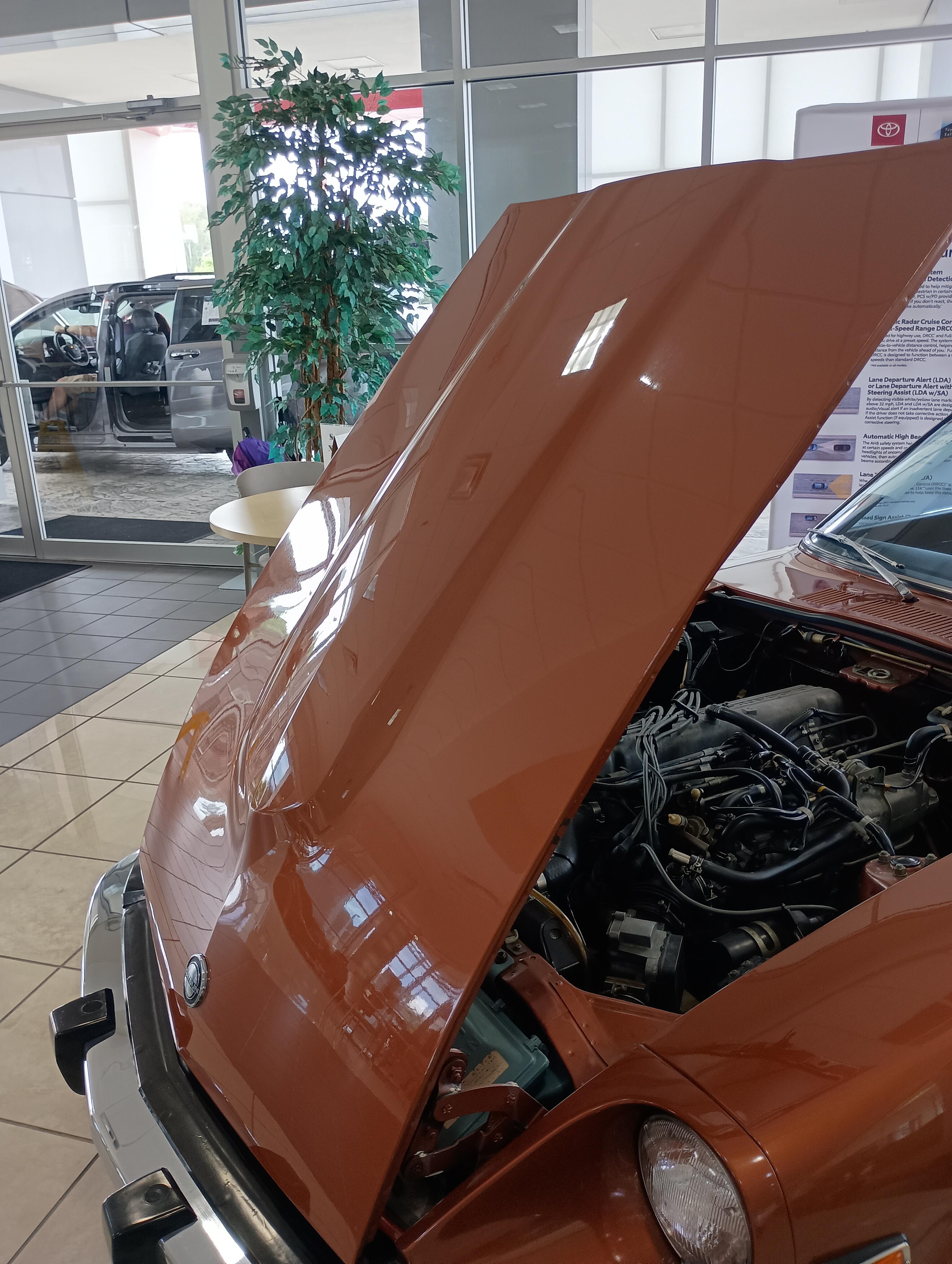

7 minutes ago, Captain Obvious said:

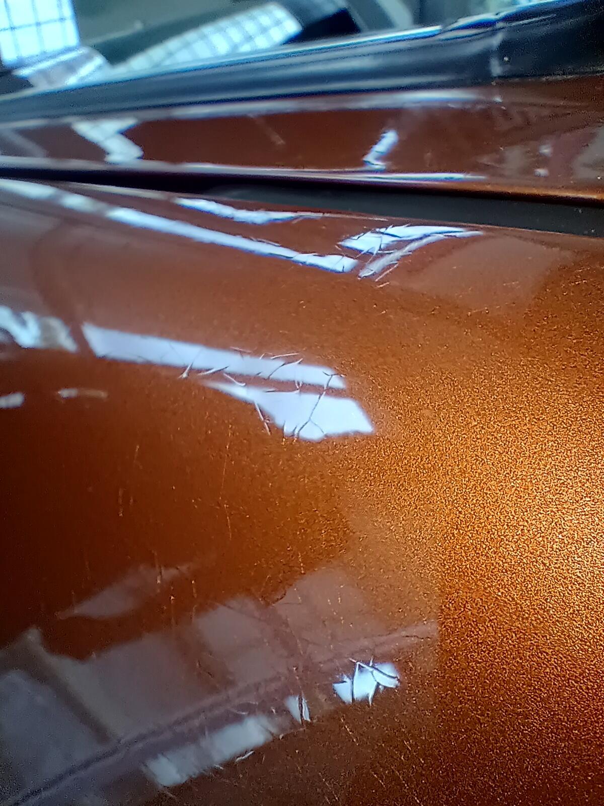

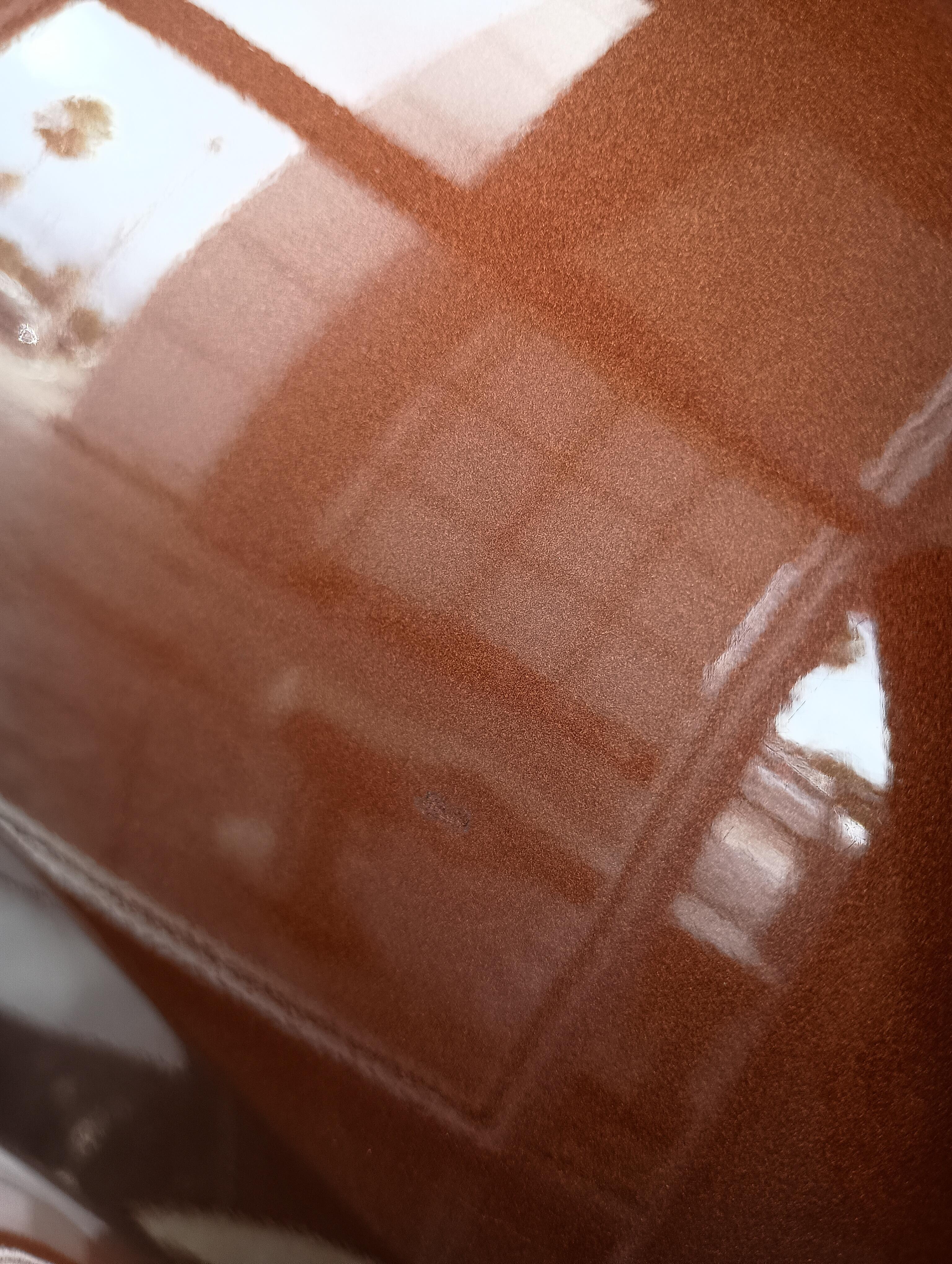

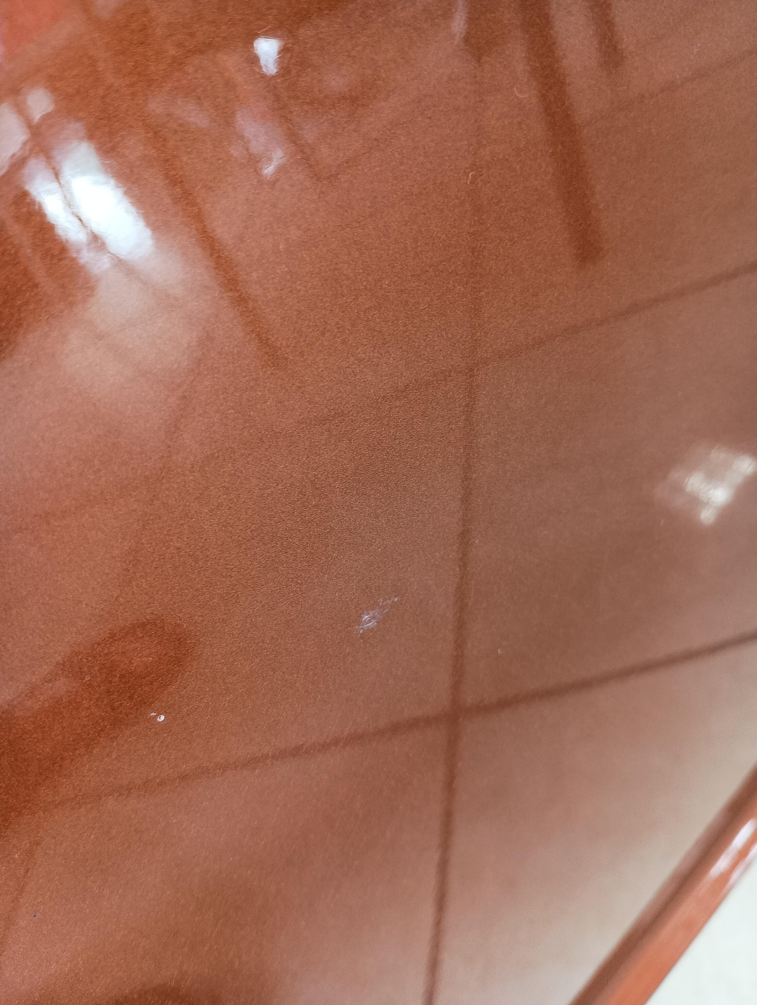

It's really hard to gauge paint in pics like that, but it looks like there is too much orange peel, and it looks "deeper". Like base/clear instead of the original single stage. Hard to judge.
And the rear tail light panel is the wrong color. Way too light. I'm thinking they painted that panel maybe at the same time they painted the rest of the car?
Wait...  Were the 2+2 rear tail light panels a different color than the coupes?
Don't get me wrong. It's a beautiful car. I'm just curious what "all original" means these days.
I'm pretty certain its single stage. If you've ever seen the really fine checking that happens to it, this is what's going on. Zero orange peel.

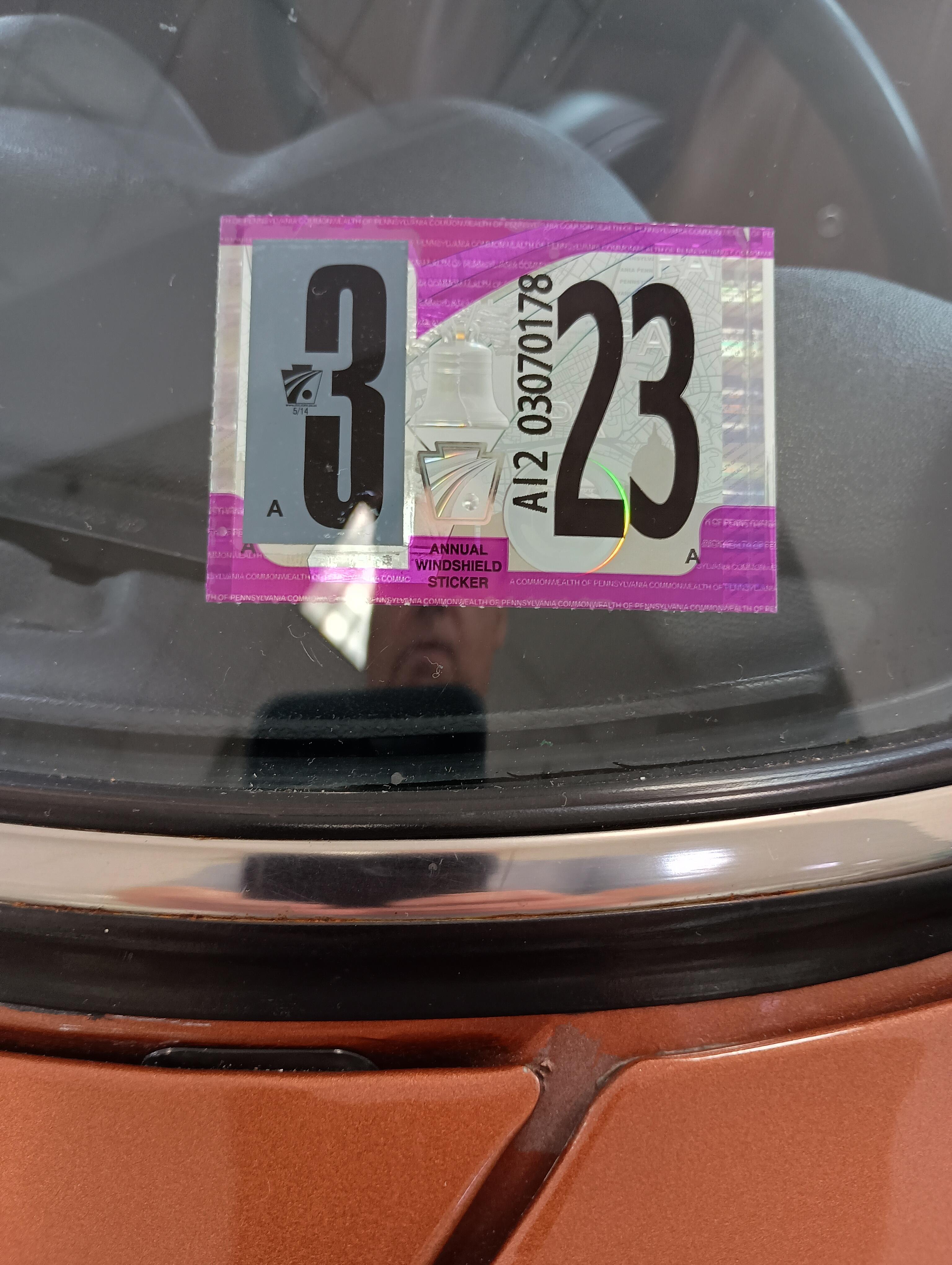

I think the outside lacquer is much newer than the inside lacquer, don't forget next year that paintjob would be 50! years old..  If you zoom in on the split just under the window sticker saying: 3-23 you see some small spot with the old paint that has faded
