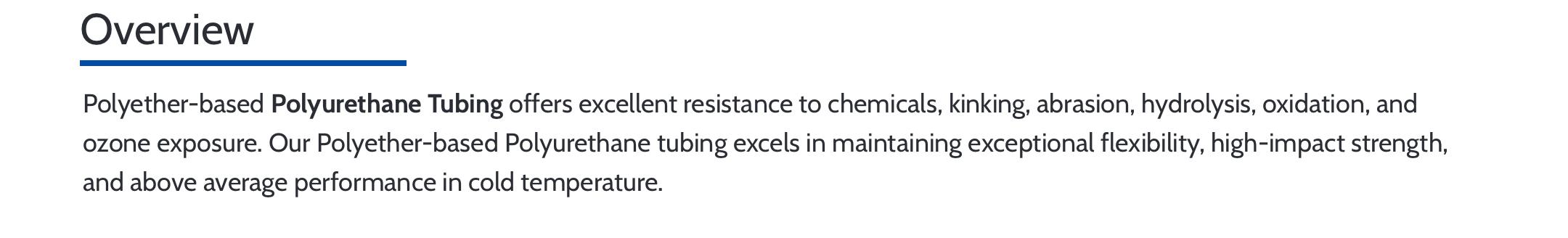

Been studying fuel tubing. Seems Viton tubing is getting the nod. One description.
https://www.new-line.com/hose/tubing/viton-tubing/viton-rubber-tubing
