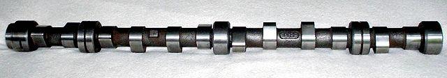

Cams are tough.  Scotchbrite pad, any oil, and some elbow grease.
Before
After
For the rockers, put some 600 grit sand paper on a marble/stone cutting board (TJ Macs kitchen area)  then pull and roll the rocker surface towards you. Water or oil on the paper helps.
Pitting in the surface is OK.
Thank you for the encouraging response. The good news is that my cam is not nearly as bad as yours was.  The bad news is that I am not sure my elbow has enough grease.  That clean up process will be quite the tedious task but certainly worth tackling.  My rocker arm concern actually centers on the rocker arm itself, specifically the small contact end lobe at the valve stem contact area.  Several are pitted and all 12 do have a slight wear groove.  Thanks again, John-Lugoff, SC.

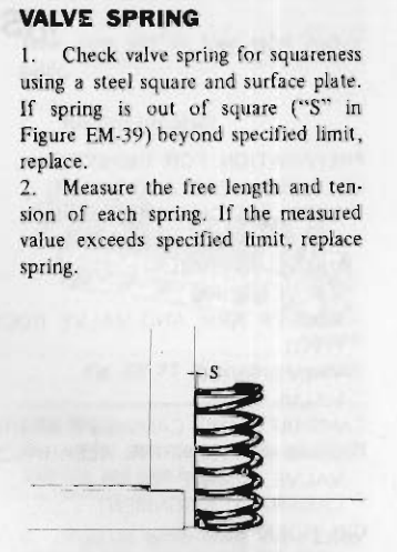

VALVE SPRING FREE HEIGHT-The specs I found call for 1.968 outer spring and 1.766 inner spring. I am having trouble navigating our computer to get the FSM to display on the screen so those specs may or may not be accurate.  The springs are now all cleaned and am getting exact same measurements on all 12 springs.  1.920 outer-short by .048  1.695 inner-short by .071.  How critical is the free height?  Is the consistency in the measurements a good enough reason to reuse the springs on this budget conscious resurrection.  Thanks for the input.  The parts are all cleaning up nicely as I slowly continue the project in my limited spare time.  Although 2020 has been a tough year for all, we still have plenty to be thankful to the LORD for getting us through so far.  Thanks again, John-Lugoff, SC.

Here is the spec illustration from the 78 FSM.  The 49.98 converts to 1.9678.  You're saying that all of your springs are equally too short.
Since the springs are compressed at all times I don't think that free height is critical.  It could only affect preload, but would not affect spring rate.  I'd use them if I was on a budget, but that's me.  Not an engine expert.
Thanks for the quick response.  Computer dummy that I am always struggles getting the downloaded files viewable and my wonderful wife is not around to help and belittle me.  My trusty Haynes manual had the same specs.  I was encouraged by the consistent measurements but I am no engine expert either but Zed Head has probably forgotten more than I will ever know about these Z cars.  Thanks for the helpful tips as always.  The camshaft cleaning is underway.  Thanks again, John-Lugoff, SC.
I got curious so browsed around and found this in the inspection area of the chapter.  It says measure length and tension, and says that "out of spec" is if the number is exceeded.  Typical unclear instructions though, they combined both and didn't specify a tolerance.
