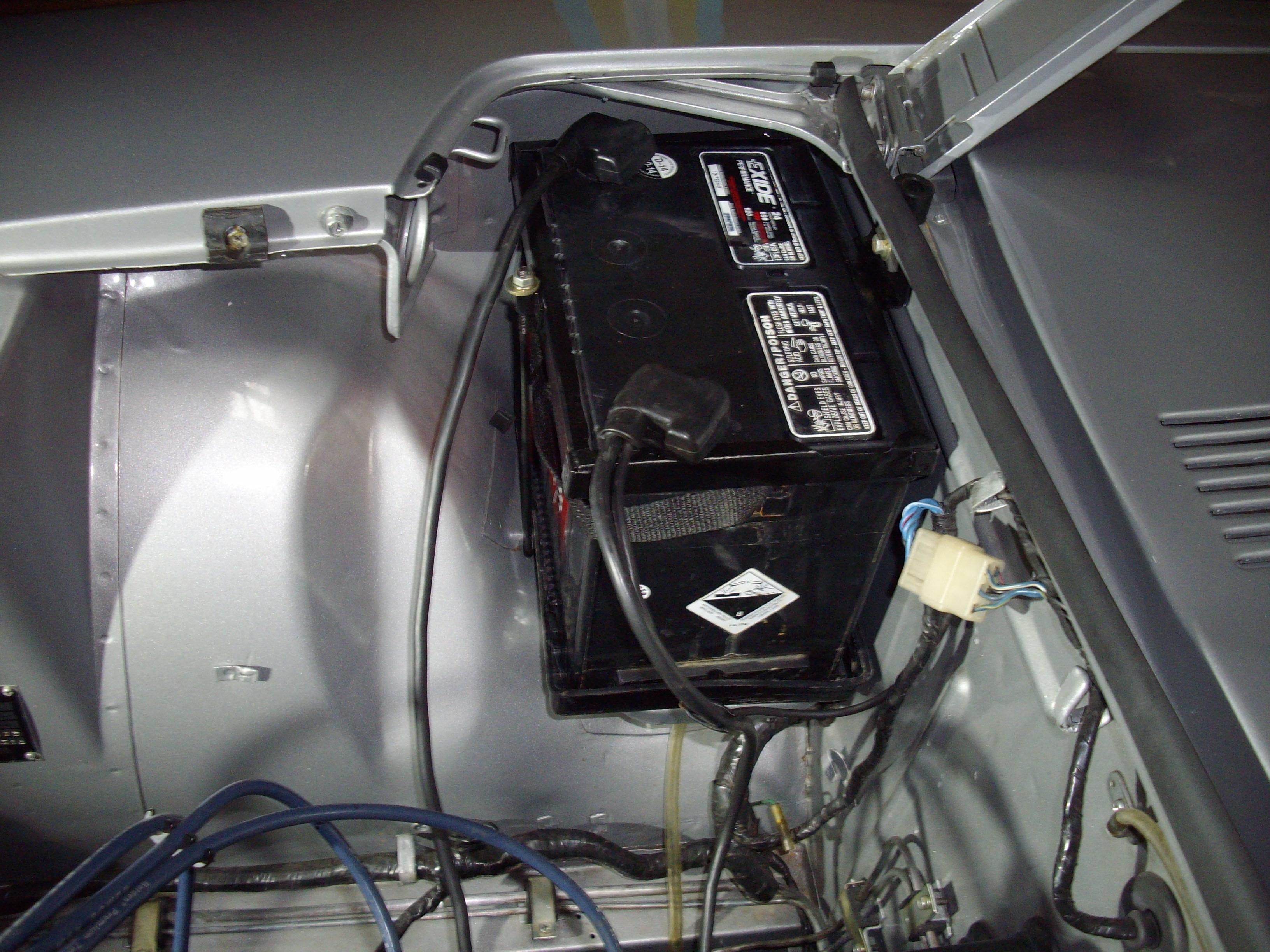

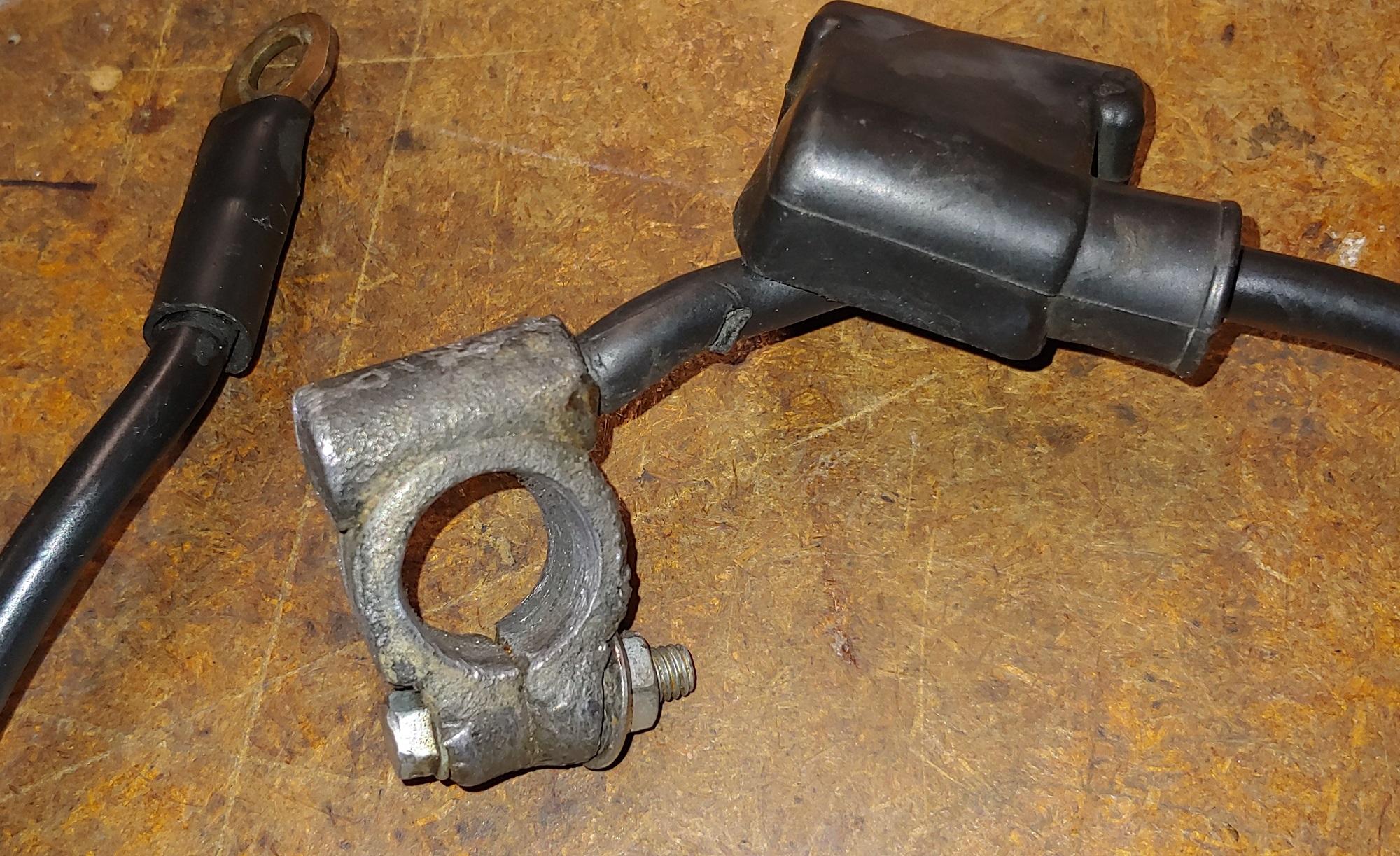

I'm looking for a picture of the original/factory battery cables + and -) for the 240Z.
I tried to find this information on internet but every cars i found have different cables...
Also, cables are the same for all years, or they are different between series ?
Thank you for your help.

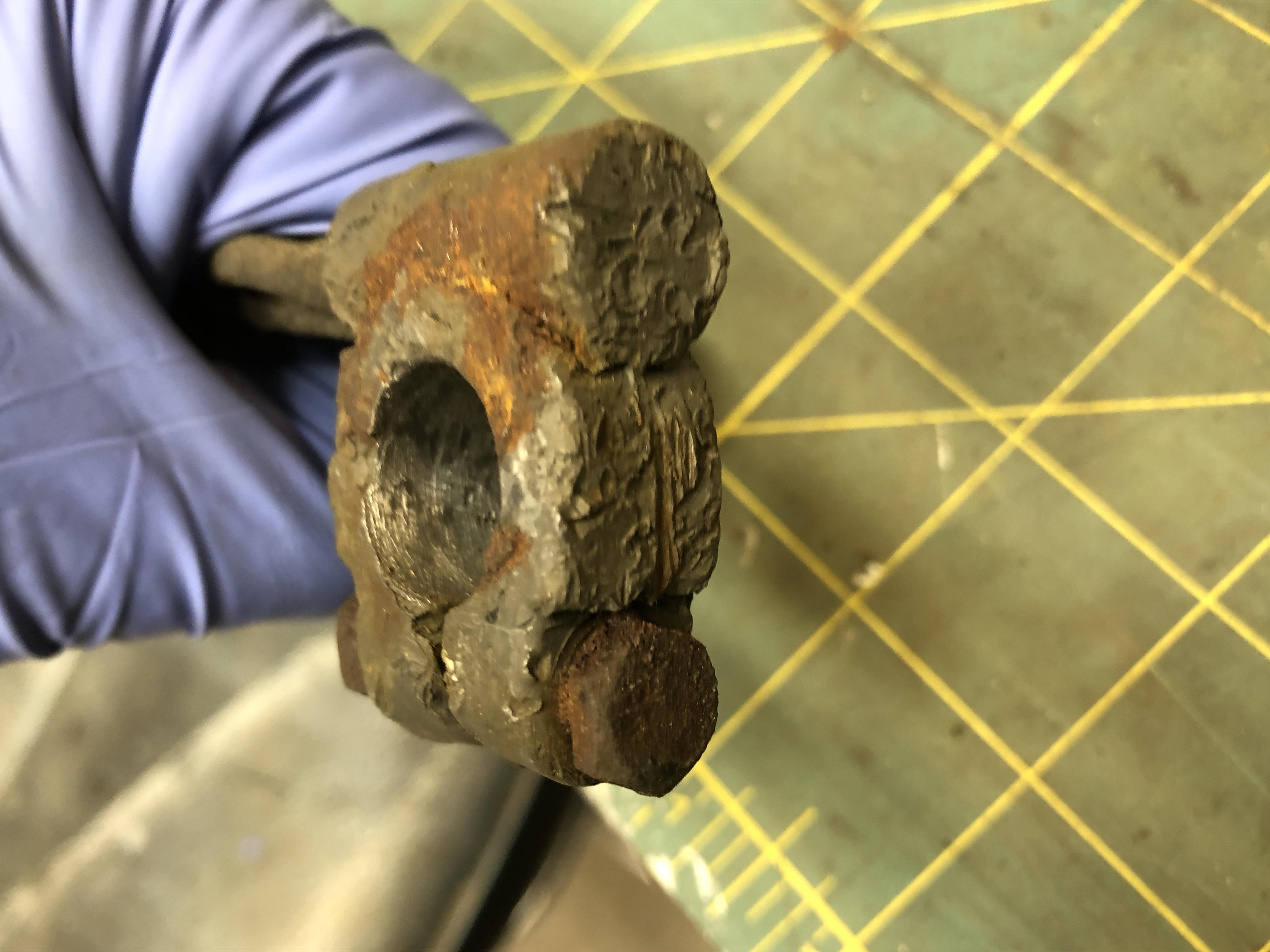

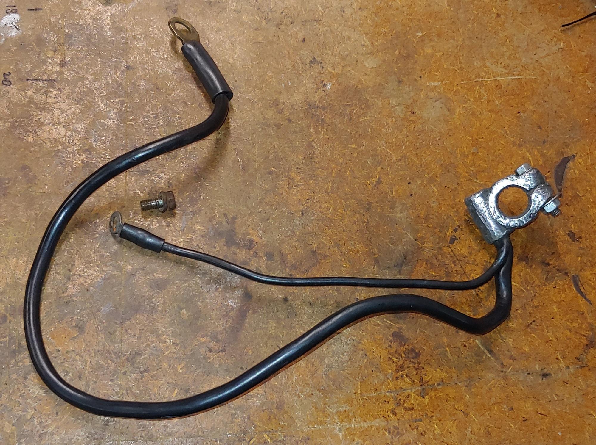

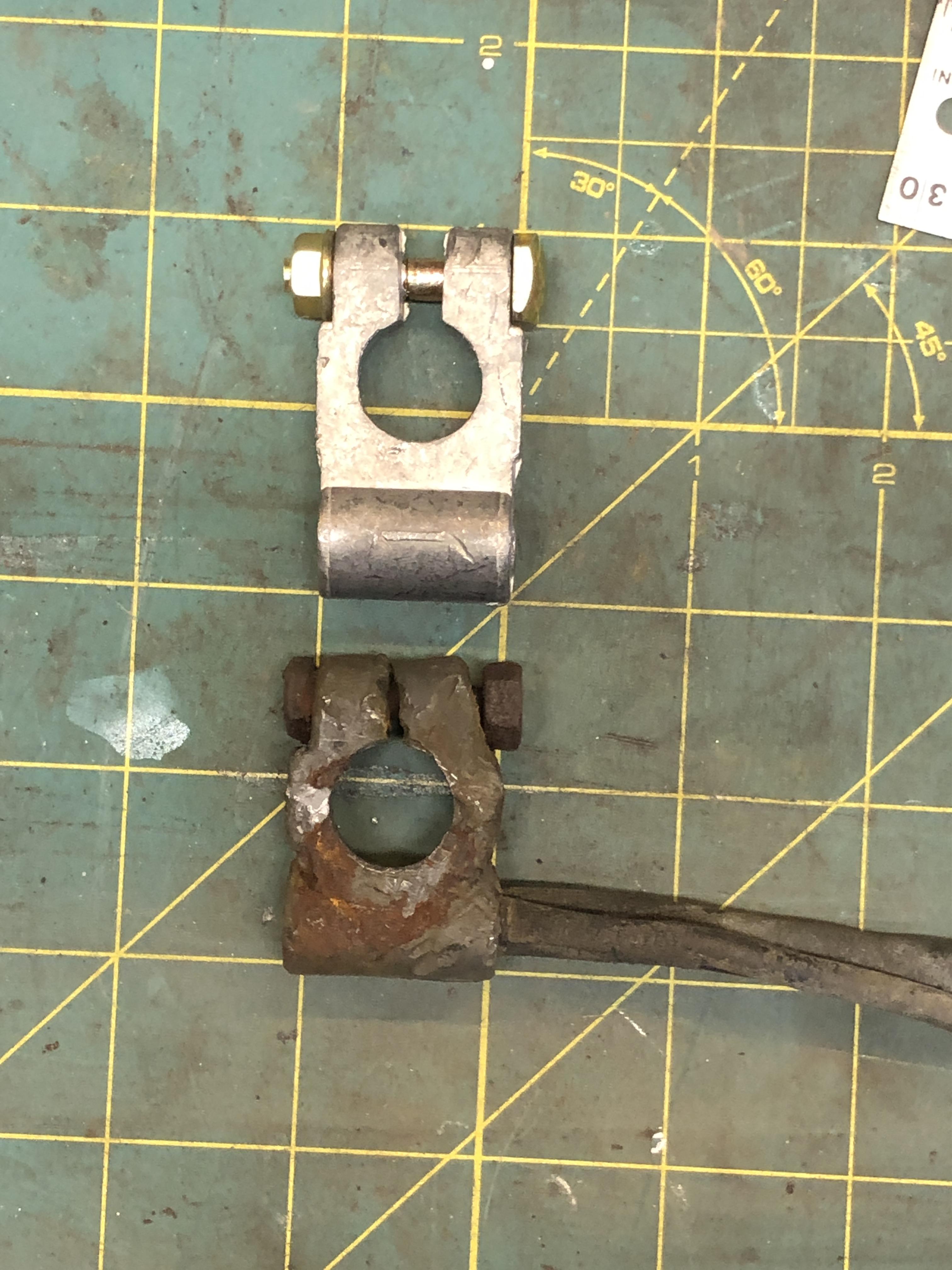

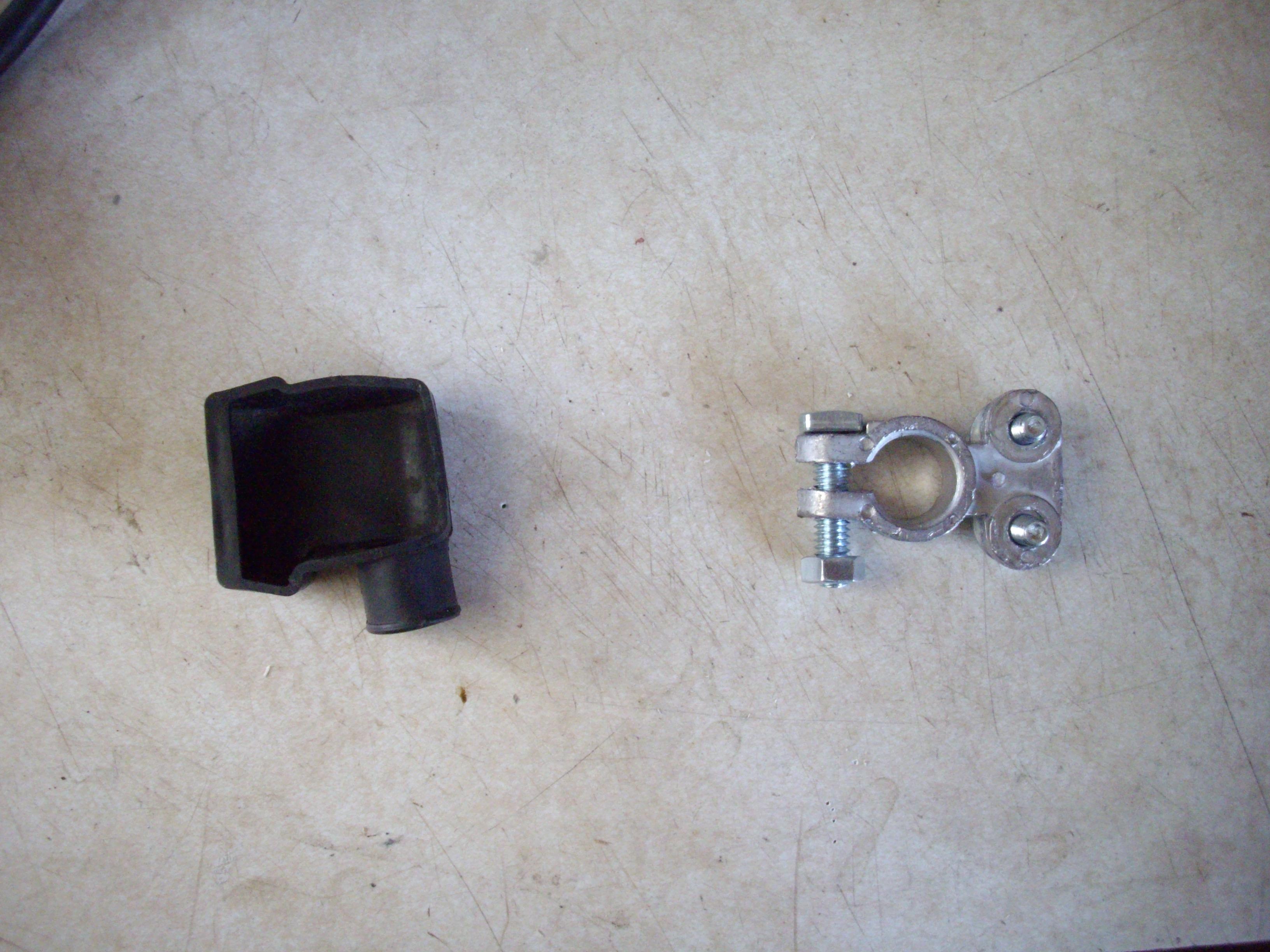

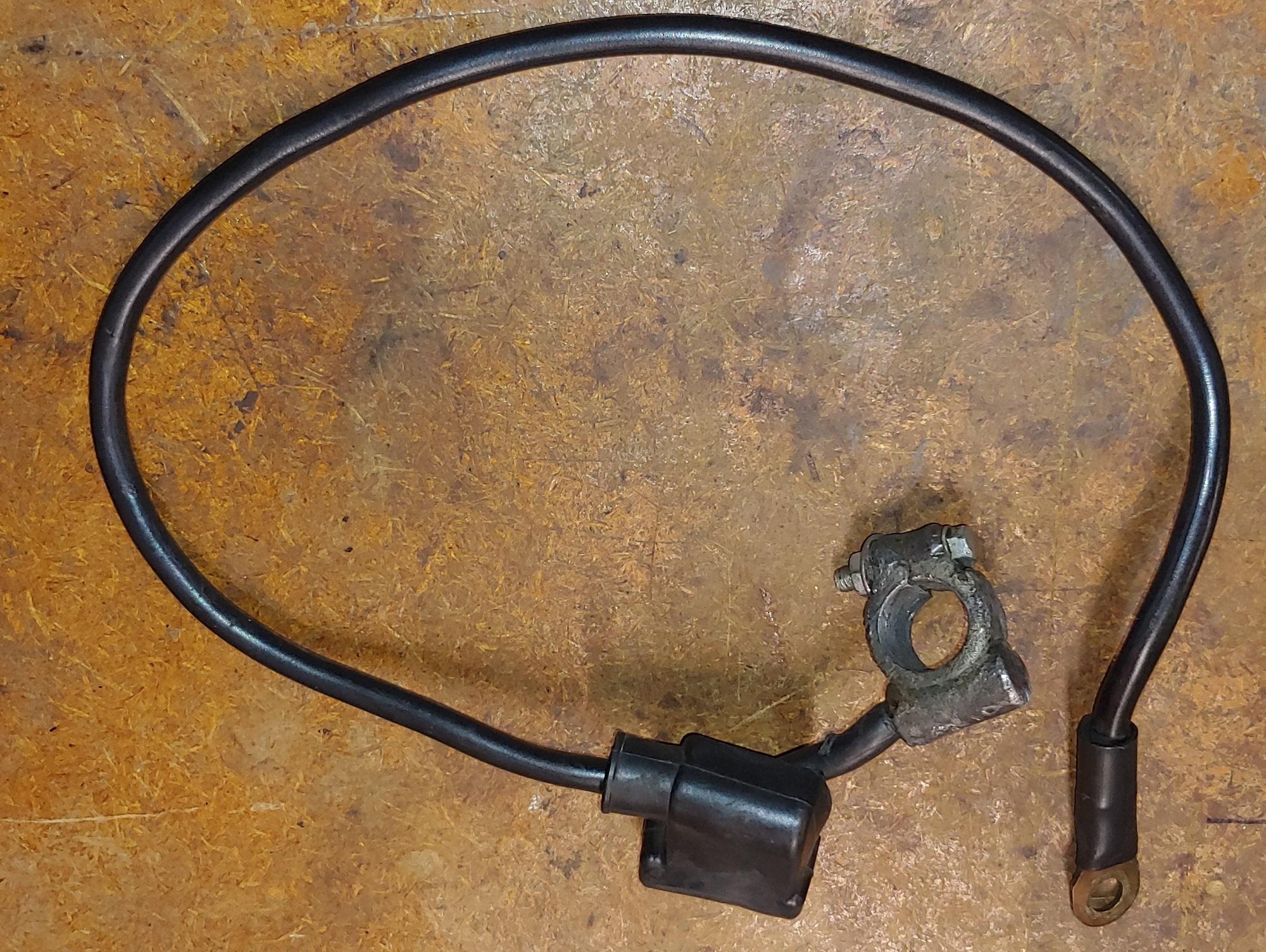

8 hours ago, 240dkw said:

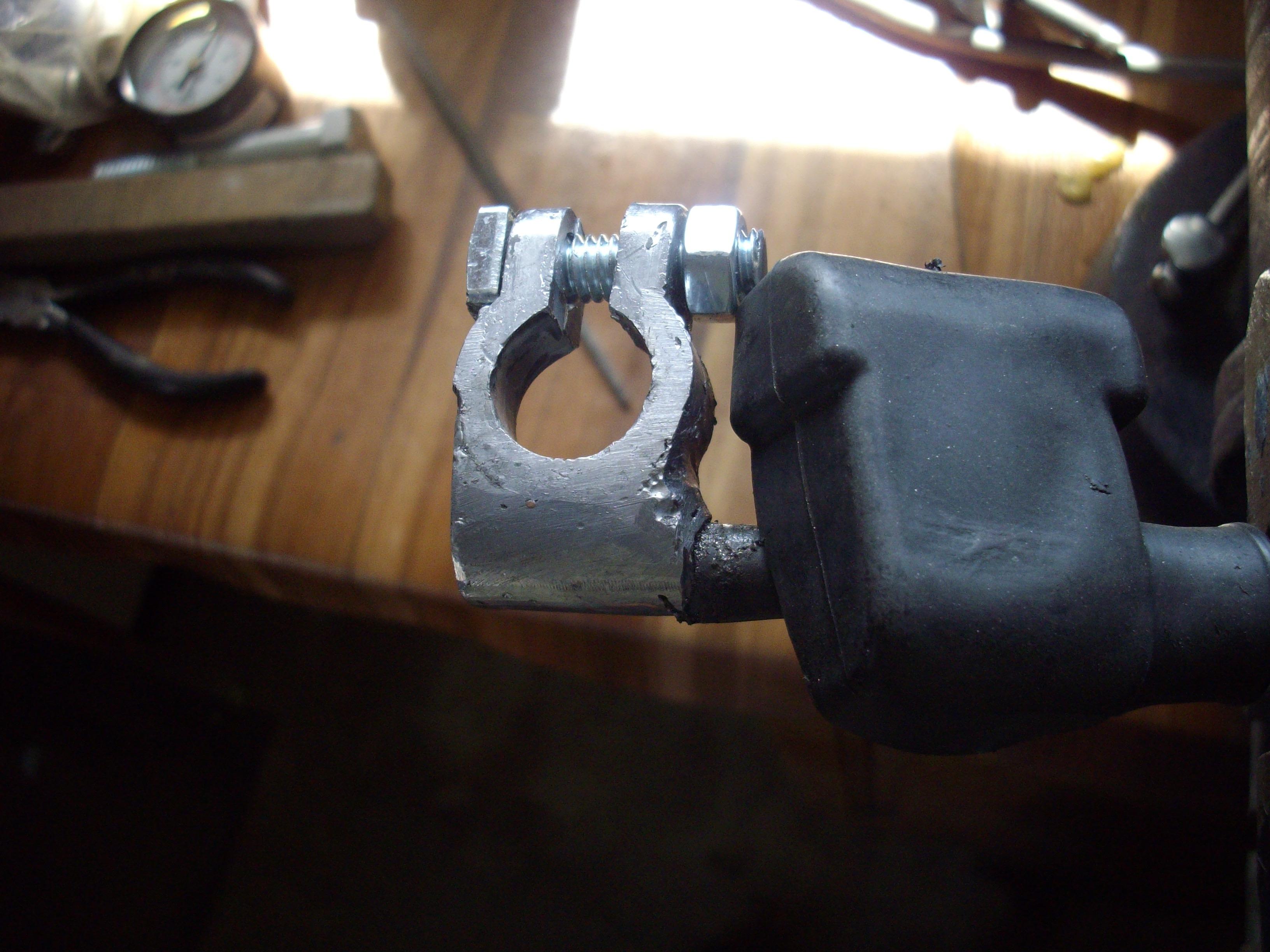

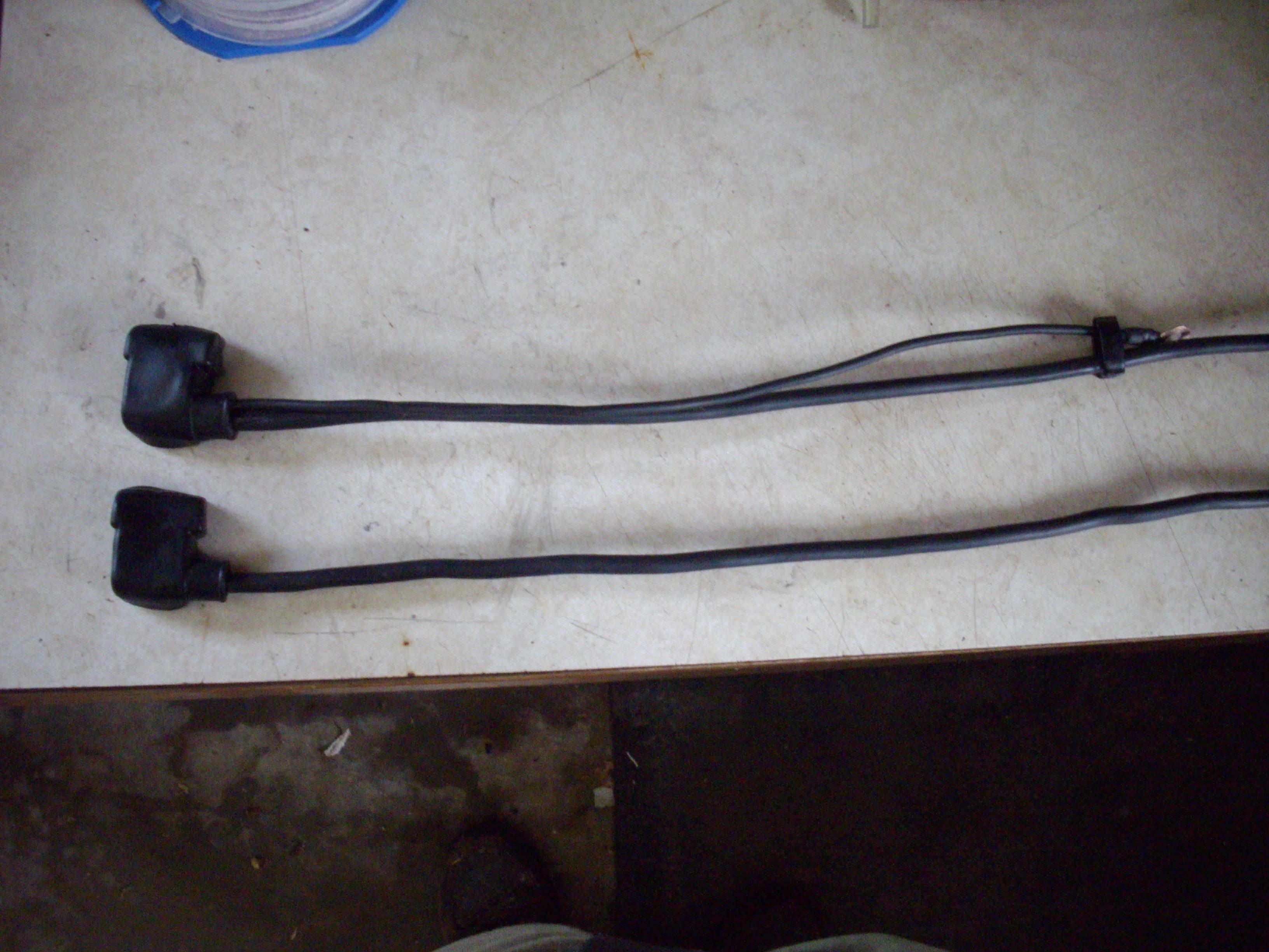

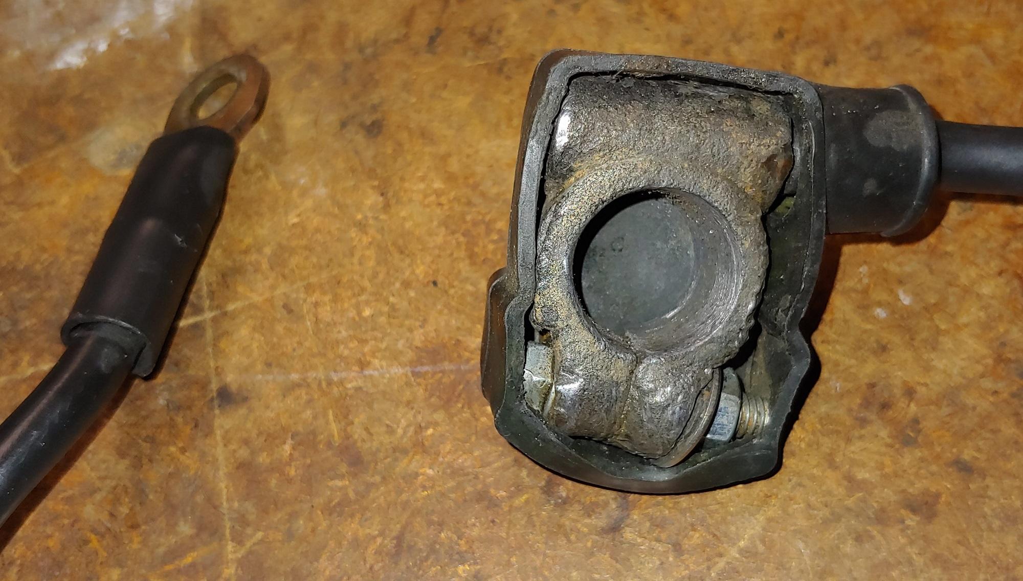

I had a set of cables that the "blobs" were still on, but the ends were replaced with straight generic ones. This is what I did to make them more right(er). I used the covers as a mold.
That is really interesting, great idea!

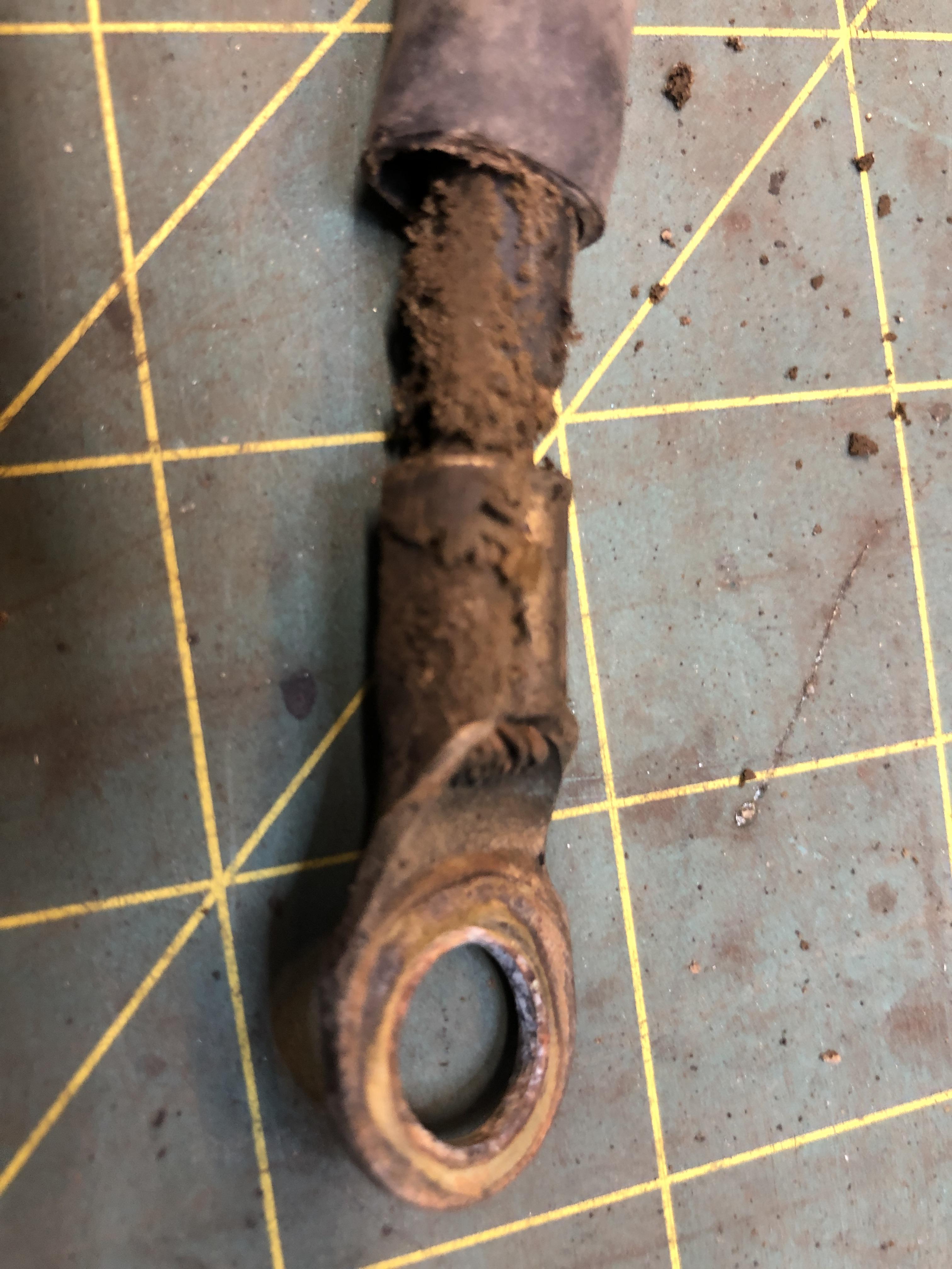

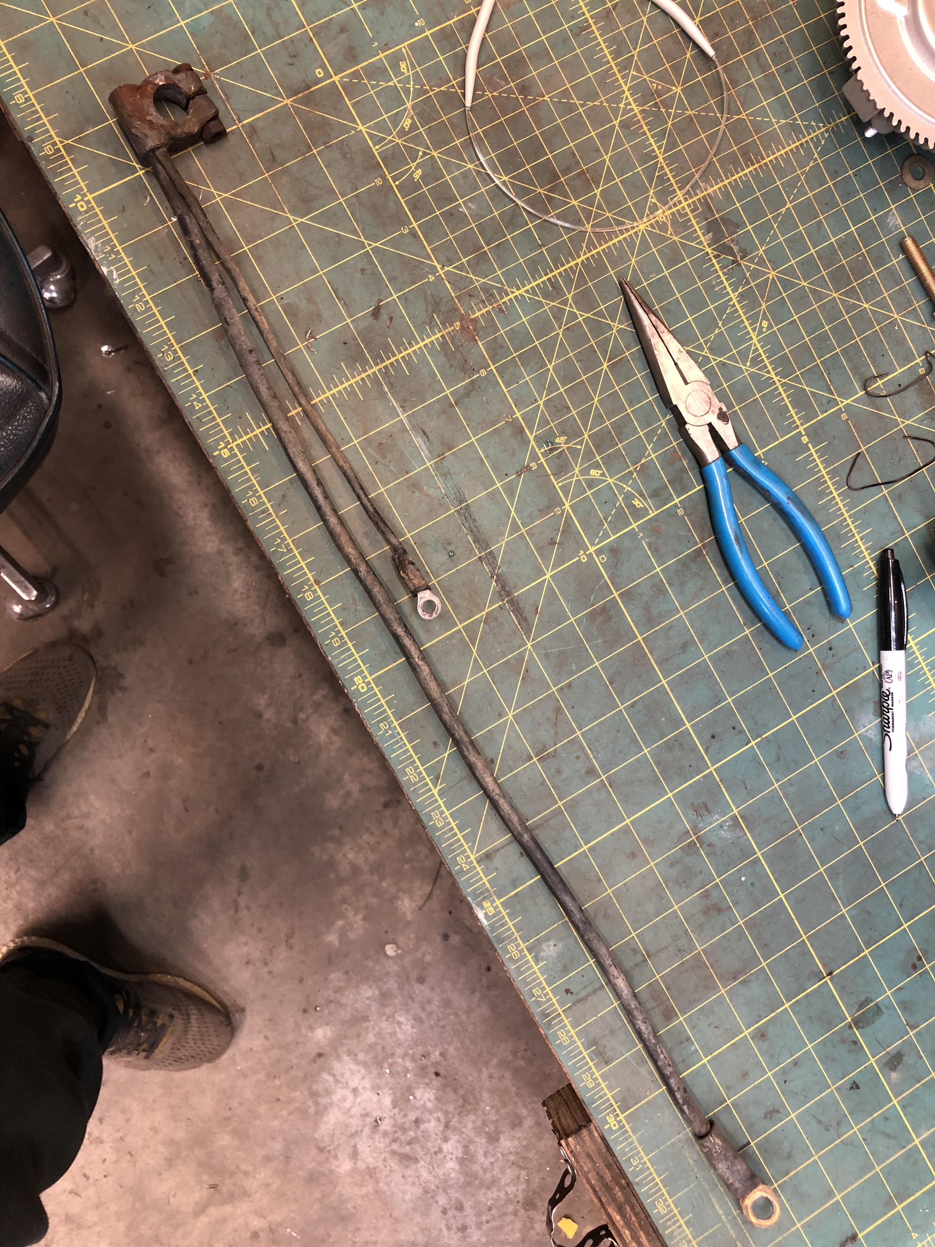

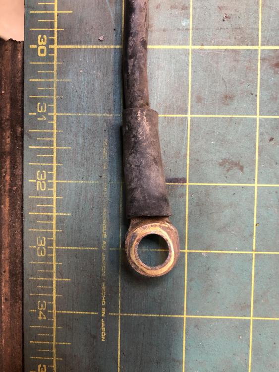

I realized I have one good original negative cable on the new to me 71 I just picked up.
Now “we” need one of those original blobs to use to make reproduction blobs....

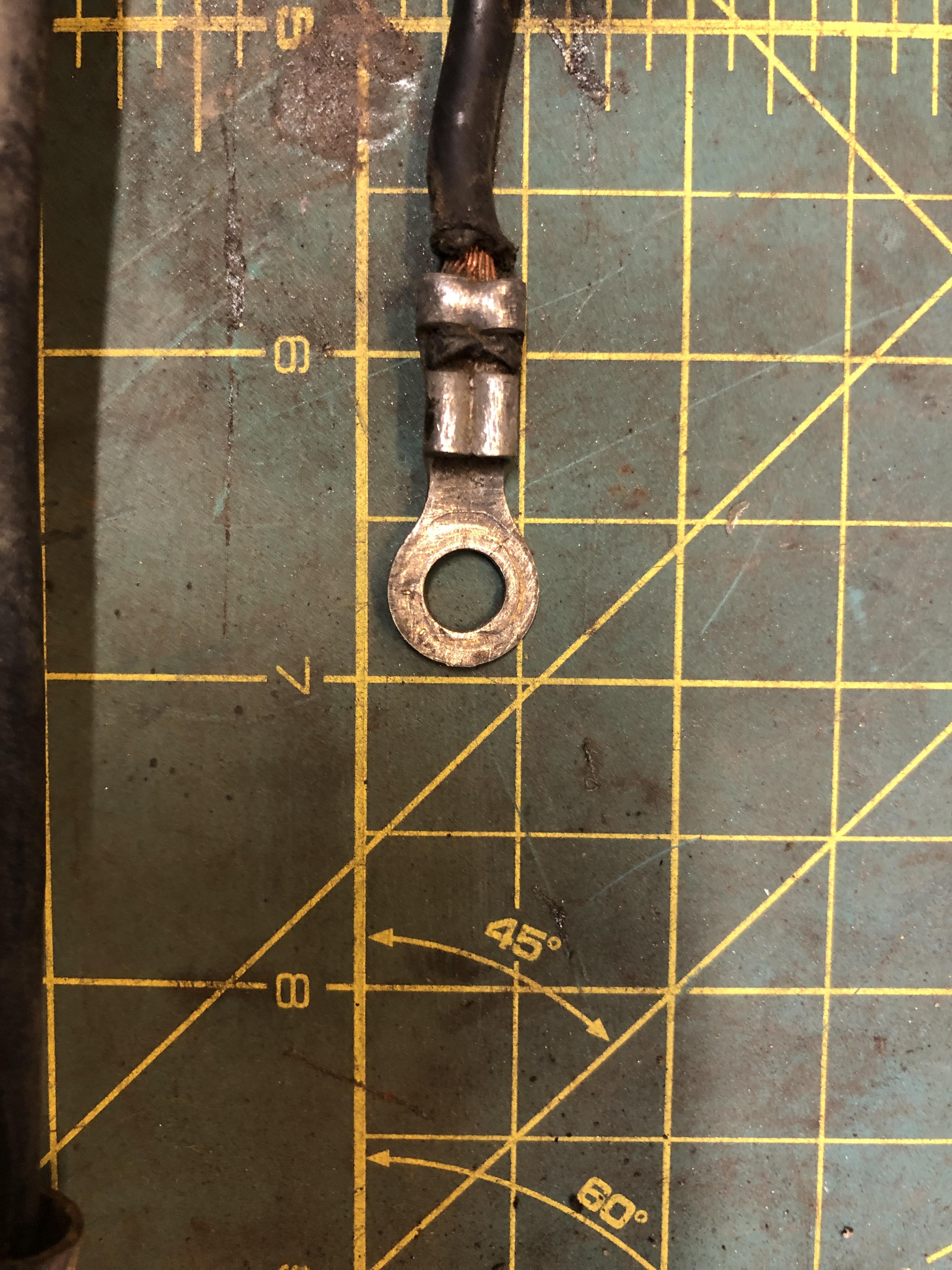

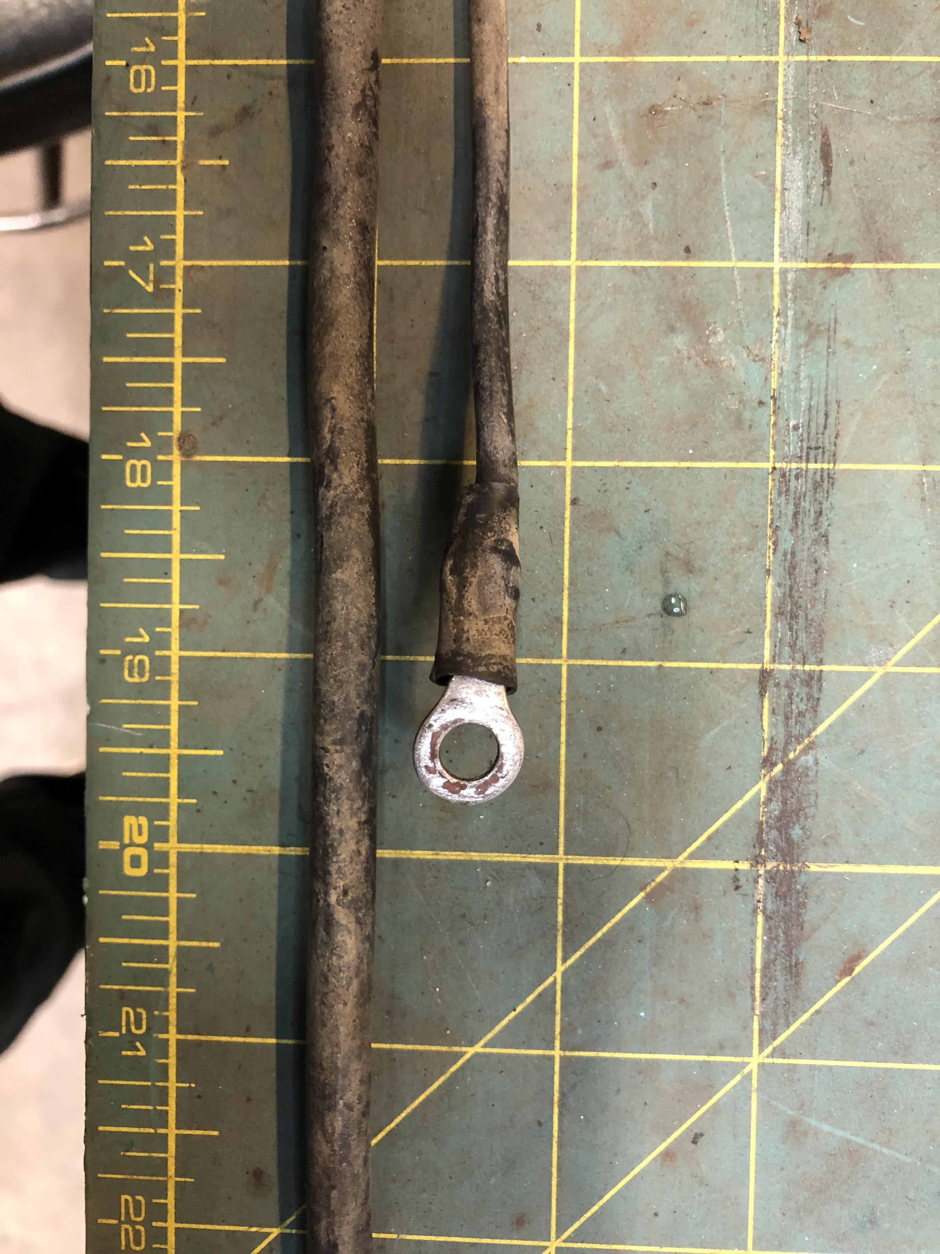

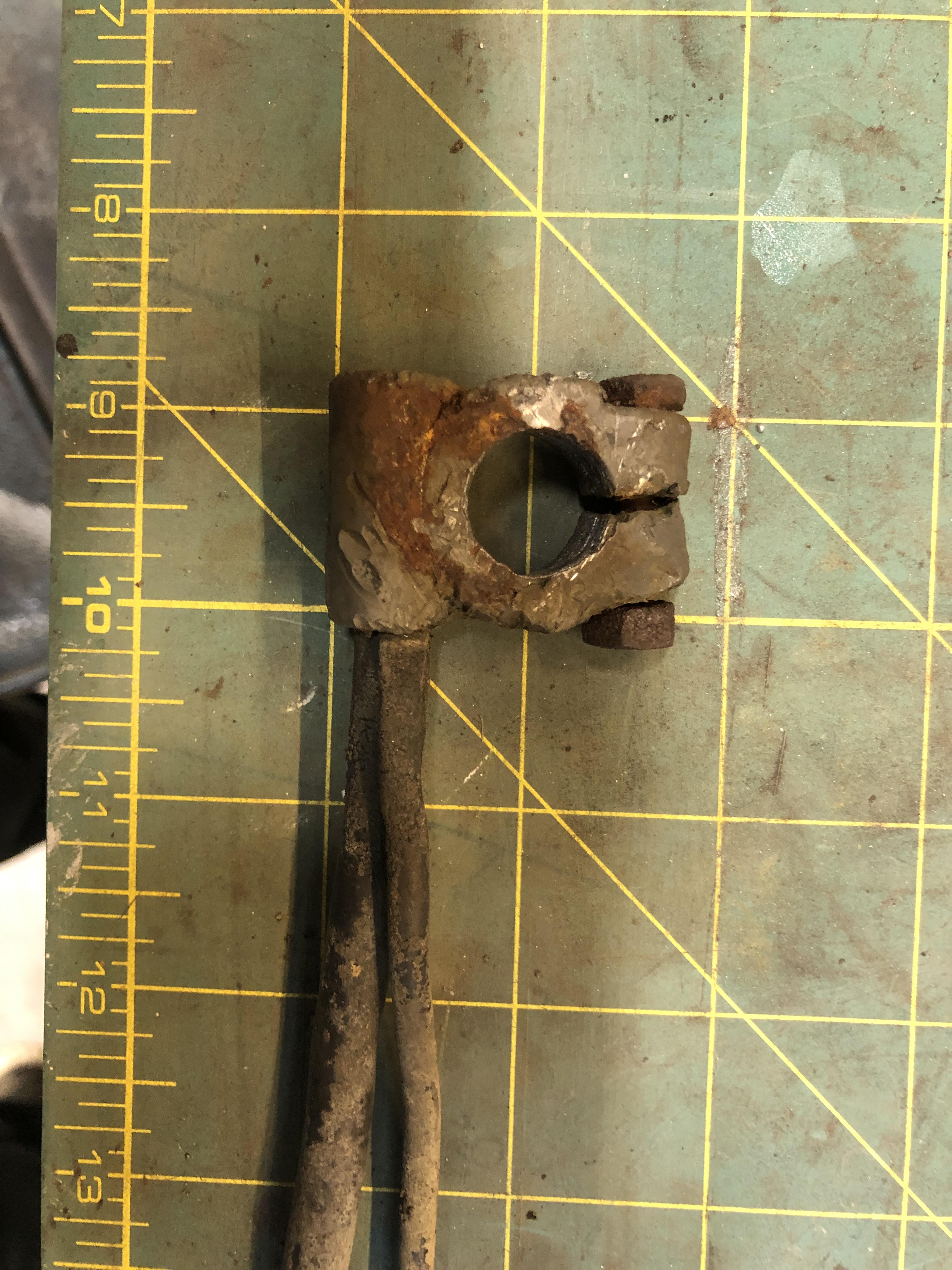

I’ve taken detailed measurements of the cable, lugs, wires etc. Finding the very heavy lugs that Nissan used is going to be a challenge in todays cheap crap marketplace. The big cable lug is a brass or copper monster made with 2mm thick metal and has a lovely crimped connection done with a serious tool.
