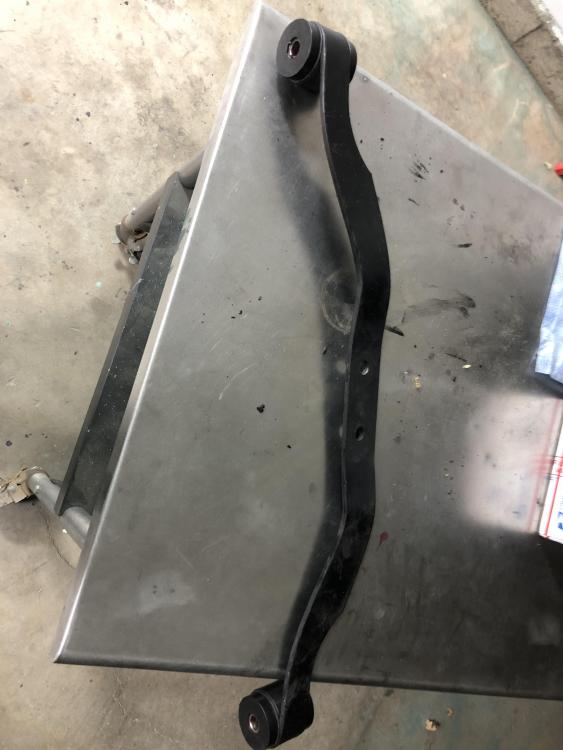

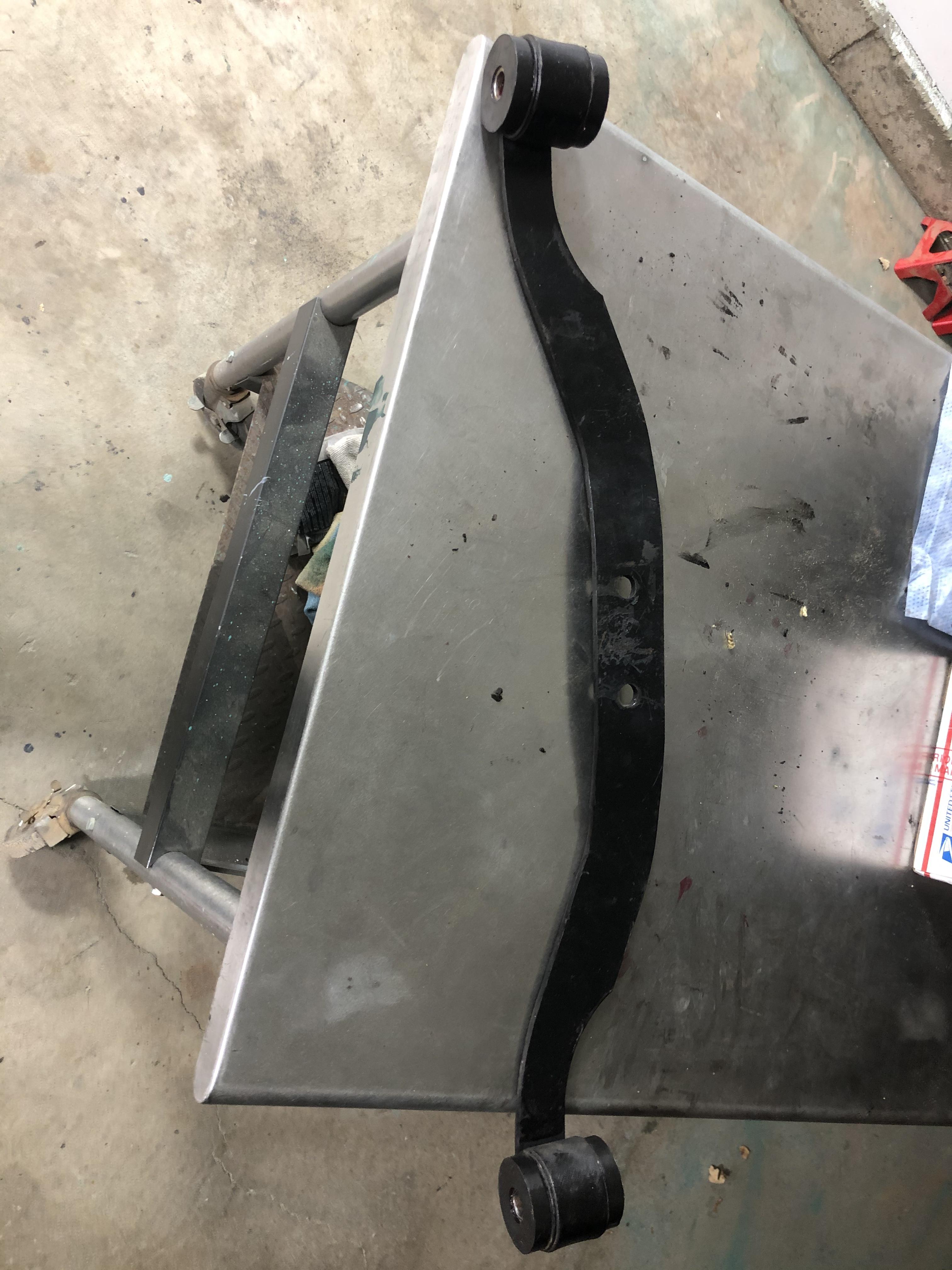

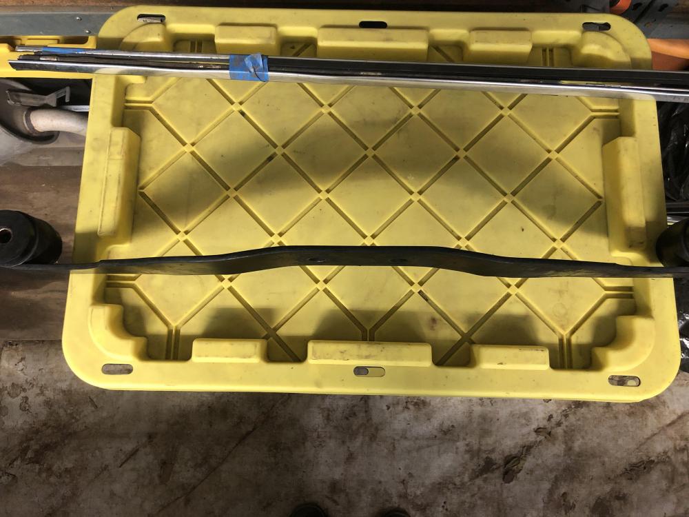

Quick question. I have a mustache bar that I believe to be for an r200. My car doesn’t have an r200, i have no need for this bar at this time, but I do want the new bushings that this bar has and I’m pretty sure that their the two piece style so they should be able to be pulled out. So the question is, is the diameter of the bushing slot the same as the bar in my stock 260z? (r180)
I think they’re the same, I’d just like to confirm before I take the rear end apart (again) that I will be able to put these bushings in the 260z mustache bar.

They will fit, but you may want to consider the pros and cons first. If you change to these PU bushing the diff noise will be more noticable in the car. It will also transfer the vibrations in the driveline tothe body a lot more.
The originals are no longer available, so if they are worn and loose, you will need to replace them and these will fit fine.
If you do. Remove the old rubber by heating around the outside of the mustache bar and use a pair of vice grip to twist the centre piece of the original rubber bush. When the heat works its way through, the bush will let go and twist out. You DO NOT need to heat the bar red hot. Don't heat the centre metal tube in the rubber bush. Just keep warming the outside while twisting until the bush lets go of the outer housing. If you do it this way you will have minimum toxic fumes.

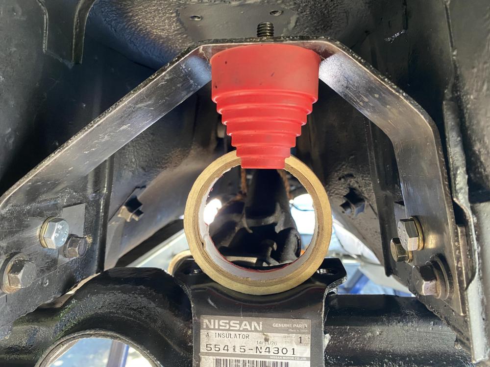

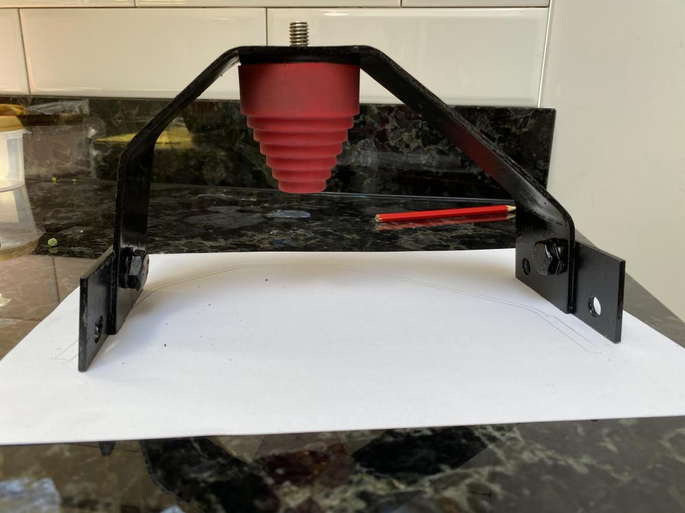

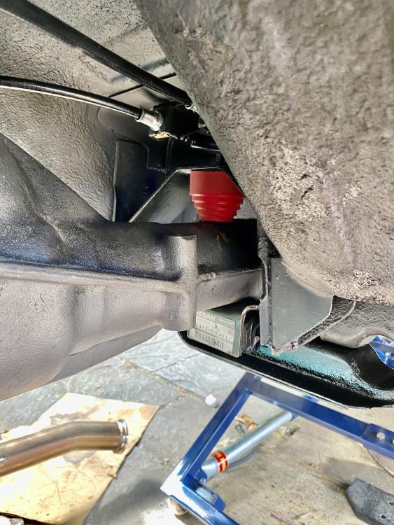

I made my own, I call it the AK Mount ;)
670e8a7c66025033f21cb90ad8146f41.plist&key=71d0682d8a39e8e0764cd77ed6dd24849d624ccd5ef9d44d479a365b3ada9b8780c127a0e8451730b7d3282c1827455f.jpg&key=56a7c87047d2fe9733b6a1dc14fdbeabcf1eea45d4e727851ca349468aed262bb382a9b0cfd32f2242bce9a463051b60.jpg&key=efac9de5ec9195961fccd479fdf6c5135fa919815e5a00d4b8c5c7b20bdf53de
If you are interested in doing the same I will update the thread with the final design of the one in the pics above.
The original design was meant to work with the strap. The final one was much stronger and replace all that strap business ;)
https://zclub.net/community/index.php?threads/the-%E2%80%9Cak%E2%80%9D-mount.27293/

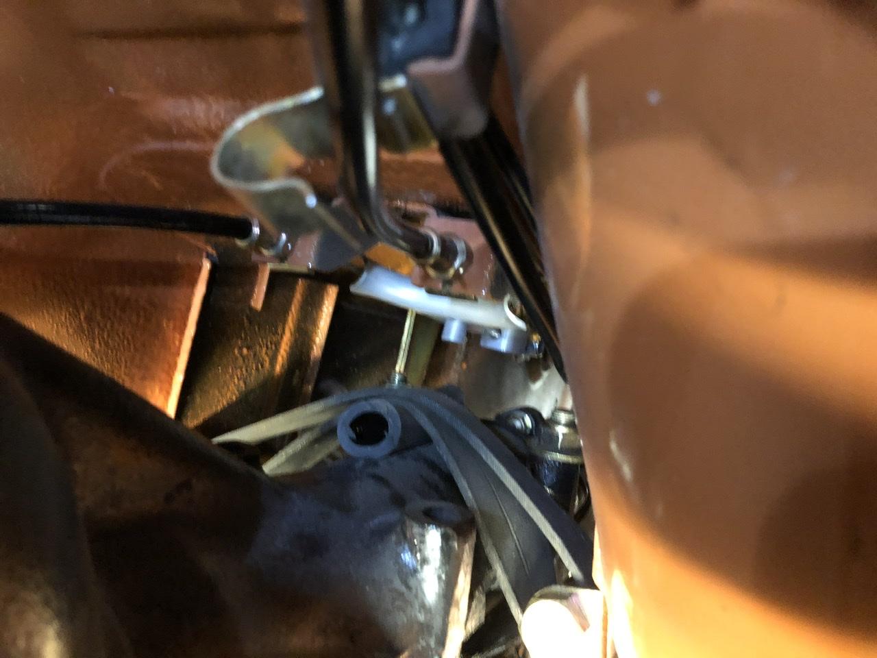

I also made my own. It’s called $1.00’s worth of rubber hose.
There is nothing wrong with the OEM design except the strap is too loose or gets stretched with time and allows the diff to lift too far tearing the rubber in the isolator. Just add a rubber spacer to remove the slop.
Yes I should zip tie the hose in place so it doesn’t work it’s way out. So $1.50

You should post up the dimensions.  Looks like something a person could do with a vise and a drill.  I had to find a friend with a welder for mine.  Cost me a six-pack of good beer.
One thing to be aware of is if the bushing/snubber is pressed too hard in to the top of the diff you can get diff whine in the cabin.  I experimented with straps and clamps early on when I was working on clunk and had some pretty noisy experiences.
