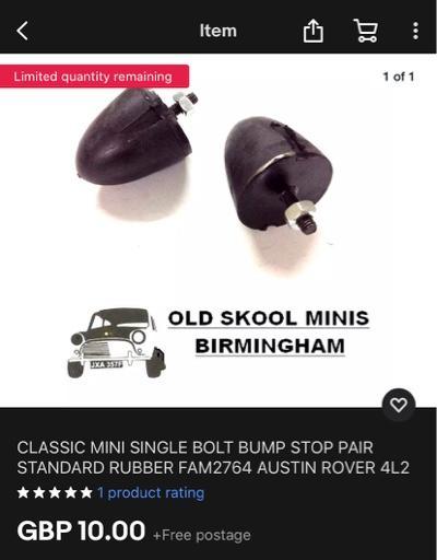

There is a 1-2mm gap between the diff and the snubber but it doesn’t show in the pic. There is no discernible whine from the diff but on full throttle I do notice a little more gear noise if I really try to hear it. There is the option of using a Mini’s rubber suspension bump stop if noise is a concern.
