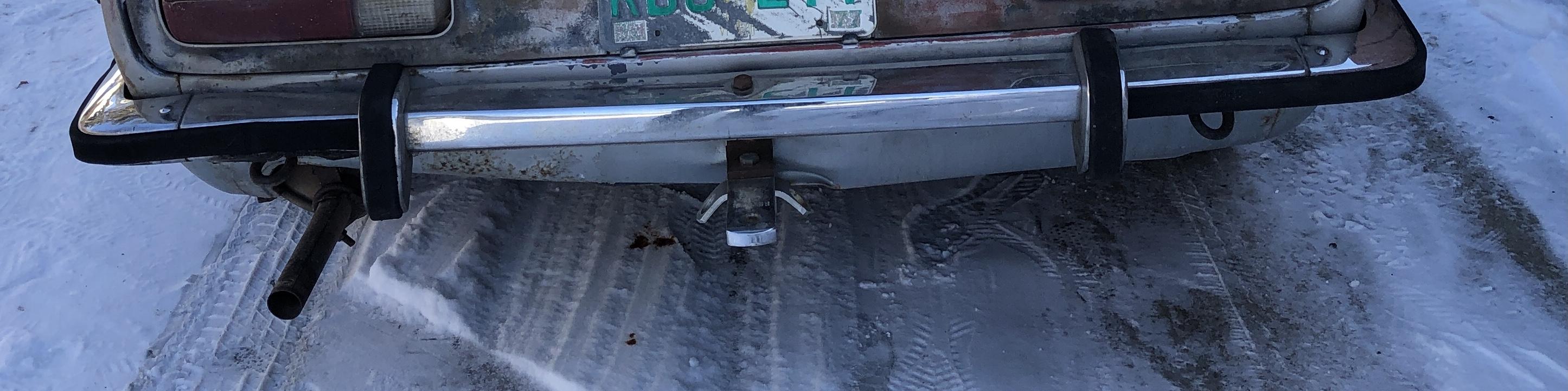

I just brought home a 71 Z that had a tow package attached.
it consisted of a 3/4 x 3” thick tow bar that attached at two points. The front was bolted through the spare tire well via a cross bar and two 7/16” stove bolts, and the rear was hung from the rear bumper with a 5/16 bolt. Yup, nice long bolt, straight through. Ouch
This is the only picture I have handy. You can’t see the big a$$ bar that runs under the spare tire well. It looks to be made for the car, the bar is bent in very specific places to fit tightly against the bottom.
I have removed the bar from the car. It’s in the recycle bin at the moment.
Edited by zKars
Not worth being saved?
