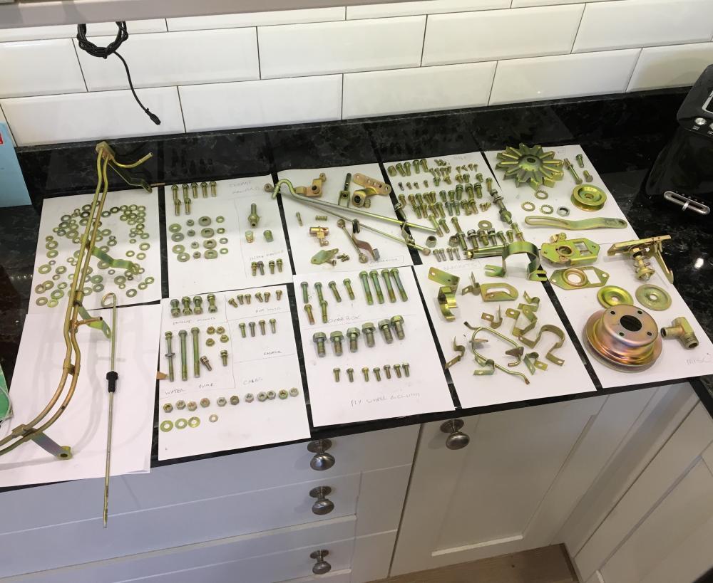

I geeked out on my box of shiny bits ...
b872560653cb479f5ff4d3bd41bd28ad.plist&key=7fa7744b01cbadcbc0ff9838a03a046331fc4e6ef5f3f1f8eb194b7536b06856
Obviously my wife was delighted with me laying it all out and labelling on the kitchen counter!
