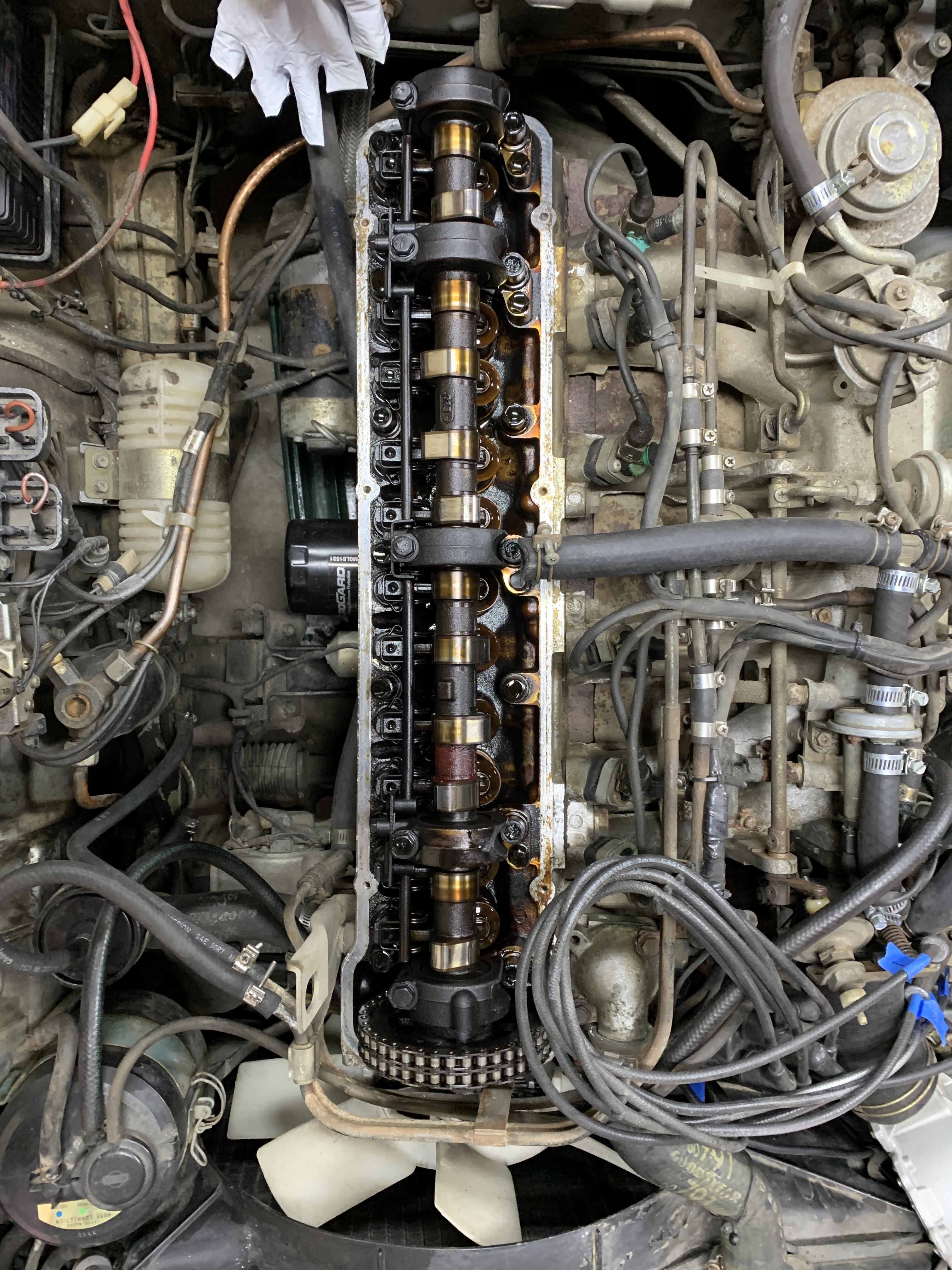

Pulled my Valve cover today to adjust the valve lash and noticed that there is a lot of burnt oil on the value train. Is this normal? Or a sign of overheating?
I have only had the car for about a year and a half. It’s had two oil changes in that time over about 400 miles of total driving distance so I don’t think it is due to my care, but no idea about the P.O. I haven’t seen it overheating in the time that I have had it. I do drive a mostly in the city which may have some impact.
If it’s not a big deal, will just clean it up with some acetone and go about my adjustment. If you guys have any suggestions for things to check, let me know!

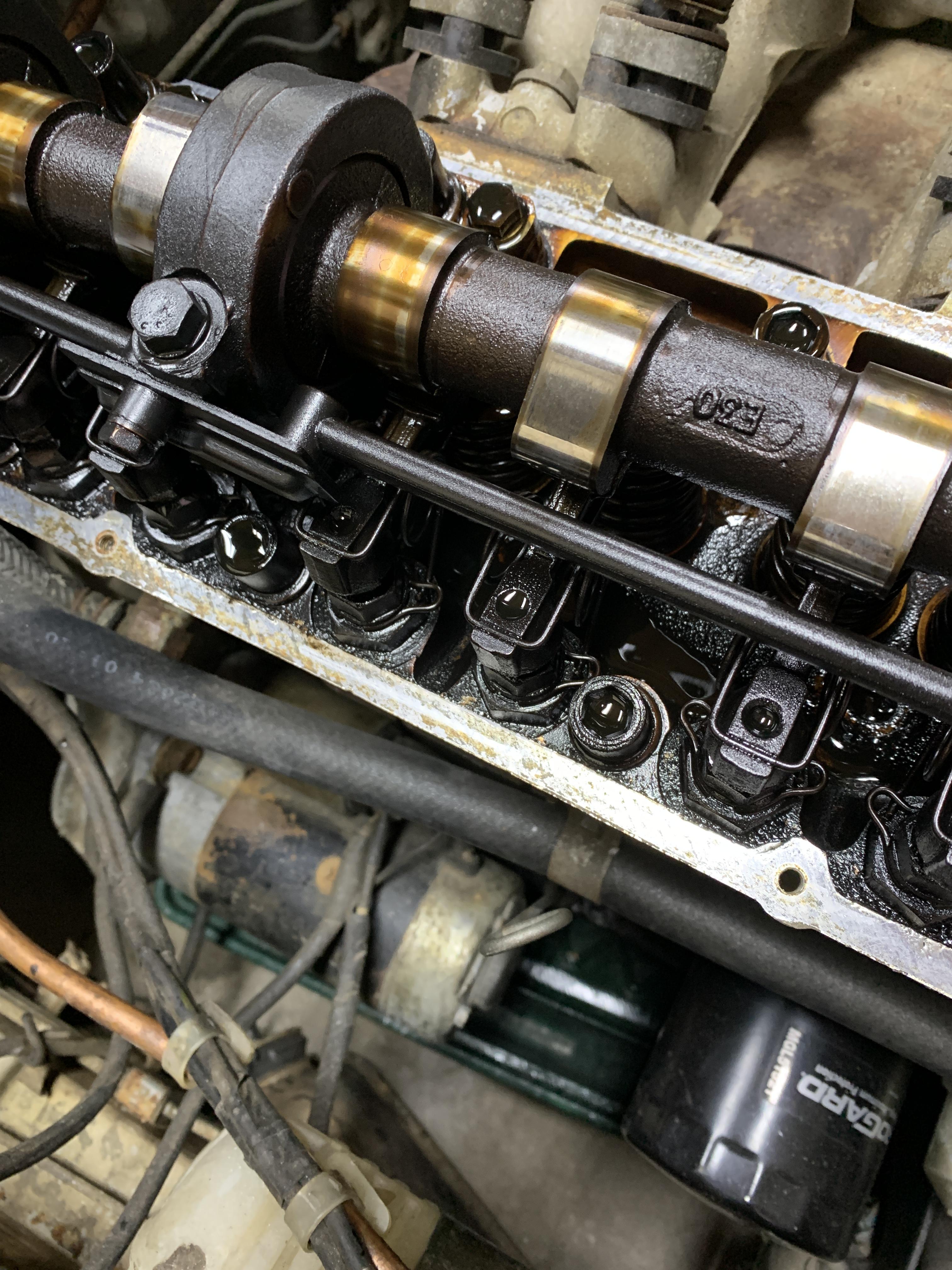

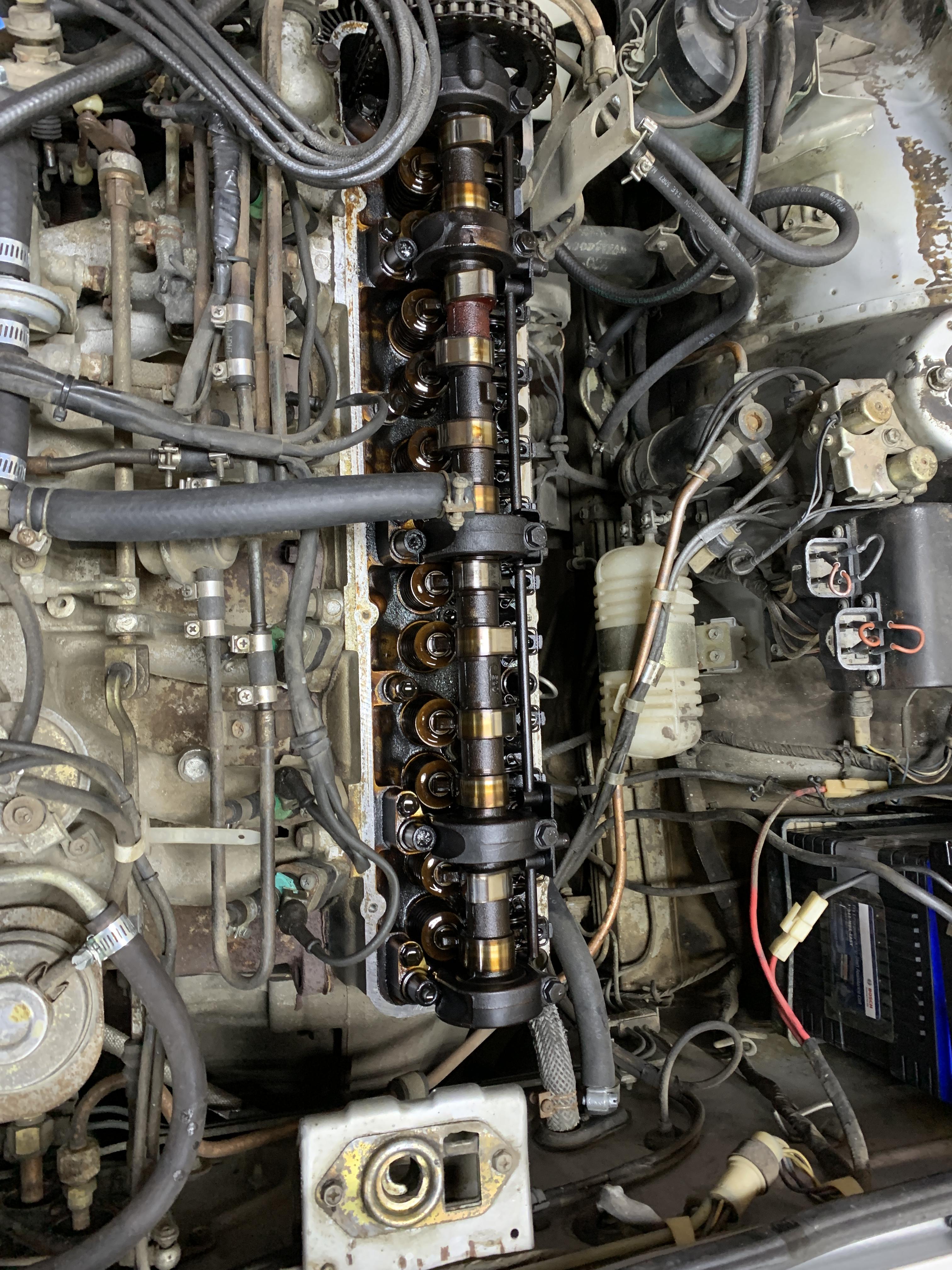

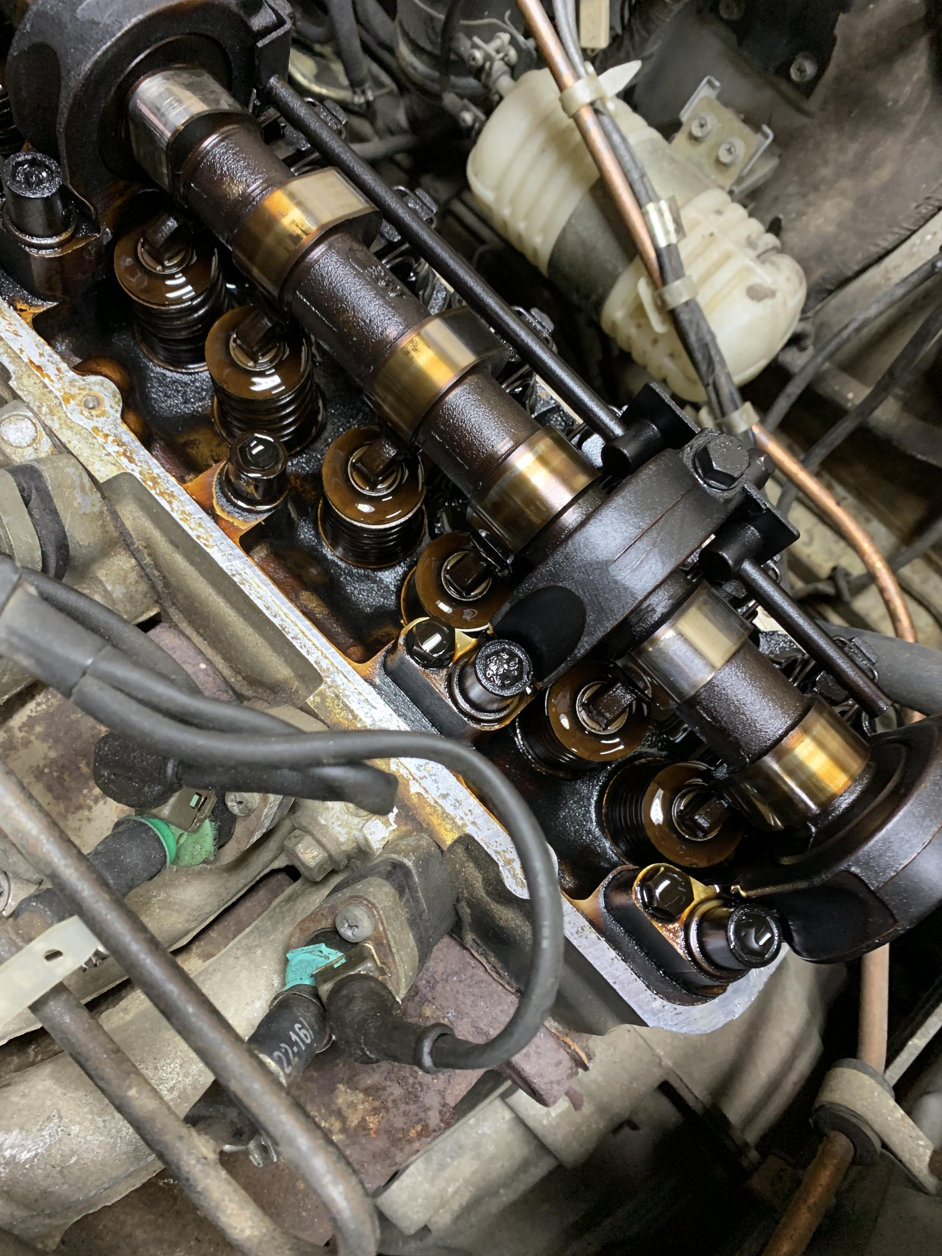

That actually looks very clean.  Not really worth doing more to.  If you start using a detergent oil most of that will clean up as the engine runs.
The brown color isn't from overheating it's probably just from blowby, combustion byproducts that have deposited up there.  Not hurting anything.
The brown color on the cam lobes is because the anti-rattle springs keep the rocker arms off of the cam base circle if the lash is set correctly.  There's no rubbing there, which is good.  It's also a good sign that you don't have any sunken valves since that will reduce the lash.  Can't remember the year of your car (you should create a signature on your profile with information), but sunk valves were a problem before about 1976.

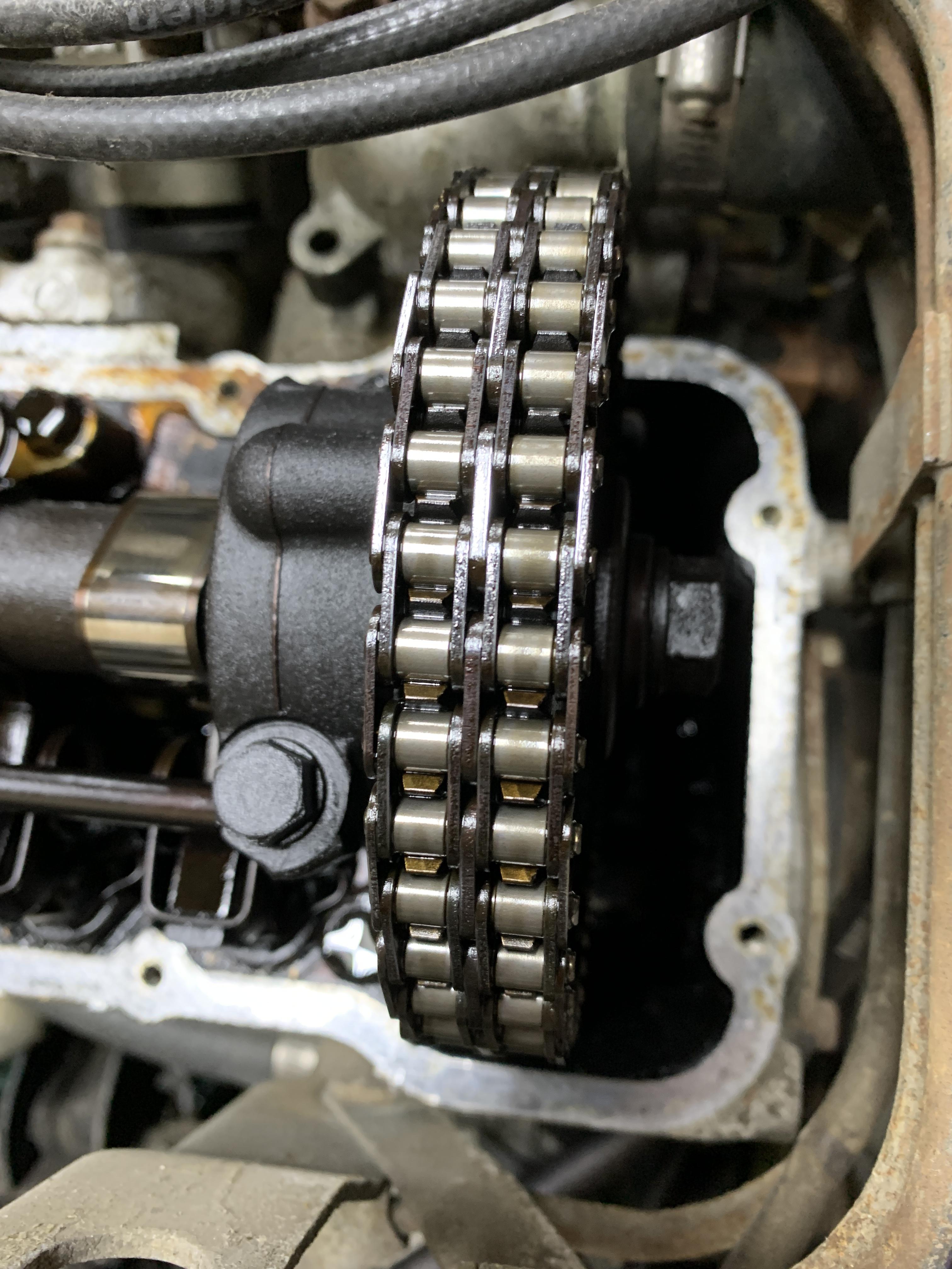

Check the notch and groove on the timing chain sprocket to get an idea of timing chain wear.  Make sure the tight side of the chain is tight and the timing mark is on zero.
Will take a look tomorrow. Fighting the Thanksgiving Turkey nap at the moment haha.
Hey @Zed Head  two quick follow ups
Checked the timing today. The oblong groove is just before the location notch. The hole above and to the left is the #2 timing mark so we are in between 2 and 3.
Q1: Does the fact that the groove is almost aligned with the notch mean this is something I need to keep an eye on? Or it’s time to change?

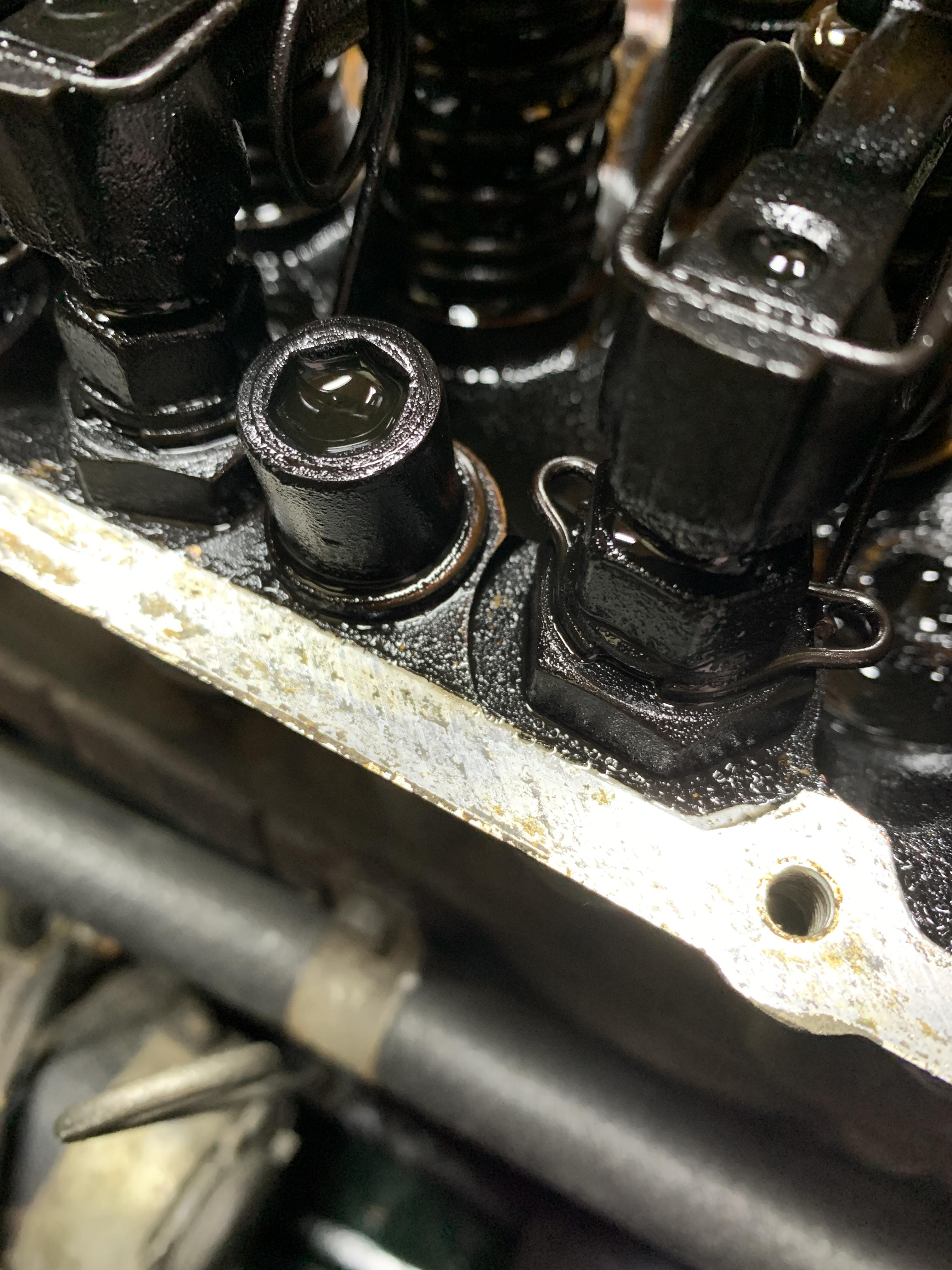

Q2: There is oil sitting above the 5 and 6 pistons. Is there be a drain back there? Or the only drain is At the front where the timing chain is?
The FSM shows the "Okay" range as pretty much across the groove.  The notch starts at one side and as the chain wears it ends up at the other side.  If you're in the middle, you can't make it better.
And I think you're still in the "1" hole, see picture.  Your engine seems to be in good shape.  Almost disappointing, nothing to work on.  Something will crop up...

@siteunseen & @Zed Head one more thing. You mentioned that I am in the #1 hole. Just saw the #1 below the window you guys highlighted. So what does the #2 indent at the top of the pulley mean just below the chain? Is that where to set the bright chain for the #2 window then?
Engine Mechanical chapter.  There's a lot in it you can go through it many times and always pick up something new.  The bright link is not really needed if you have the notch, and the ignition timing marks on the damper.
Get Monroe's "How To Rebuild... book.  https://www.amazon.com/Rebuild-Your-Nissan-Datsun-Engine-ebook/dp/B006VUICHG
You are on cam position #1.  That is fine.  Your mechanical valve timing is a little advanced as shown by the triangle indicator which is fine.  Seems to be a new non-stretched chain.
When you get a couple hundred thousand miles on your Z then you can go to position #2  to take up chain slack.  You have no worries and are good to go.
