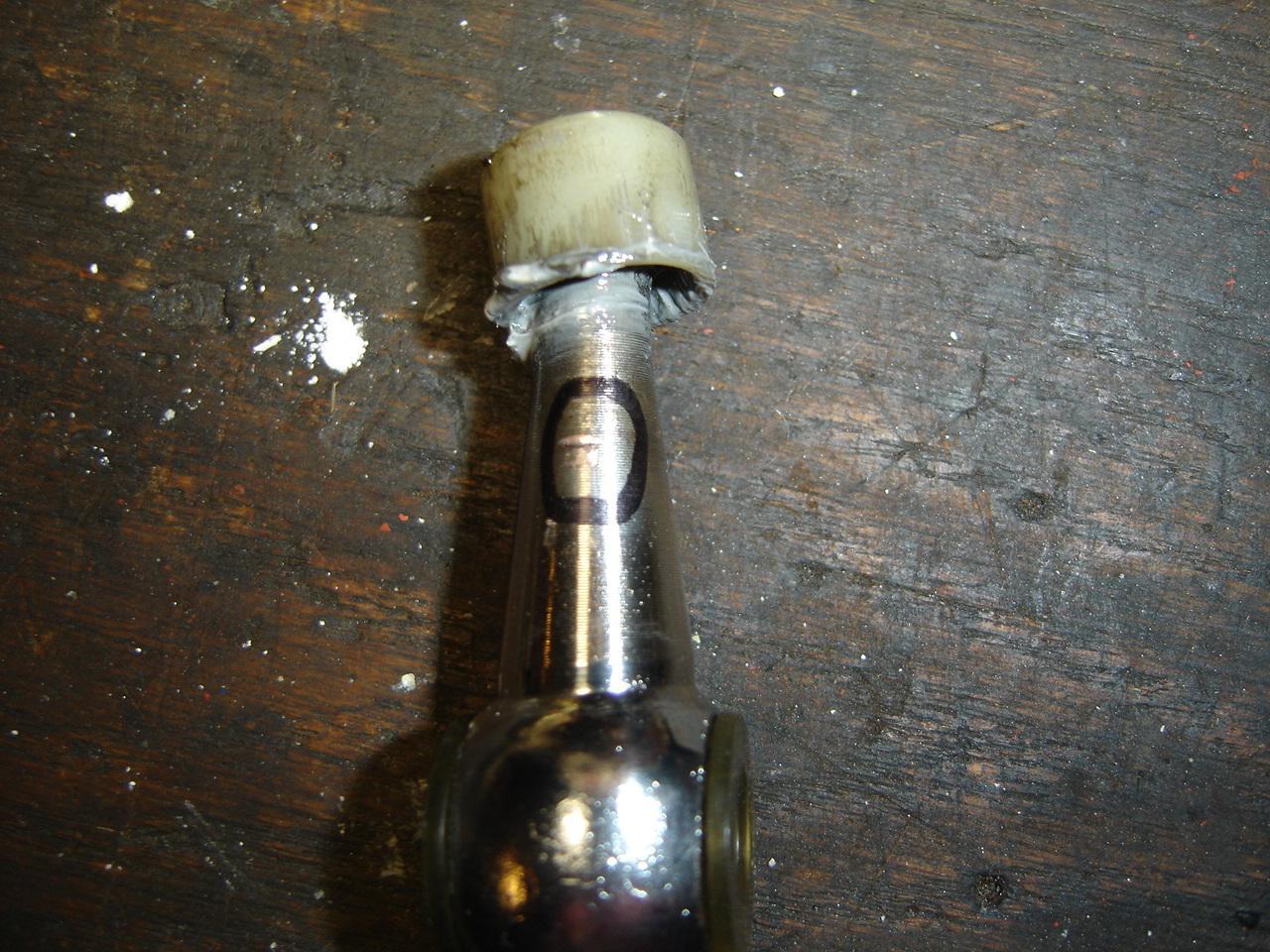

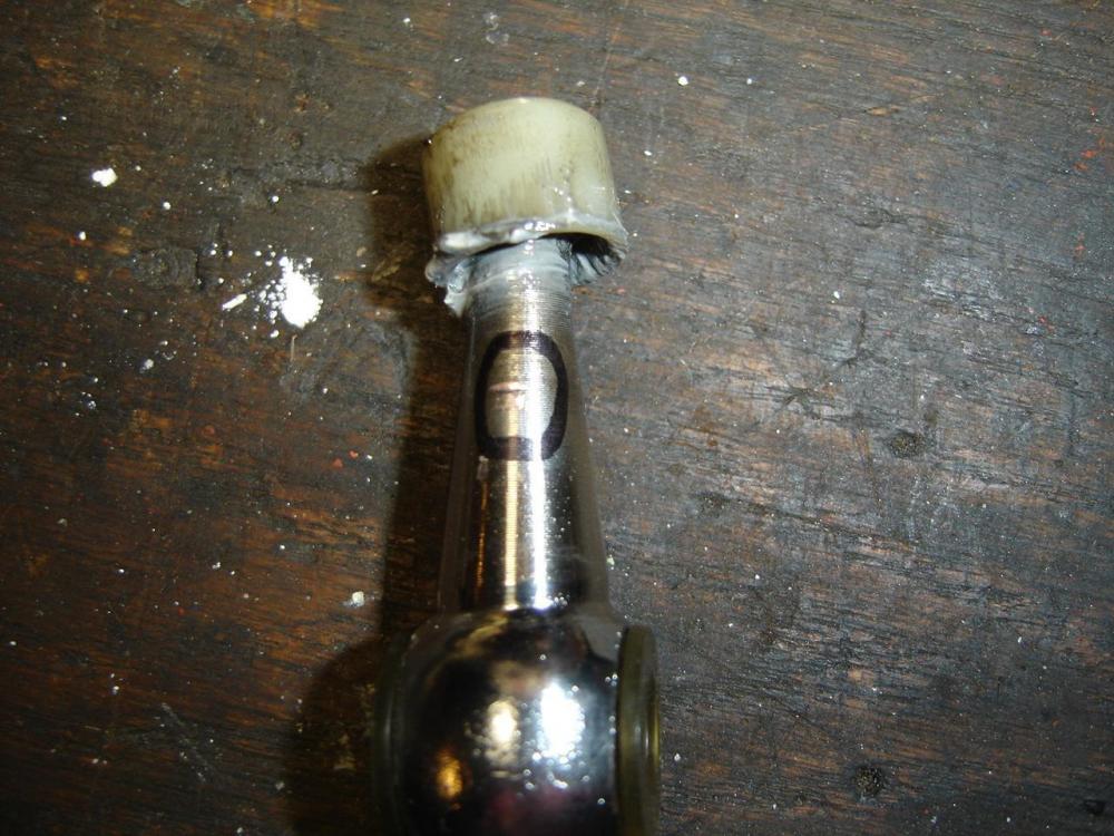

My 280zx wide transmission's shifter hit in my 240. If you take the shift rod out you can see the nicks if it's hitting
@siteunseen Good suggestion. I pulled the shifter before I left and it looks like there isn’t any damage. It’s actually less grimy than the shifter currently installed on the 280z 5 speed that I had planned to rebuild this winter so I grabbed it haha. (Photos below)
