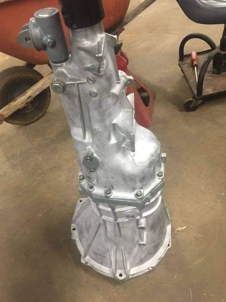

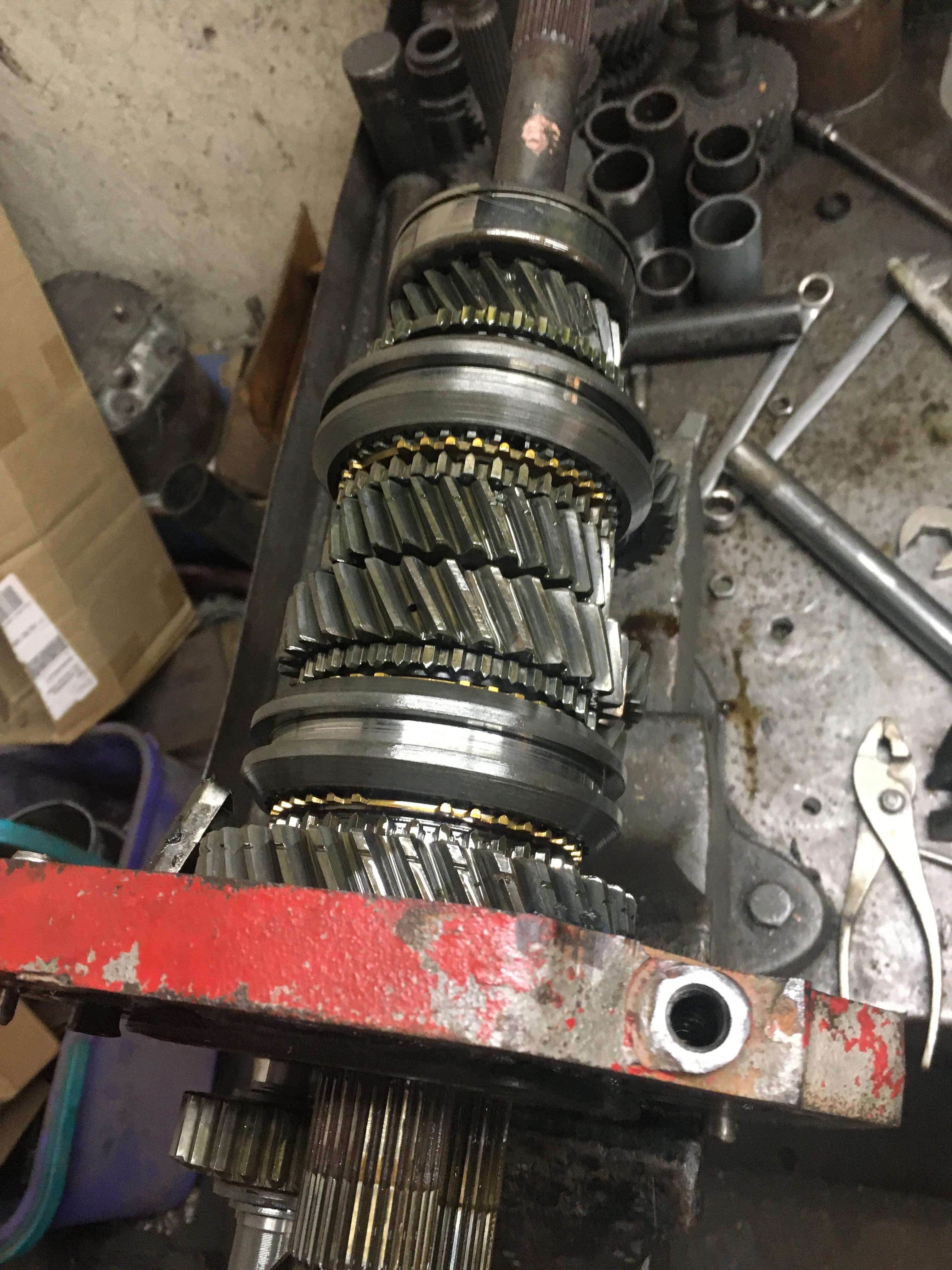

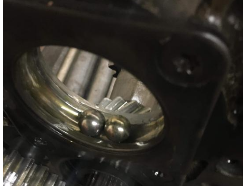

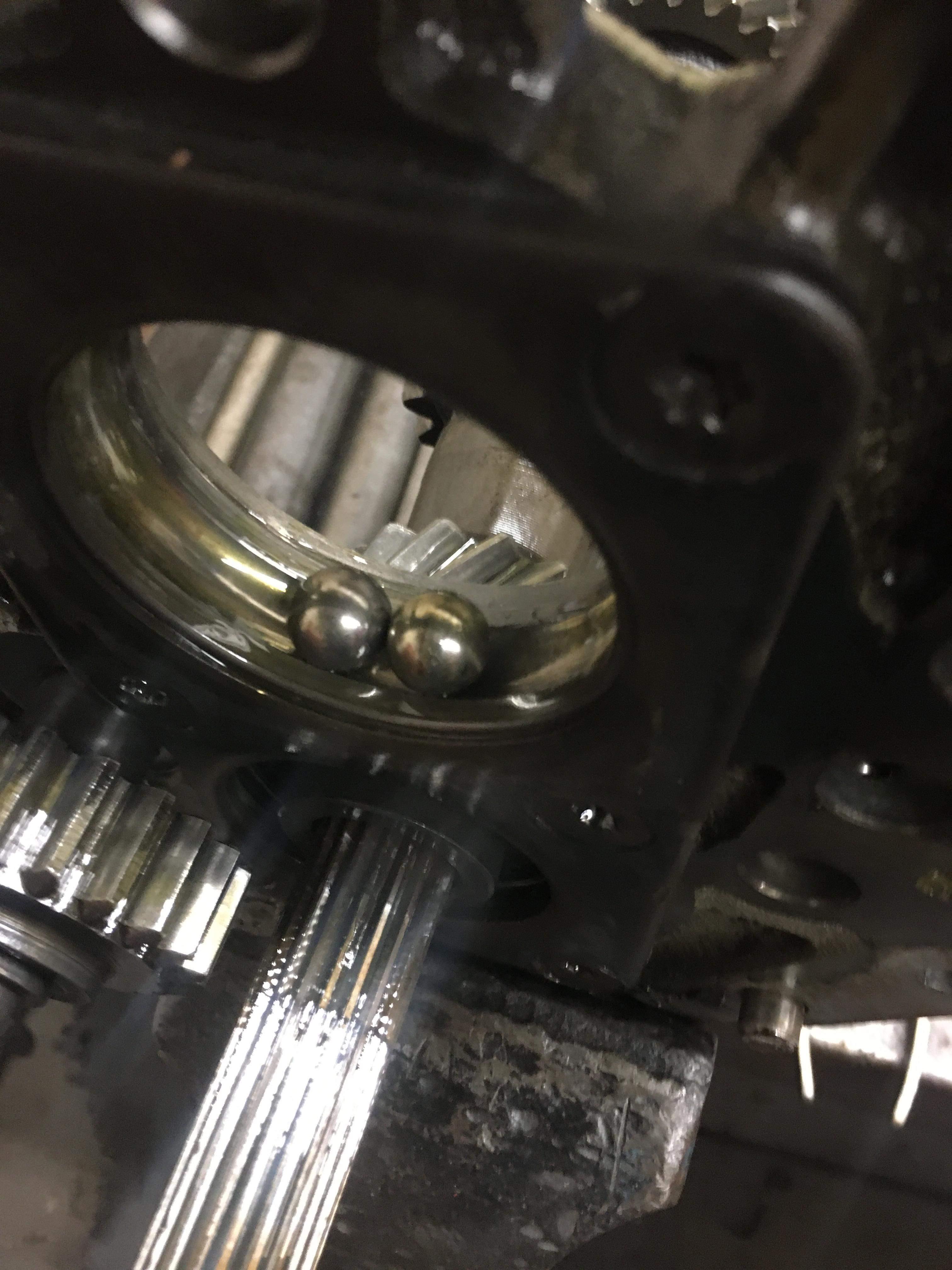

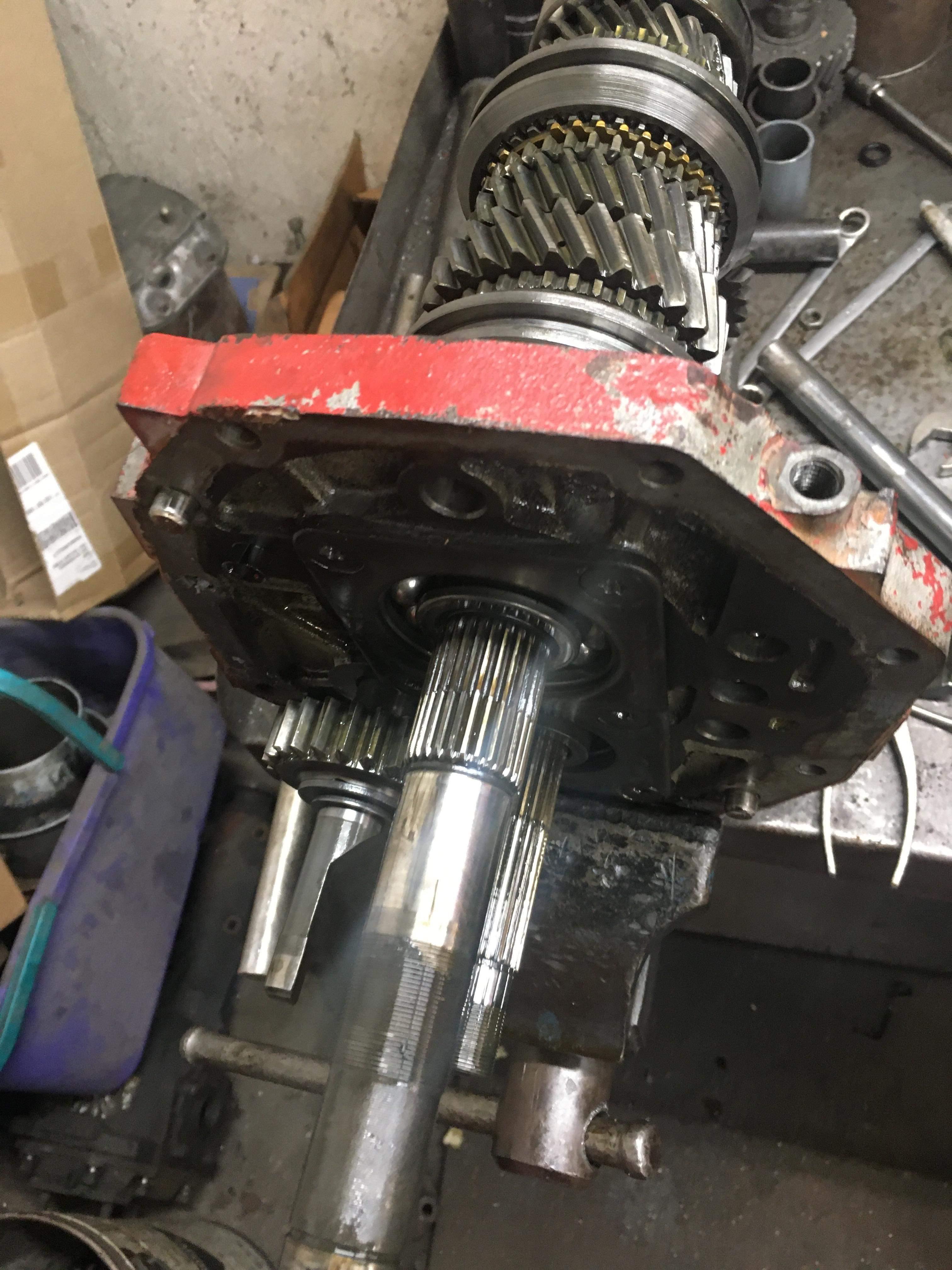

Quick update for this topic! Sent the trans out to a Z specialist in the Carolinas for inspection and rebuild. Main bearing was shot, but otherwise everything else was in ideal condition. Posting some before /after pictures for our mutual gratification.
Before:
197CA16E-1929-4A81-B6FF-131F31FA4282.jpeg5D66E7D9-5DC6-460D-A579-9BF6DABDAF89.jpegMissing a few: C6B61A87-5AD4-44DF-80B3-0774F537D150.jpeg
After:
