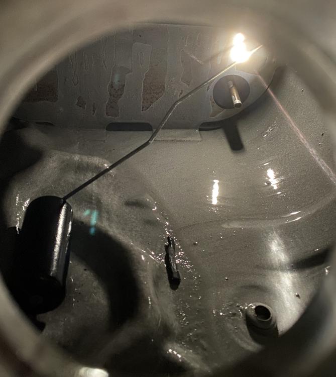

So it seems I need to turn my attention to a fuel blockage. I am getting black fish swimming around inside the filter and given that I replaced the fuel lines for alu with only 20cm of fresh rubber used, I am strongly leaning toward the POR15 treatment letting go. Some of it wasn’t flushed out properly by the PO and I wonder if there are lumps that aren’t fully set coming though? See the area where the float is sitting. You can see a black “eel” next to it before I flushed the tank. Also you can see a crater where the POR treatment wasn’t properly flushed out and has set.

In my early 74 there was a small perforated can that was over the end of the pickup tube.  It dislodged when I was rattling bolts around in the tank to remove as much crud out of the tank as possible...  I suppose it could have come off of something other than the pickup - I was assuming it came off of the pickup.  I wish I had saved it so I could post a picture.
Edited by GGRIII
clarification
I found a reference to a 76 fuel tank that describes a fine mesh screen around the base of the canister that the pickup and return line are in.  I thought that the 240Z inlet lines had a metal "sock" on the end of the line.  Basically like a metal fishnet.  Can't find any cut open 240Z pictures though.
https://forums.hybridz.org/topic/96315-por-15-fuel-tank-repair-question/?do=findComment&comment=910896
I guess the take away is that I think there have been more than one person that has had 'fuel pump' issues that may indeed have been restricted pickup tube issues... Easy thing to check.  The next pump I was going to try is a Carter P90091 or P60430.  Any thoughts on this style on pump?

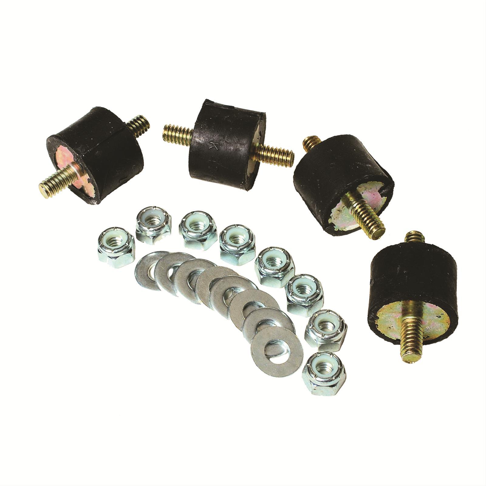

Mount them with rubber isolators and the noise is much lower.

In all seriousness it was SO much more quiet in the cabin after the pump died, almost makes me want to get a replace it. @Racer X what rubber isolaters? the small ones that come with it, happen to have a picture of the setup?
