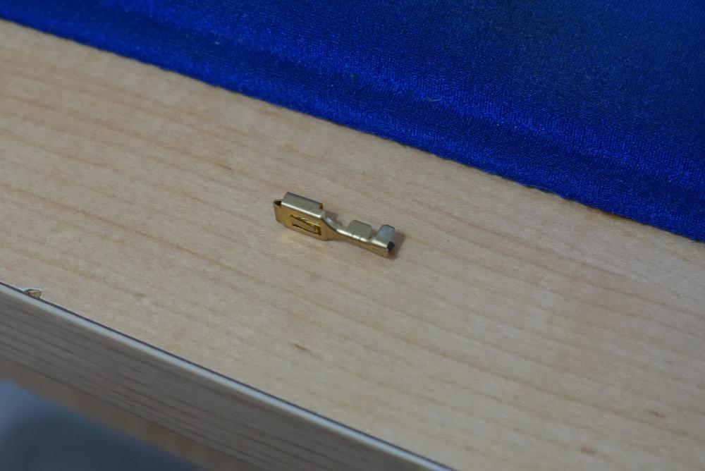

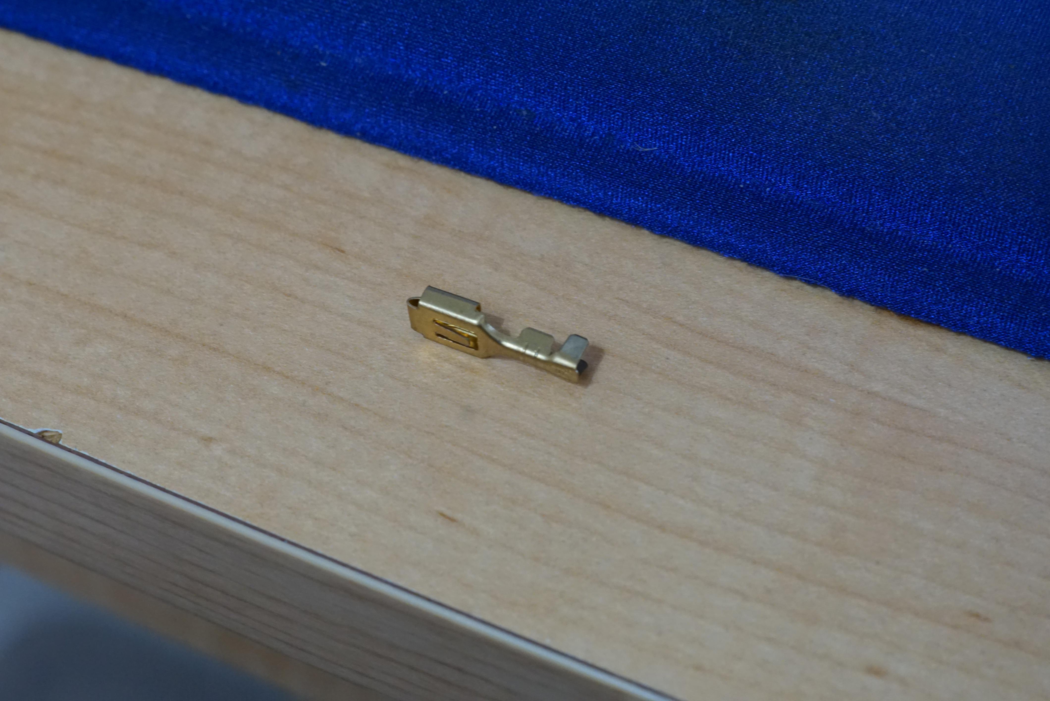

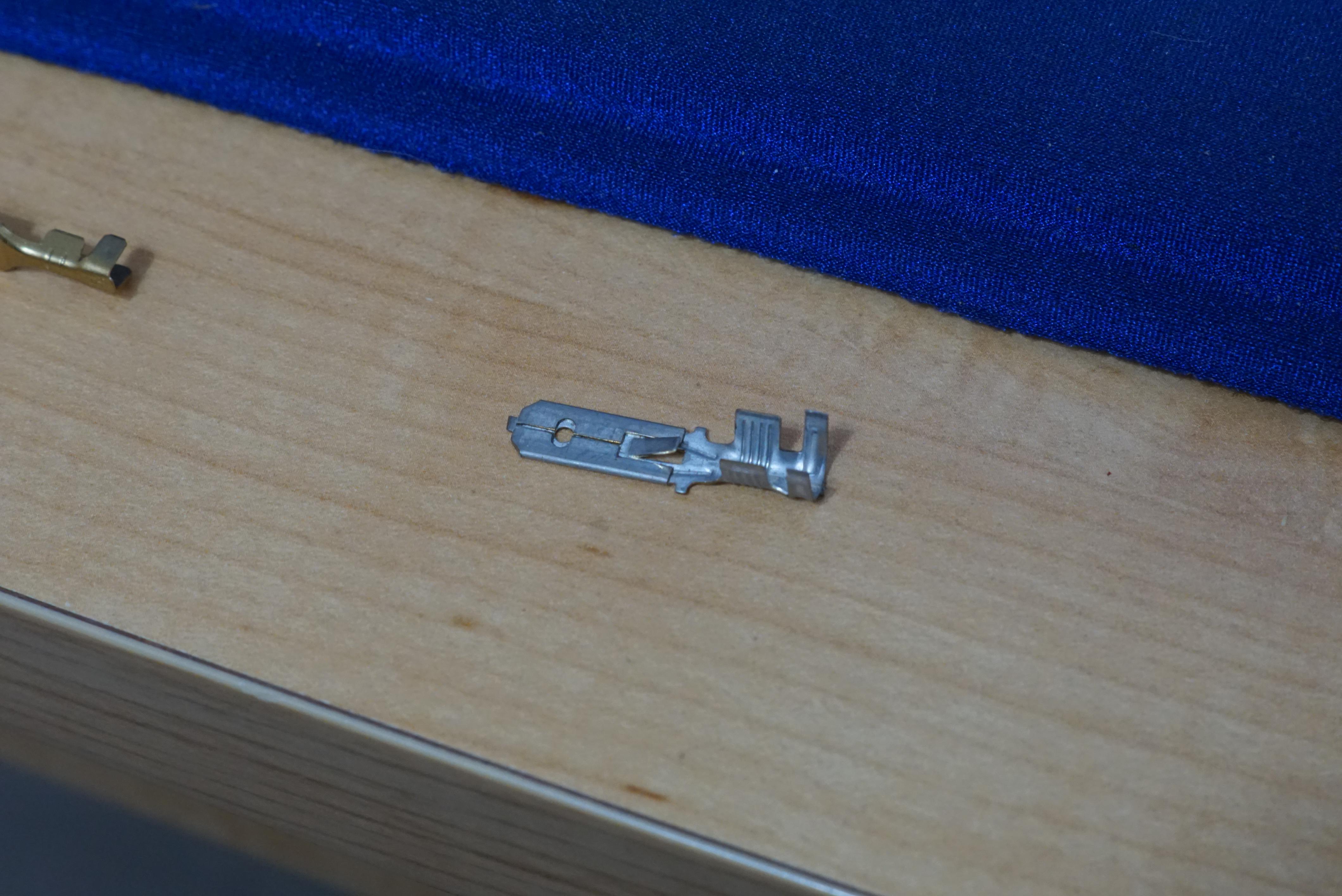

Probably the easiest way is to use the extractor tools they have on the website: http://www.vintageconnections.com/Products/Tools. Get the set as you will have both 2.8 mm and 6.3 mm terminals that you may want to back out.
The terminals have little tabs on them that hook inside the shells.
You depress the tab with the extractor tool. It helps to push the wire in a little first. After you get the tab pushed down, you can pull the wire out.
