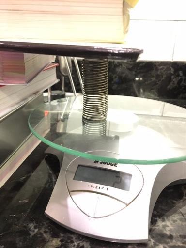

1. Test your spring rates - I did mine very simply using books and kitchen scales to prove they were pushing equally at the same height (67mm). Let’s prove you have equal resistance between your carbs so as to eliminate that.

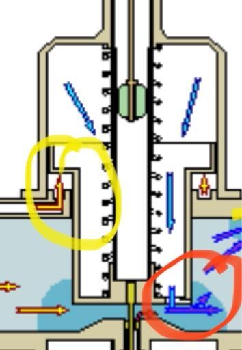

2. While you have the domes off, check that the hole(s) in one of the pistons isn’t blocked (red markup). The one that “communicates” manifold vac to the piston. Also check the small carb inlet holes that “communicate” atmospheric pressure (yellow markup). These are the only mechanisms by which the piston is lifted. If blocked, or restricted, the rise will be affected. Give them a good squirt of carb / throttle body cleaner and a small brush / wire through the holes. Also ensure that the washer at the bottom of the spring isn’t blocking the piston holes when reassembled.

@AK260 One spring measured at 2.2oz, the other 2.1oz, so probably within margin-of-error. I confirmed that the holes in the pistons (two on each piston) are clear of debris.

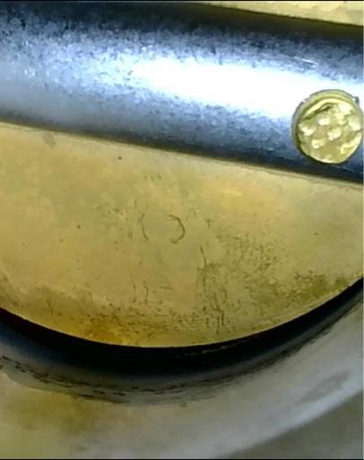

Attached is a picture of the front carb's butterfly when it's off the car. It seems like it completely closes off. The second is when it's installed. It appears that the flats on the throttle linkage push the butterfly open slightly. Might I need to bend these back a bit? They do look slightly more open than yours.

So it’s good that we’ve eliminated the possibilities of blocked holes etc. The drop test is exactly that and it should be a relative quick drop and thunk!

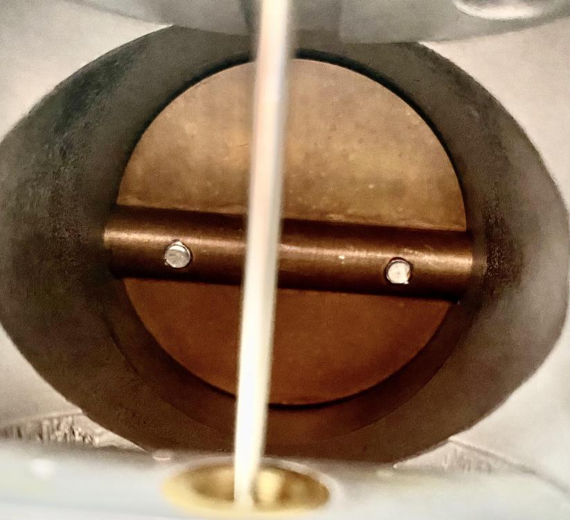

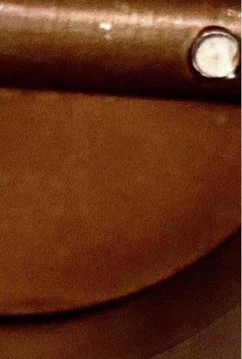

Your last borescope photo shows me it’s way too open for idling at sensible revs. If I put yours and mine side by side below, and we use the throttle shaft butterfly screw as our scaling datum in each photo, you will see yours is way more open than mine!!!

Now it’s interesting that putting them back on is causing them to open - you’re now starting to point to a potential linkage issue. Are you able to put the carbs on and back off all the linkage screws such that both carbs are independent of each other. And to be very clear - no choke cable connected either!
You then want to back off completely on the idle screws such that the butterflies are completely shut when on the car. Inspect visually.
Now, feeling the butterfly with fingers on one hand, you can turn the idle screw with the other until you feel it “just” start to move. Do the same on both sides and inspect visually to ensure they are equal and not more than a hair width open.
Now try to start the car and let’s see what happens!
For clarification here's the rear carb:
Yeah, I can see visually that there is WAY WAY too much airflow for idle right there. I think we’re starting to get somewhere. You definitely need to back off those idle screws a lot and or figure out why your butterfly is being held open.

That butterfly position is FAR more like it. It’s been frustrating for you but you’ve learned a lot about your car at least, so next time you are better able to troubleshoot it.
