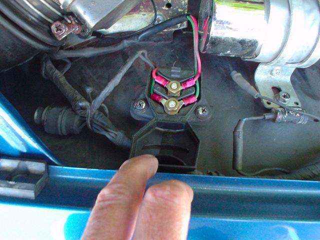

23 minutes ago, Ownallday said:
Where is the resistor located for the 78 280z Tach? I don't have my voltmeter to check at this time but would like to see if bypassing it does anything if possible
Don't bypass it. It is there for a reason.

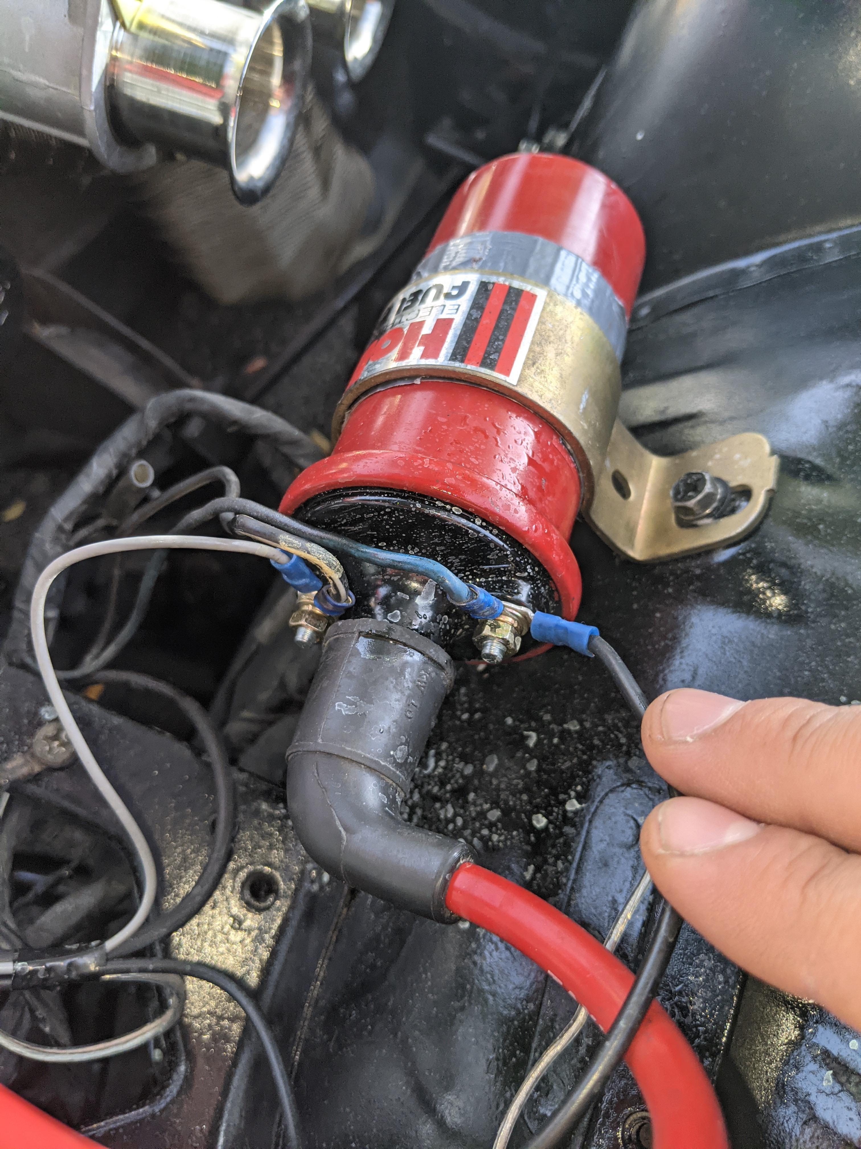

Is this the condenser you are talking about, it's the only one I have? Funny thing as its not connected to the coil at all.

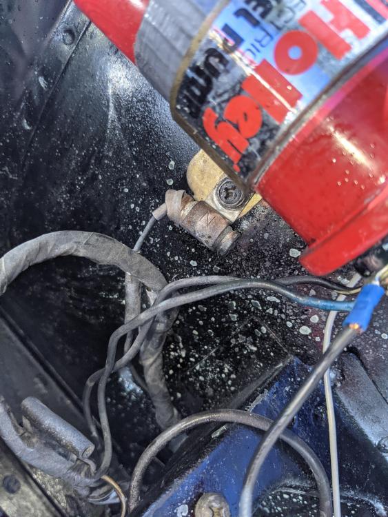

Something I just noticed is my two old positive and negative coil wires are just sitting hanging out of the wiring harness. Could this have anything to do with the Tach not working on low rpms as the guide doesn't exactly mention anything about using the old coil wires and not sure it makes a difference since I switched to Triples.

Right side of the coil is negative with the blue wire connected for the tach and the black wiring going to the dizzy. On the left side of the coil the positive side has the white wire going to the dizzy and a black/white wire which was originally connected to the old coil going into the wiring harness. These are the only wires currently setup to the coil
The two wires I am talking about that I have hanging were originally in this spot. They are going into the wiring harness.
Those wires, the red and green, actually went to the old distributor and the ignition module under the dash.  They are the trigger wires.  Not used anymore because all of that is contained in the ZX distributor now.
If the engine starts and runs properly and the tach needle is twitching then odds are the connections are correct.  The blue wire supplies both the ECU and the tach with the spark signal, to fire the injectors and run the tach.  They're on the same wire.
Might also be that your new coil is "noisy".  Might be worthwhile to swap the old coil back in, just to see.  The coil is the other thing that is different now.
