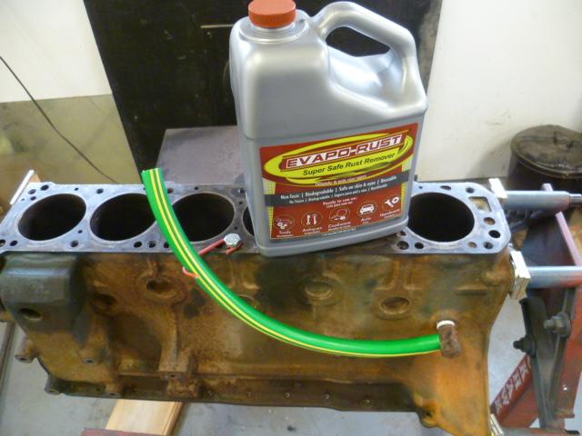

I threaded a nipple into the drain hole on the left side of the block and jammed a length of garden hose onto the nipple. The nipple was the one that threads into the back corner of the head, and the garden hose was from my buddy's hose when he wasn't looking.
We did two blocks like this. First block we used ospho, and the second block we used evaporust. The ospho worked better, but the evaporust didn't stink like the ospho did.
Note that the length of hose must be long enough so that you can keep it above the deck surface. Used a funnel to fill it, and then just unhook the hose and lower it into a bucket to drain. What you can't see is that I made a block off plate to cover the water holes that go into the front timing cover. But the rest of the process looked like this:

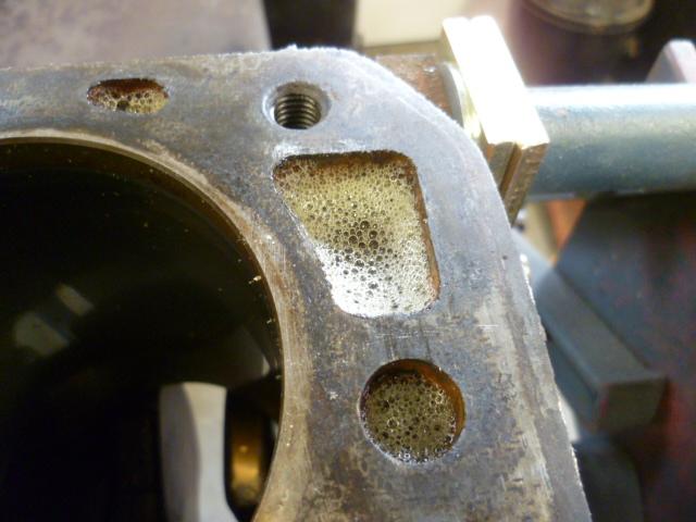

Fill it up to the point where you get worried about it coming out the holes in the deck and let it sit:
If I were to do it again, I would use ospho followed up by the evaporust. But I would do the ospho with better ventilation.
