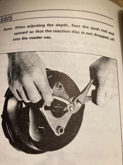

so if I take the master cylinder off, this is the view of the booster (first picture.) is there a way to get further into the booster while it’s on the car, to see if that disc has fallen off?

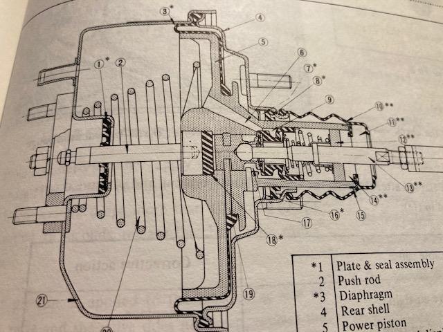

Also, I don’t know if it’s worth noting, but if I pull the rod out I can feel it slide out of whatever is inside there to guide it, and after that it just kinda flops around (second picture) i don’t know if that’s normal
You can just pull that straight out. There is a metal ring with a rubber seal on it that will be loose out of the hole (#1 in the side view pic). The reaction disc (#18) is on the back disc of that rod (#2)
Just judging by the amount of adjustment thread is showing I'd venture to guess the disc has fallen off. I had to remove the whole booster and shake it around until I could fish out the rubber disc.
I do not think you can open the booster while it is still in the car. Gives you the chance to repaint it too.
Even when adjusting the rod they mention the disc dropping out. I glued mine back on to avoid it falling off again while reassembling.

so if I get the right grip and leverage on the pushrod, I should be able to just pull it out? It hasn’t come out so far from my pulling, and I obviously don’t want to damage the metal ring or rubber seal.
If that’s the deal though then I’ll do my best to get it out.
I do have an FSM, and it doesn’t mention pulling the pushrod out by this method, that I’ve seen
