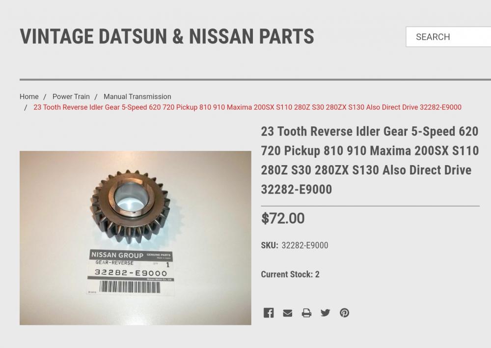

EuroDat Posted June 29, 2021 Share #90 Posted June 29, 2021 Hi Charles. @Patcon I'm not sure how far you are with Codys tranny, but I found this in my weekly search. http://datnissparts.com/23-tooth-reverse-idler-gear-5-speed-620-720-pickup-810-910-maxima-200sx-s110-280z-s30-280zx-s130-also-direct-drive-32282-e9000/ Link to comment https://www.classiczcars.com/topic/64852-zx-5-speed-rebuild/?page=8#findComment-624273 Share on other sites More sharing options...

Patcon Posted June 29, 2021 Author Share #92 Posted June 29, 2021 Thanks for the link Chas! All thats assembled and I had a very kind forum member ship me a really nice used 23t gear which we used 1 1 Link to comment https://www.classiczcars.com/topic/64852-zx-5-speed-rebuild/?page=8#findComment-624277 Share on other sites More sharing options...
