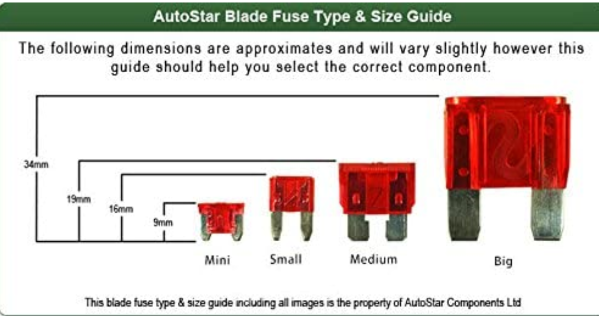

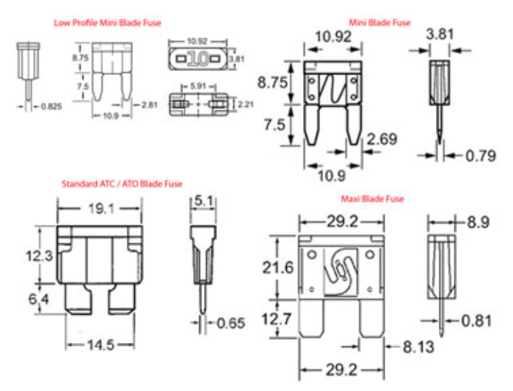

There are different manufacturers.  Maybe the "spec" is only for the blades.  Or maybe there is no spec.
These guys sell low profile blade fuses.
