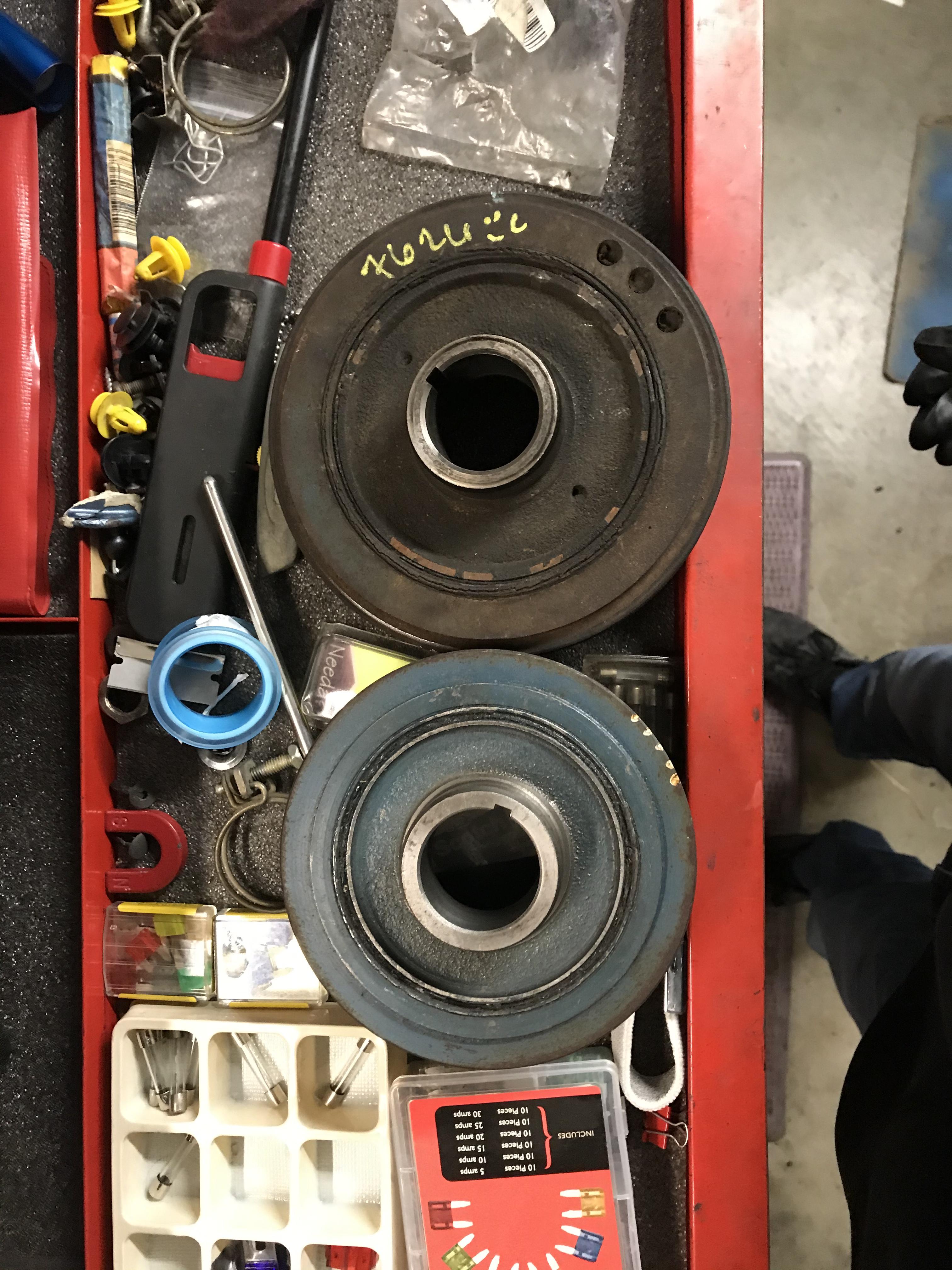

@Zed Head Both the old and new pulley have a hub depth of 27m.. The motor is a l26. I think it should be OK. Thanks for the heads up.
@Racer X I’ll have to double check the fan when this is all installed properly. There seems to be a slight resistance to the fan. I wonder if I can simulate the opening of the plate with a heat gun, just to bench test it. I’ll get a video up later.

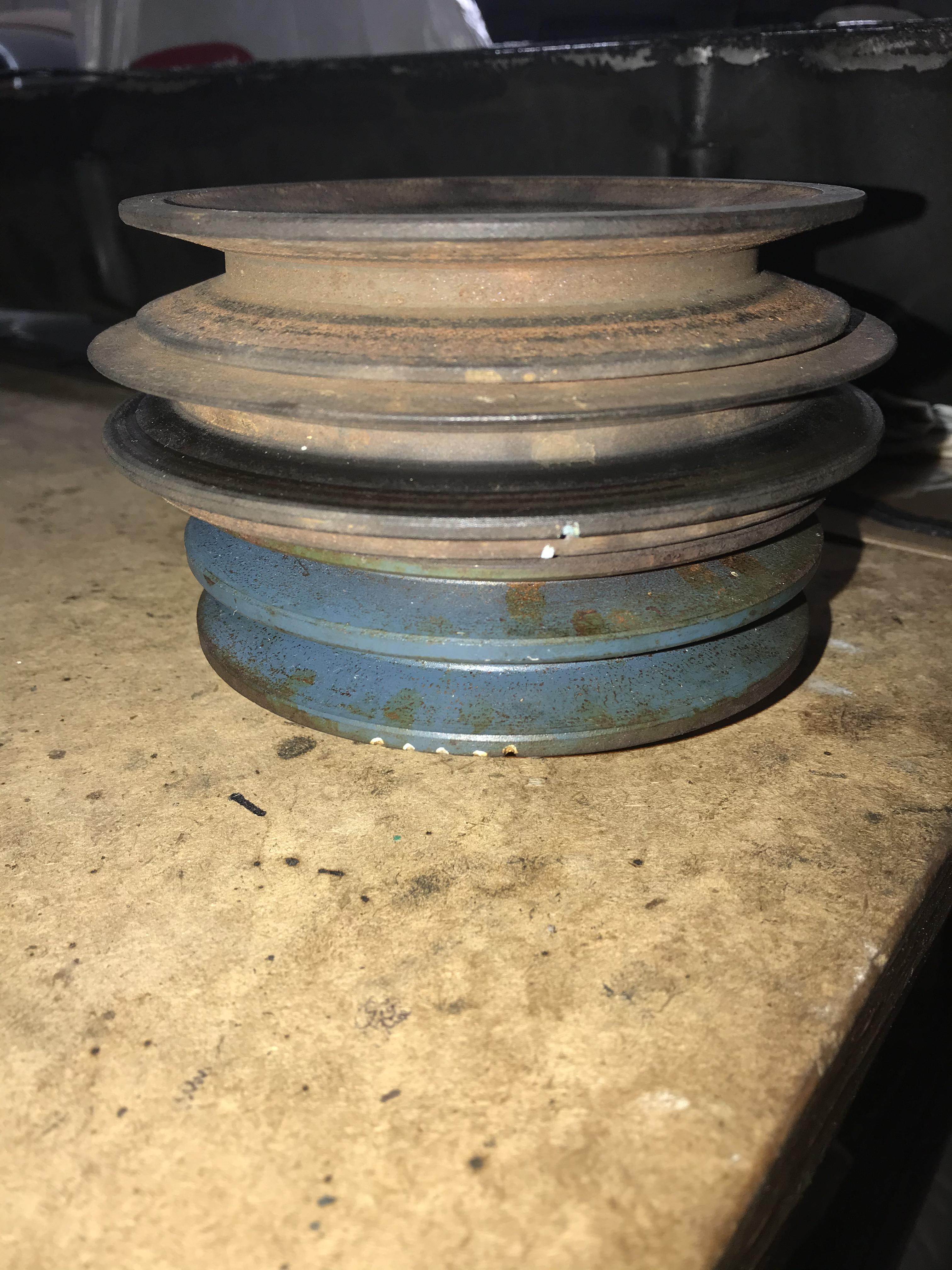

there is a difference in diameter of the pulley.
the new one seems to be lighter so that’s nice.

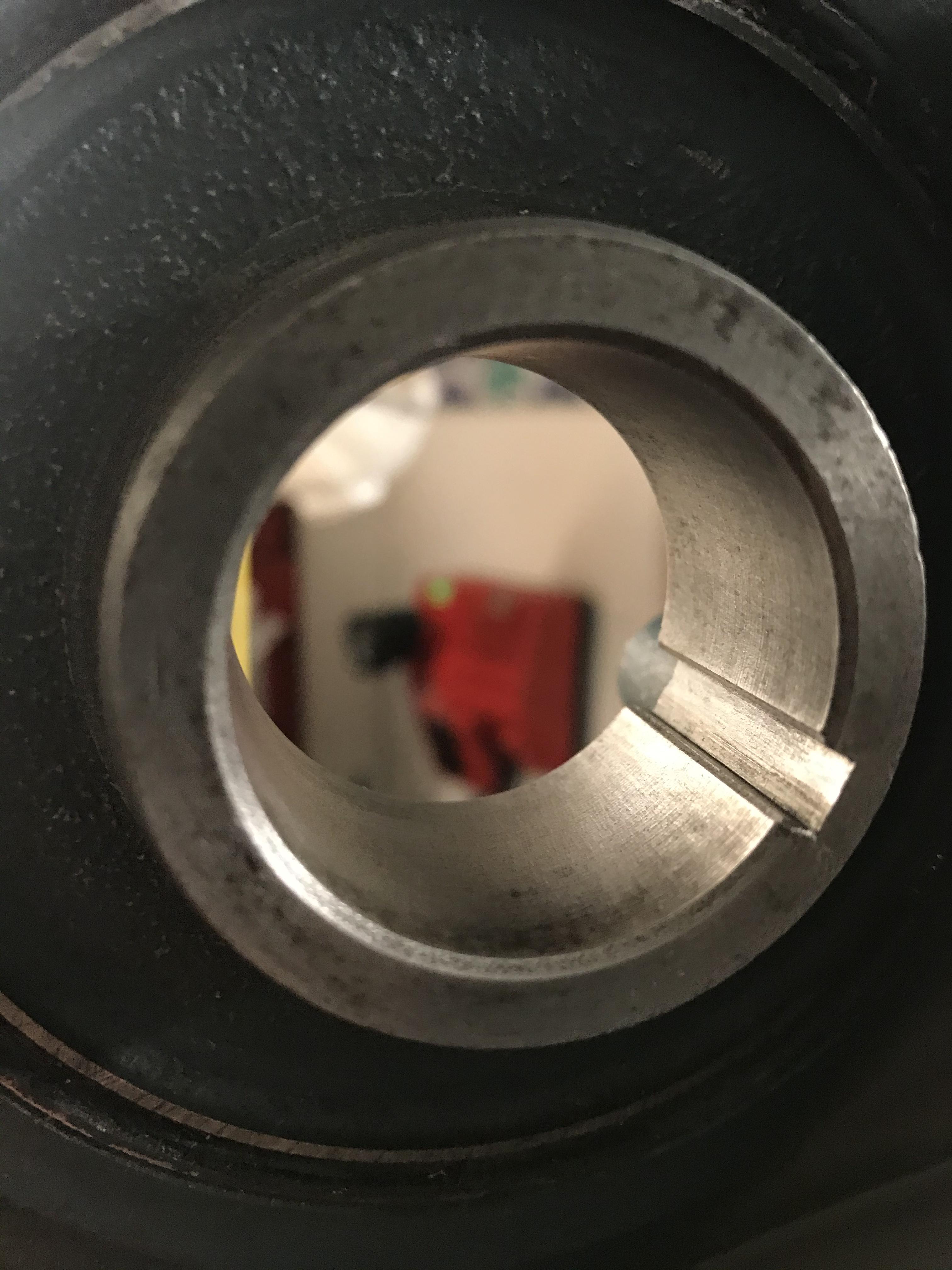

That's what the keyway and key are for.

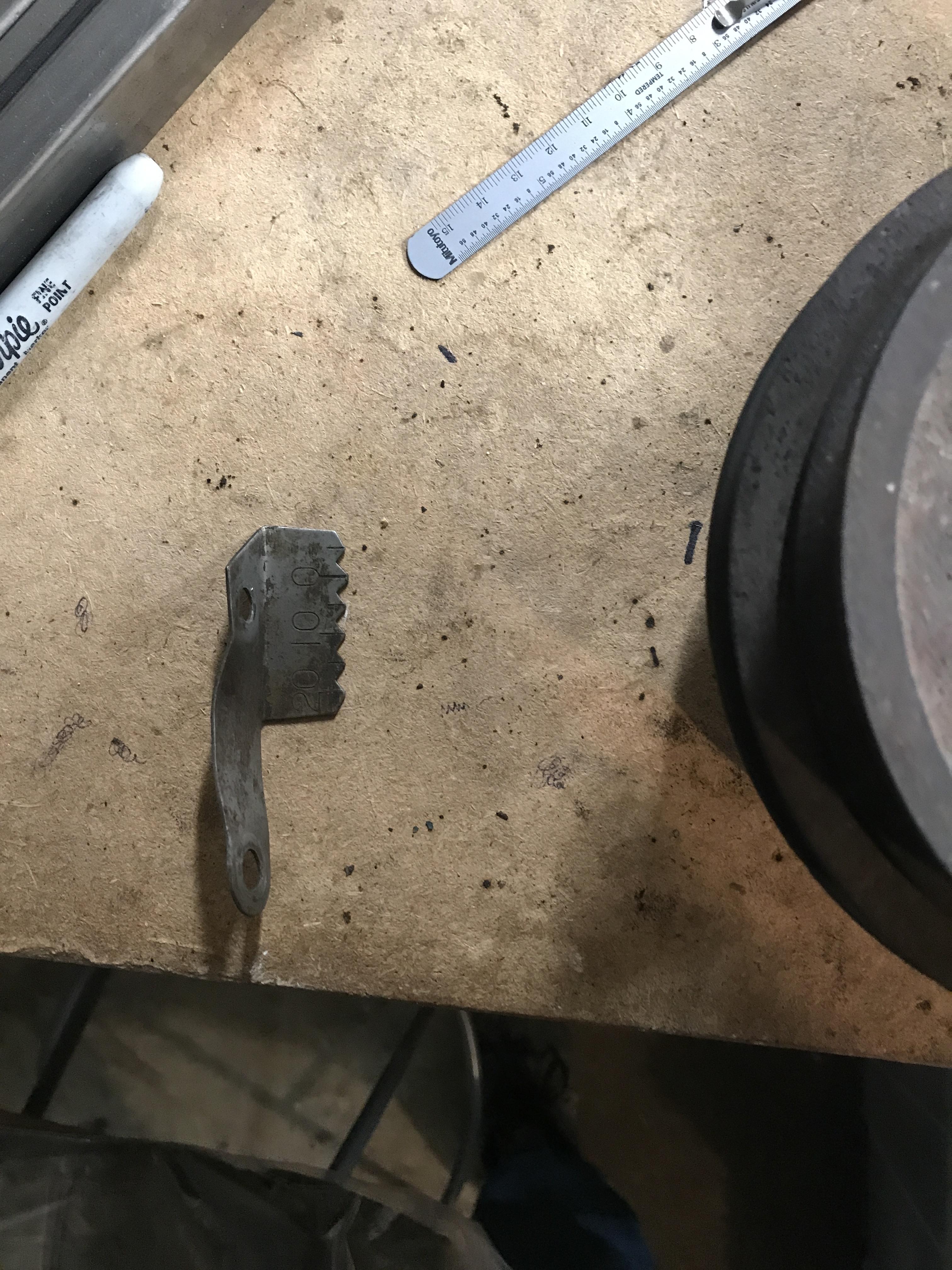

Check the timing notch on the damper.  Early 240Z's had several, 280Z's have one.  And they might be on the wrong sides.  Make sure new matches old or you won't be able to set your ignition timing.
It will be lower in weight, there is a large difference in size, and with it, the rotating mass. I use the small single groove balancers on my race engines, to reduce the total rotating mass. when building engines, all the rotating parts should be balanced as a unit, but for street use changing a pulley 'shouldn't' be an issue.
Just be mindful when winding it up tight, and note if there are any vibrations that weren't there before.

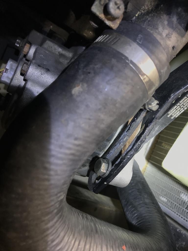

Looks like the balancer swap fixed the noise from the front of the car. It looks like there is a slight offset between the alternator pully and fan pully / crank pully. I think the belt is too long for the smaller diameter of the new pully, its almost at the end of the adjustment

For the belt, get one the next size smaller. Belts are designated by the overall length, usually in inches. The part number should have that length as a portion of the number.
When you mention the pulley offset, are you referring to alignment, as viewed at right angle to the crankshaft centerline? If so, they should line up. Use a straight edge to check.
