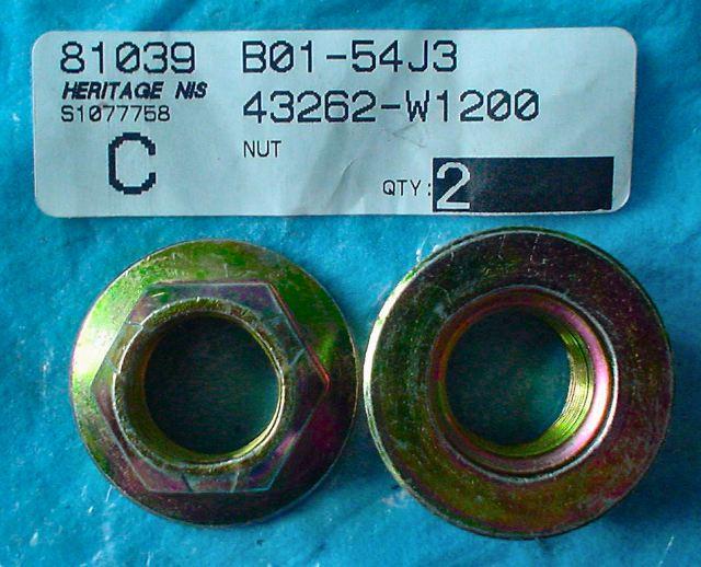

Many people (including myself) have switched over to the ZX style nuts for the stub axles. Photo courtesy of Blue:

Is there any change in the fitment process, are the final torque figures the same as 240 or 280zx FSM?
As for the fitment, the only change I can come up with is that you don't need to stake those ZX nuts after installation. The prevailing torque distorted threads do that for you.
As for the torque, I'm no expert, but I would just torque them to the same torque as the original spec for the Z. You would lose a tiny bit of the torque number due to the friction of the distorted threads, but I bet it's such a small percentage of the total that it wouldn't be significant.
I've got a ZX manual around here somewhere. When I get a chance, I'll dig up the torque spec they used in there.
Don't overlook that the torque range is wide (probably) because it's an adjustment range.  Torque to the minimum number then measure end play and preload.  If it's not right go a little tighter.  If you get all the way to 239 and things still aren't right there's probably a problem.
