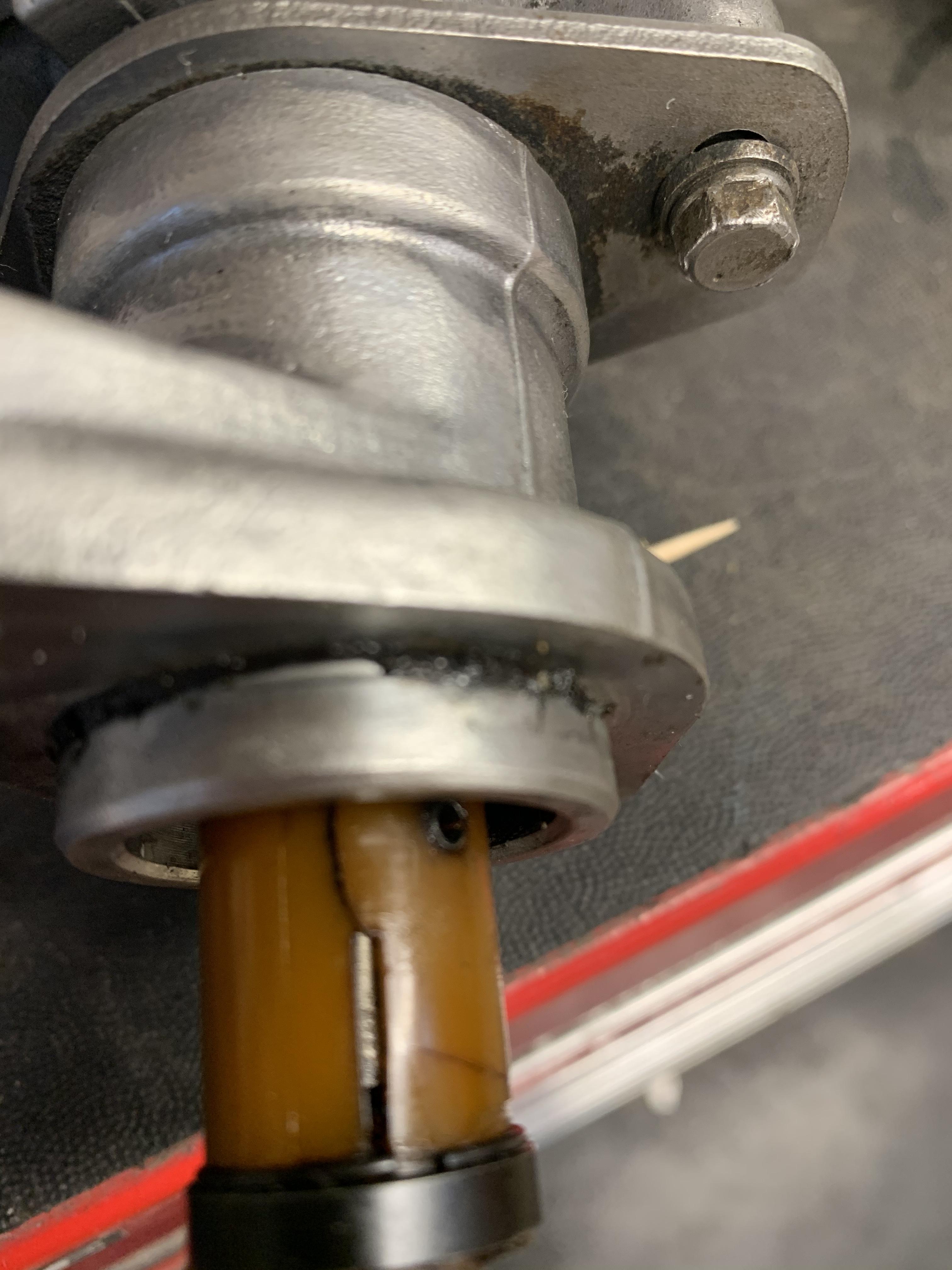

E-12-80 distributor plastic pieces
I am pretty sure that the metal one will swap right over.  I remember messing around with a bunch of parts and realizing that Nissan had done some cost-cutting.
Looks like it's called a set collar.  It just sets and spins.
http://www.carpartsmanual.com/datsun/Z-1969-1978/electrical/distributor/280z/12
Yes, you should have no problems. If you bought a rebuilt cardone distributor it comes with a metal collar. I rebuilt two old ZX distributors last summer and one had a plastic collar and the other a metal one. They both fit fine.
That part affects is the axial end play of the distributor shaft in the housing. If you switch over to a different piece (whether that is plastic or metal), you should check the end play and adjust the gap filling washers accordingly if necessary.
