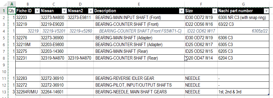

I have been putting a list together of gearbox bearings I could need (for FS5C71B). It looks like the FS5W71B, FS5C71B and FS5C71A and the F4W71B all share nearly all the same Nissan part numbers give or take (e.g. 4 speed no bearings on overdrive). My question, or point me in the direction of a previous post, is what are the part numbers for the bearing in there generic form, eg. Timken 6205? There are a few gearbox rebuild threads, but I haven't seen any bearing info.

I have the part numbers for the bearings in a spreadsheet somewhere

Thanks both. Yes, totally aware the synchros (servo and Warner) and associated bits don't interchange. Just in a fog of parts for what I had looked at so far (as most on-line info covers the Warner synchro box), and needed some help seeing the end of the tunnel.
Already have the synchro rings which is the getting harder parts to find.
