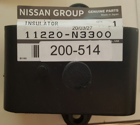

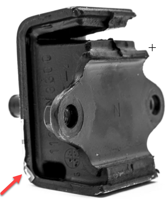

Hmmm...I'm not sure.  These are OEM though, in the first picture you can just see the corner of the Nissan logo on the sticker (red arrow) and the second picture I just took of one of the ones I received from them a couple months ago.

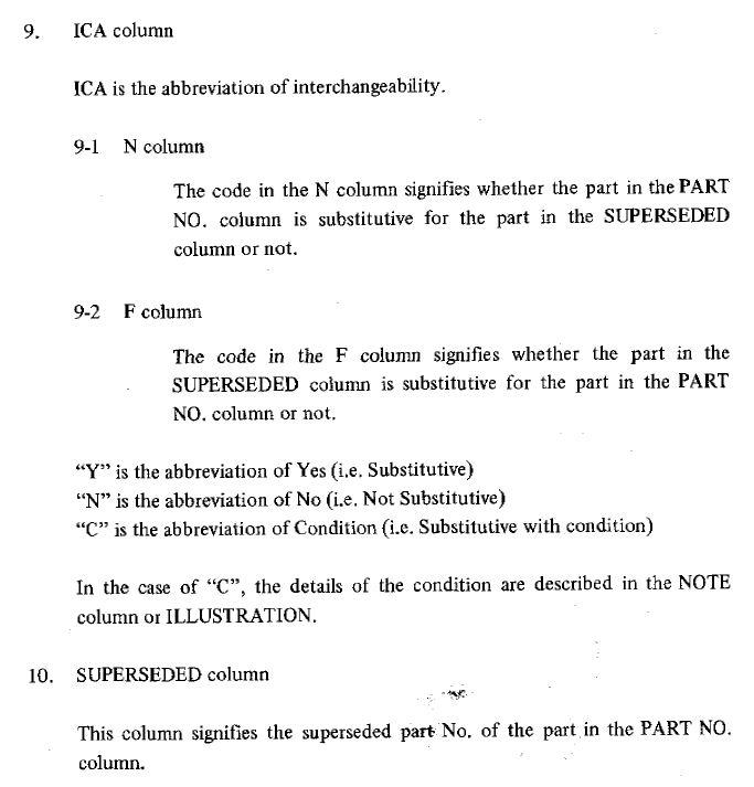

The "N" in the ICA columns means not interchangeable. Here is an explanation of the columns from the Datsun 521 pickup parts book.
