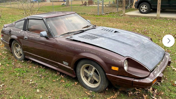

Shipping might be costly from North Alabama but here's the whole car for $4,000. I know the turbo's use a specific ECU so make sure you get that when you do find one. Good luck.
https://www.facebook.com/marketplace/item/997590577430996/?ref=search&referral_code=undefined
Looks like it could be driven.  Edit - actually the words say that.  It looks like it's ready for the wrecking yard.
1983 Datsun 280zx Turbo. Car runs well and transmission shifts perfect. It has had some aftermarket parts installed like blow off valve, turbo timer and valve controller. Would be great to fix up as it is an all original car. Has usual rust from being parked for years before I purchased it. Has a clean title. Looking to sale cash only no PayPal!
