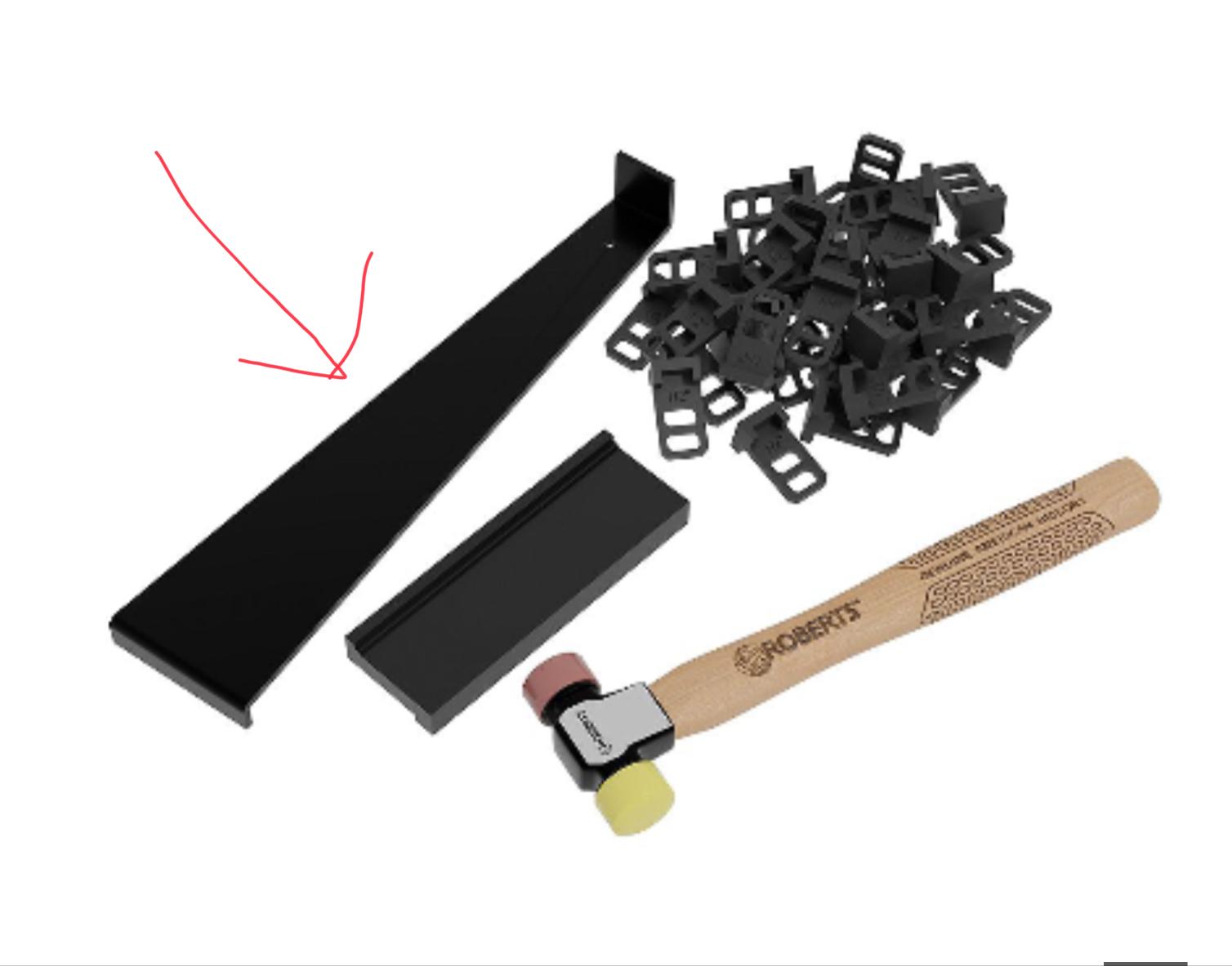

I tried using a flooring tool called a Z bar (how appropriate!) that lets you hook the edge and tap well out to the side of the car. The one I have is too wide, (1.5” ish) all I’d have to do is make it narrower
