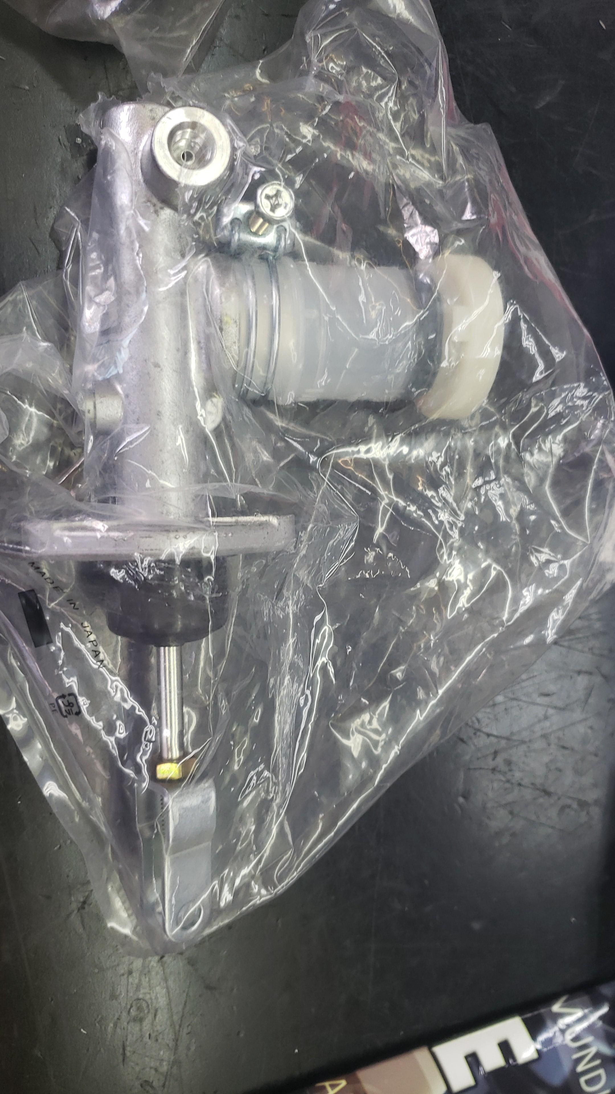

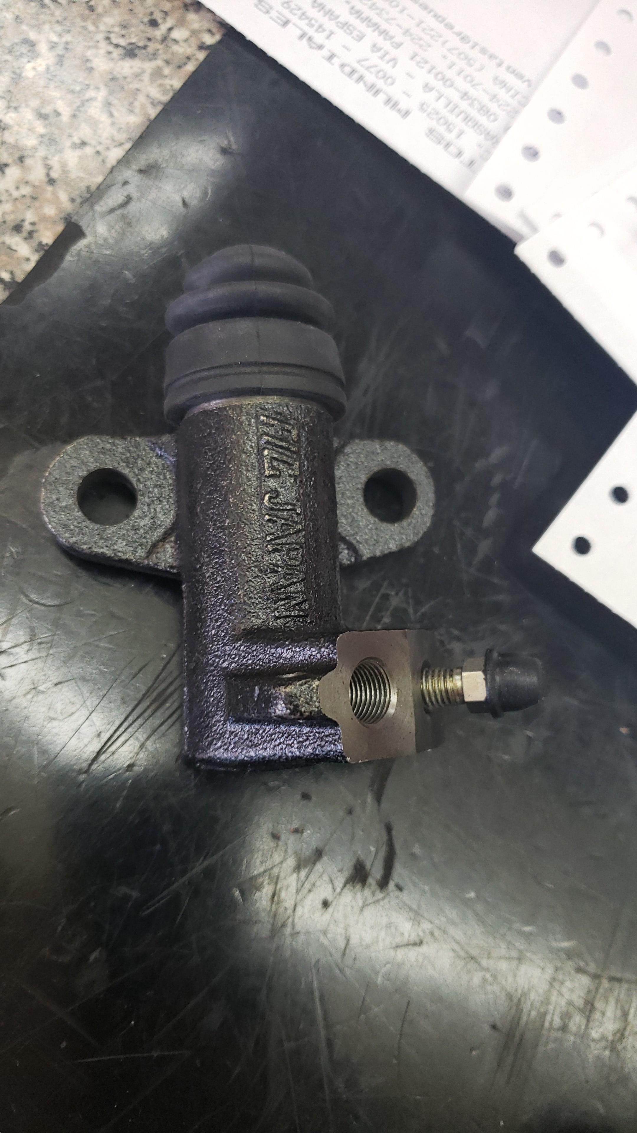

Clutch pedal goes to the floor with no resistance, canmot engage 1st gear
Its not about cost. Its about local availability. I paid 21 for this master clutch and 15 for the slave. I hope it lasts a couple of years. I only use this car on sundays.
