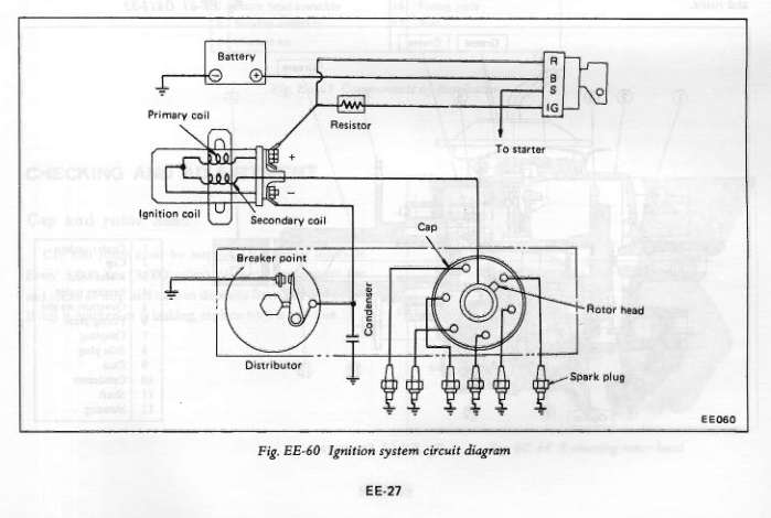

Thats a failing resistor in your ignition circuit.. for a test you may shortcircuit the resistor you find near your coil..  I bet you it will stay on!
Get yourself a new resistor, or repair the failing contact on the old one!
It could also be the ignition switch itself. This is why you need to own and know how to use a voltmeter. Check the voltage at the ballast resistor with the key in the ON position. One side should have voltage. Heck, even a test light would work for this.
I forgot to mention that I bought an aftermarket switch from Zcardepot but I’ll give it a try. Thanks again.

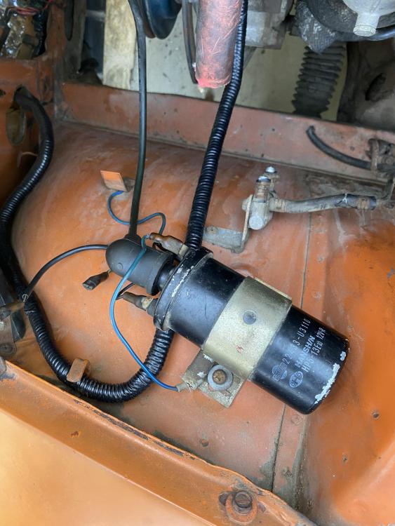

After a quick search of ballast resistor online I see the problem. I don’t have one.
