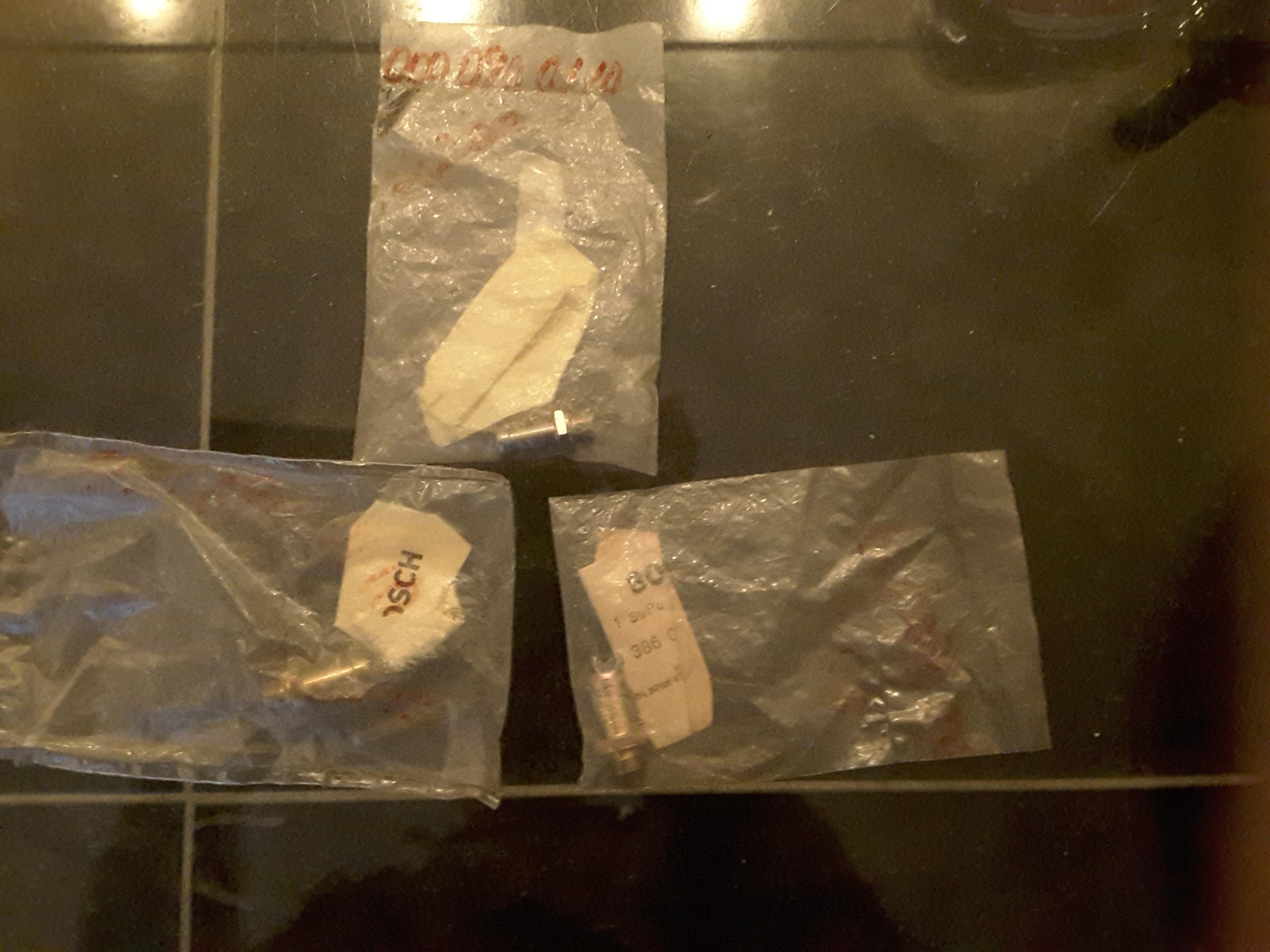

So finally the actual helpful bit, I have at least three check valves on these pumps that available to who ever needs one...

On 3/2/2021 at 1:04 PM, EuroDat said:
Jeff, That is the later version.
They should look like these. I did have five. One is in my car and the other I gave to (Sarah) Fastwoman almost five years ago.
Ill send you a pm.

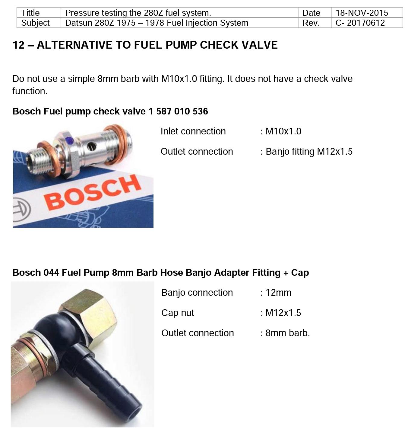

Hi Jeff,
You can try an alternative check valve for the Bosch 044 pumps. Bosch 1 587 010 536 is a banjo type fitting with built in check valve and stil, easy to find on the internet. Be carefull not to buy the M12x1.5 fitting. You need the M10x1.0 fitting.
