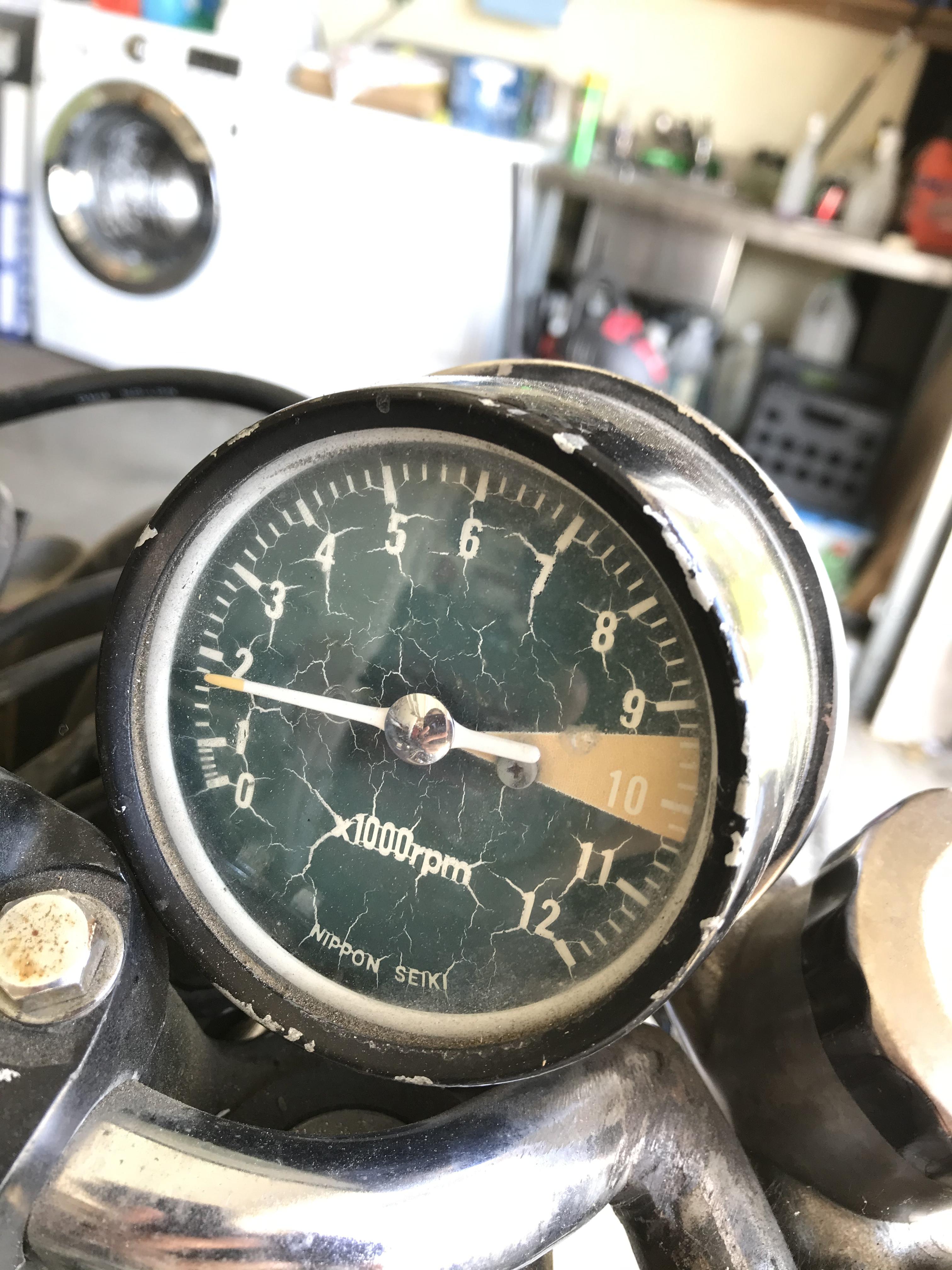

Ah the bike, I got it a little closer yesterday, I was able to get some what of an idle, but I found that the battery died while I was running it, so I started digging into the alternator circuit and found two questionable wires that I replaced. The next issue is the tachometer, which need to be fixed because it’s “zeroed” at 1900 RPM, I can’t really tune it because I can’t see where is is. Parts have been ordered, so back to the Z while we wait

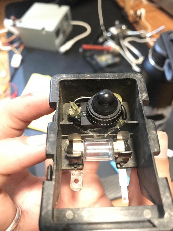

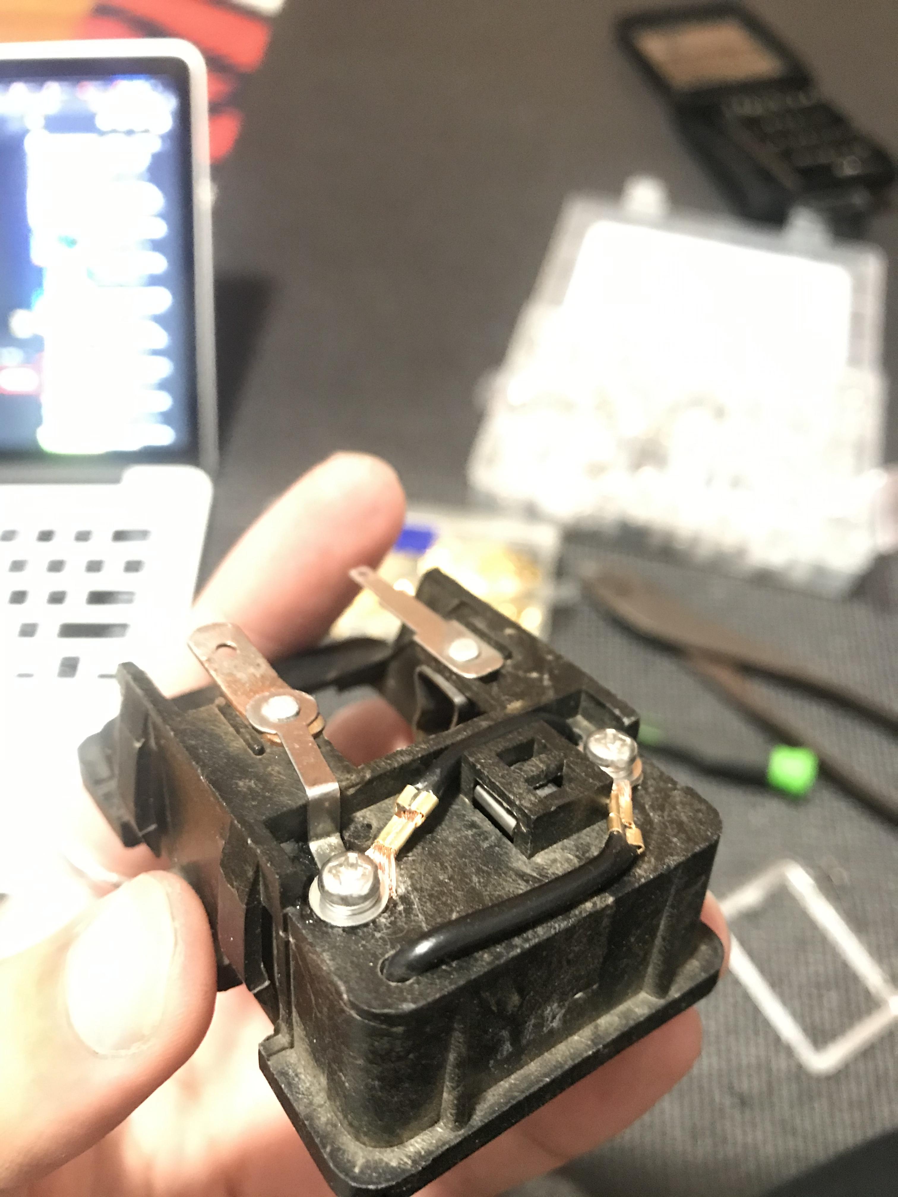

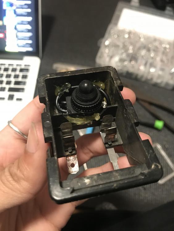

The replacement dome switch is here. I attempted to install it and it works well. There is an issue that I can foresee which is how loose the white plastic is inside the body, but I’m not sure how loose they are from factory. It might rattle around when driving. Also the copper wires from the switch can’t be soldered to the aluminum parts of the body. Maybe some type of glue can be used? Or a copper rivet?

The original switch button contacts the lens at all times which helps squelch rattles. It sounds like your new switch's push button (even with the rubber seal installed) is shorter than the original button. Maybe you could put a small rubber button in between the two to take up the gap.
And about the soldering... I'm sure it's not aluminum. Not sure what it IS, but it's NOT aluminum. Either nickel plated brass (which should accept solder easily), or steel (either chrome plated or stainless). Are the metal parts magnetic? I think I've got a dome lamp around here that was damaged. I don't remember what "damaged" means though. I'll have to see if I can find that thing.

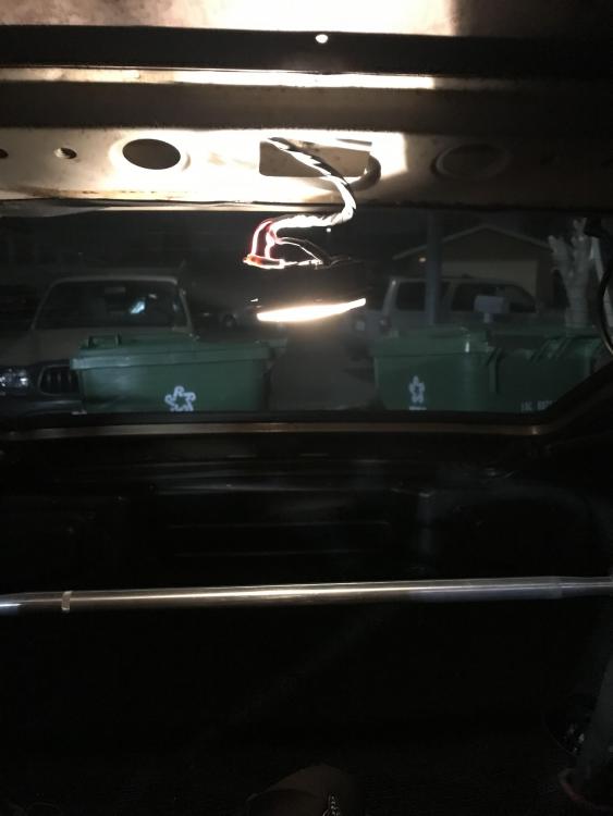

I used 3mm hardware and some eye terminals to make contact with the “plated” material. I also added the rubber washer that came with the switch and it’s pretty snug now. Tested it out in the car and it works. Just waiting on the LEDs. I went back and added some heat shrink near the terminals just for safety.
Keihin carbs on this cb500 actually. It’s not too bad to work on. Dialing in the SU kinda taught me how they work, at least how to approach it. Need more stuff to tinker with, this project was supposed to take longer.
Dome light looks good. Hope you like the LED when it comes in.

Thank you for the link. The eBay link is dead. Seems a waste too buy 5, but considering the $$$ pricing for a new lamp, $10 for a switch ain't so bad. I did find a listing for 2 for $8, but 5 for 10 is such a better deal 🤪 I'll have to find other uses for the extras.
I guess this is a fairly common failure. With the attention to detail & Japanese desire for precision I'm kinda surprised. I can't imagine it was used that often. I was going to disassemble the switch & clean up the contacts, but that doesn't seem worth the time.

I searched for "water proof push button switch", I ruined one of the 5 when I was fixing this, so might be nice to have a few spare...

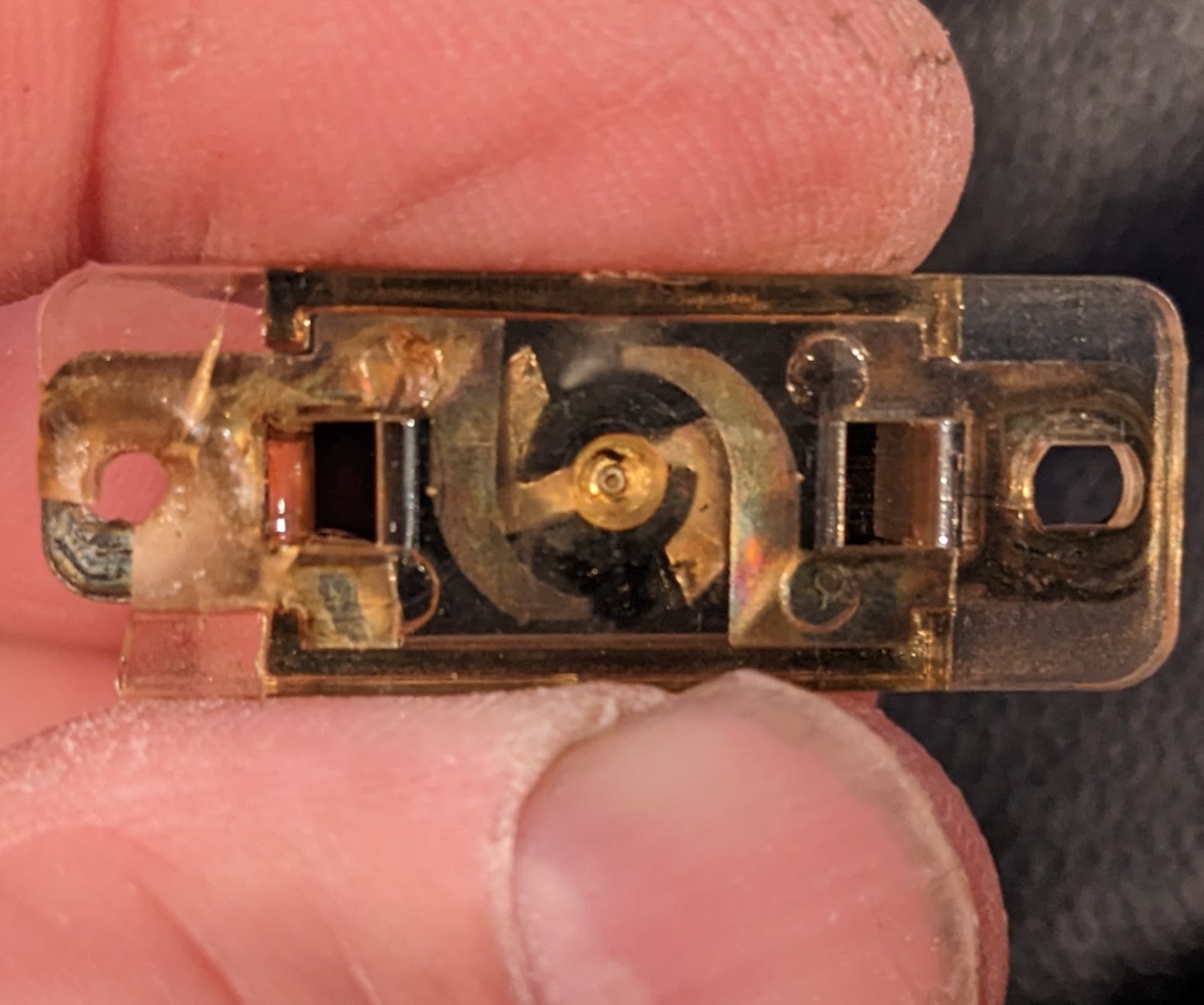

Its pretty hard to open the OEM switch without the plastics breaking, I find it to be too brittle, there is a spring and some sort of rotating dial/mechanism in there. I would be surprised if they can be repaired... I guess its a switch, thin metal, when it weathers and builds resistance its going to heat up and melt.

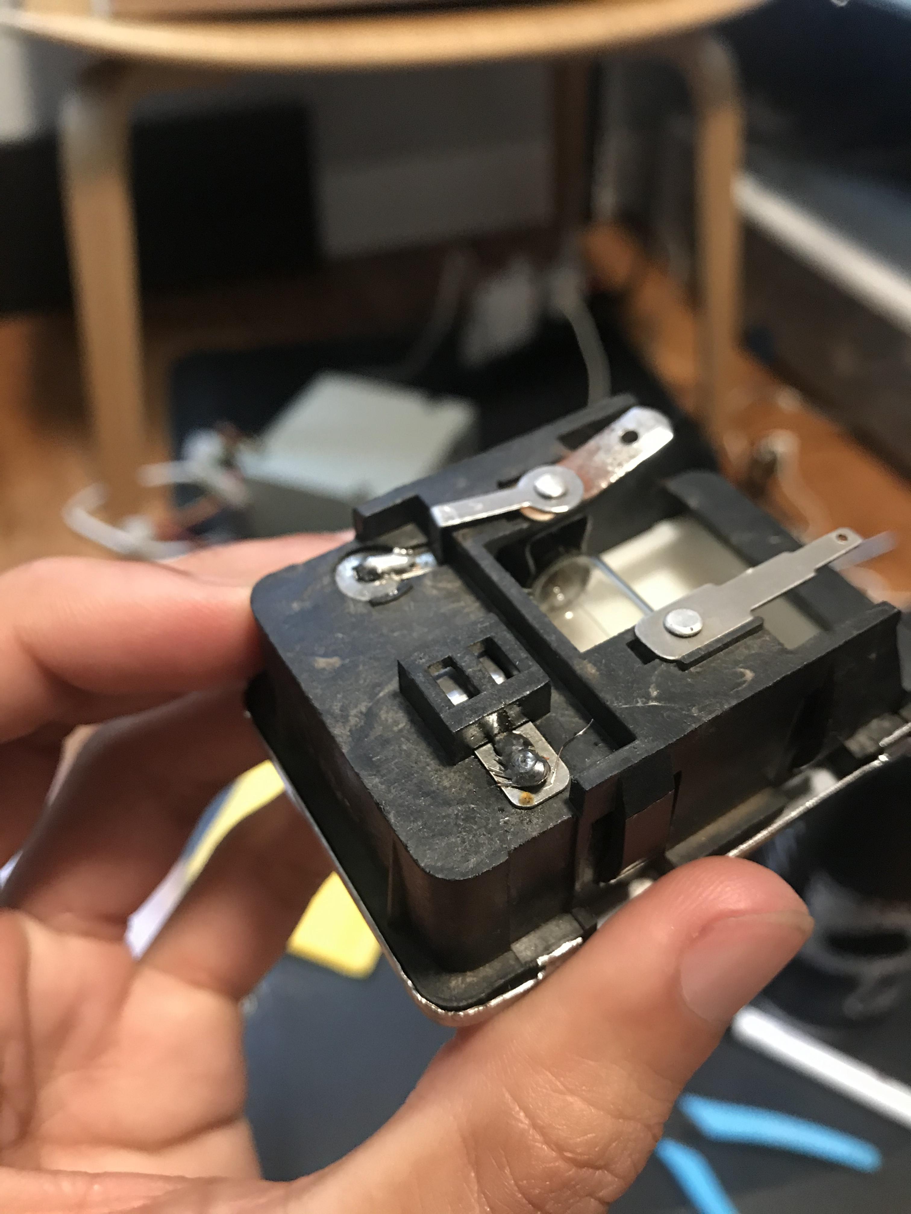

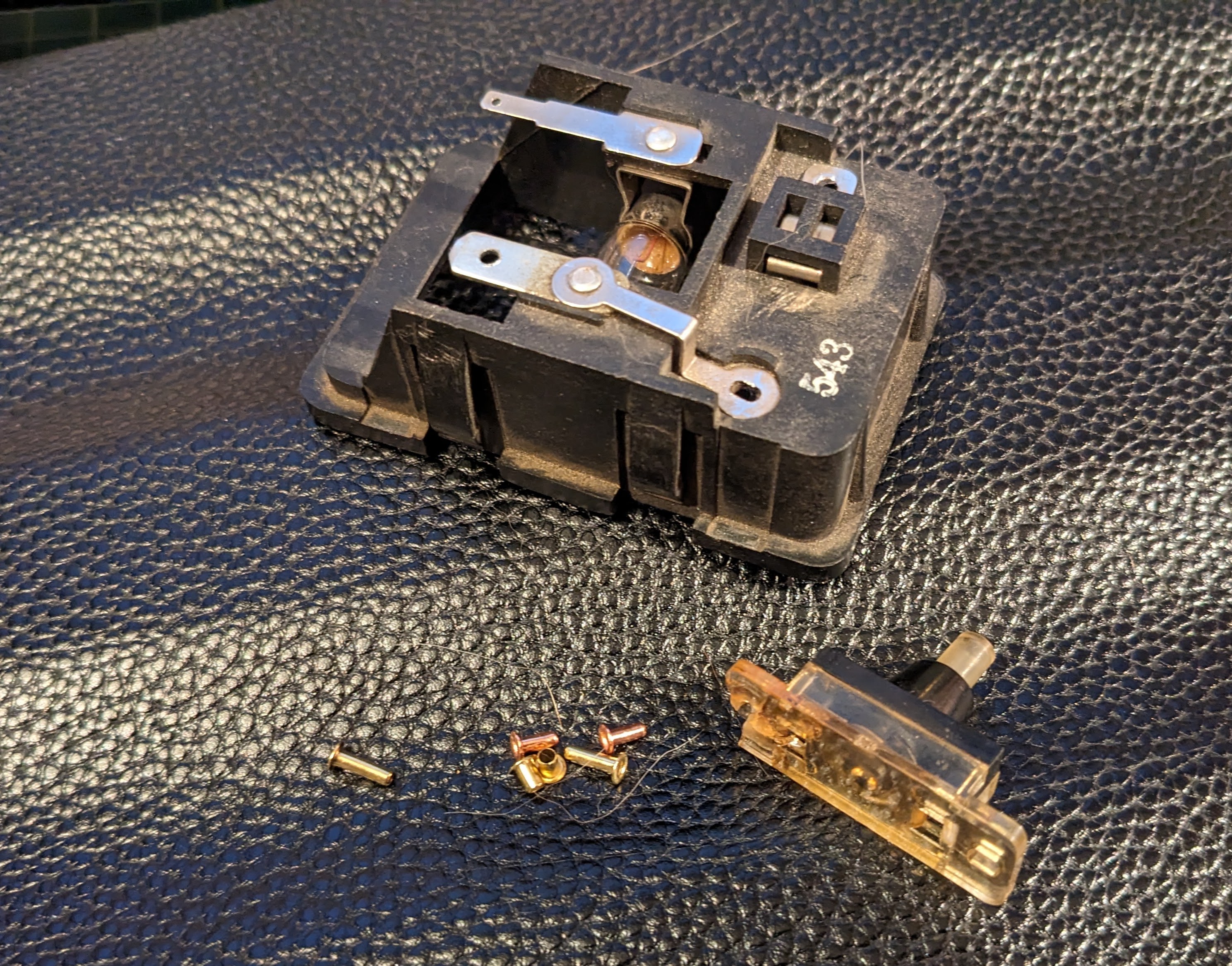

I removed the switch by drilling out the rivets. Looks like the contacts thru the rivets were bad. There was discoloration on both conductor tabs. I have to retest the switch with the cleaned contacts
aluminum rivets
contact design - open
contacts closed
if the continuity is good with the cleaned contact area I'll use brass screws instead of aluminum rivets
