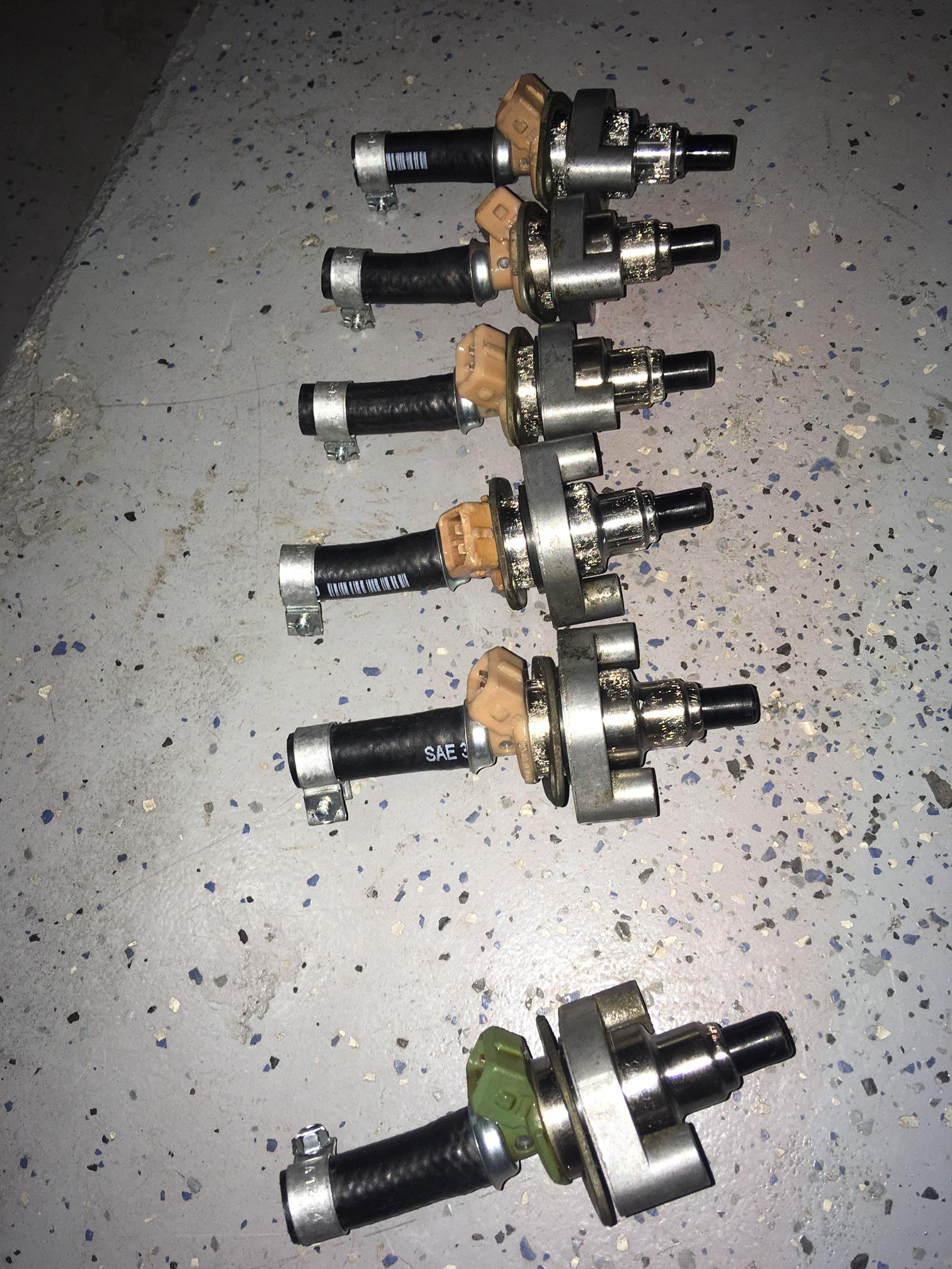

Well this is interesting, I bought replacement injectors since I'm sure they've never been changed and Rock Auto sent me brown-top 280zx turbo injectors.  Since those flow more I'm guessing I'll need to retune the car right?

I was sent 5 tan and 1 green injector from Rock Auto.  Besides being annoying, since it seems that the tan is the earlier year's 280 color and the green being later they should all be the same spec right and would be ok to mix/match (http://www.atlanticz.ca/zclub/techtips/injectors/index.html)?  The injector hole on the bottom of both are the same size so that should indicate the same flow rate, right?
Well regardless if they flow the same, that's pretty annoying. The color may not matter, but on my engine, I would want everything to at least match.
So I have no idea if the size of the opening on the bottom is the only thing that would affect the flow rate. I kinda doubt it. I suspect there are other internal geometry areas which could affect the flow rate too. In other words... Just because the hole in the bottom is the same, I wouldn't assume they flow the same.

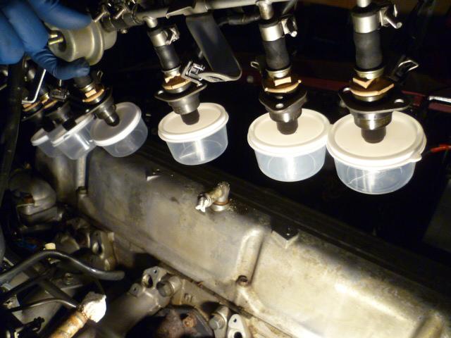

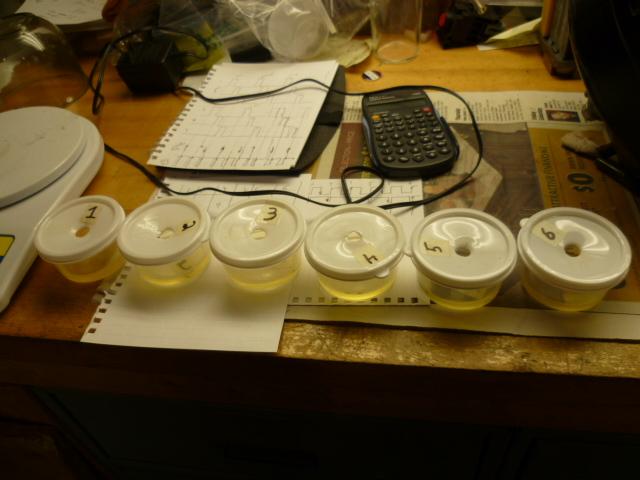

You could test them to compare the rates:

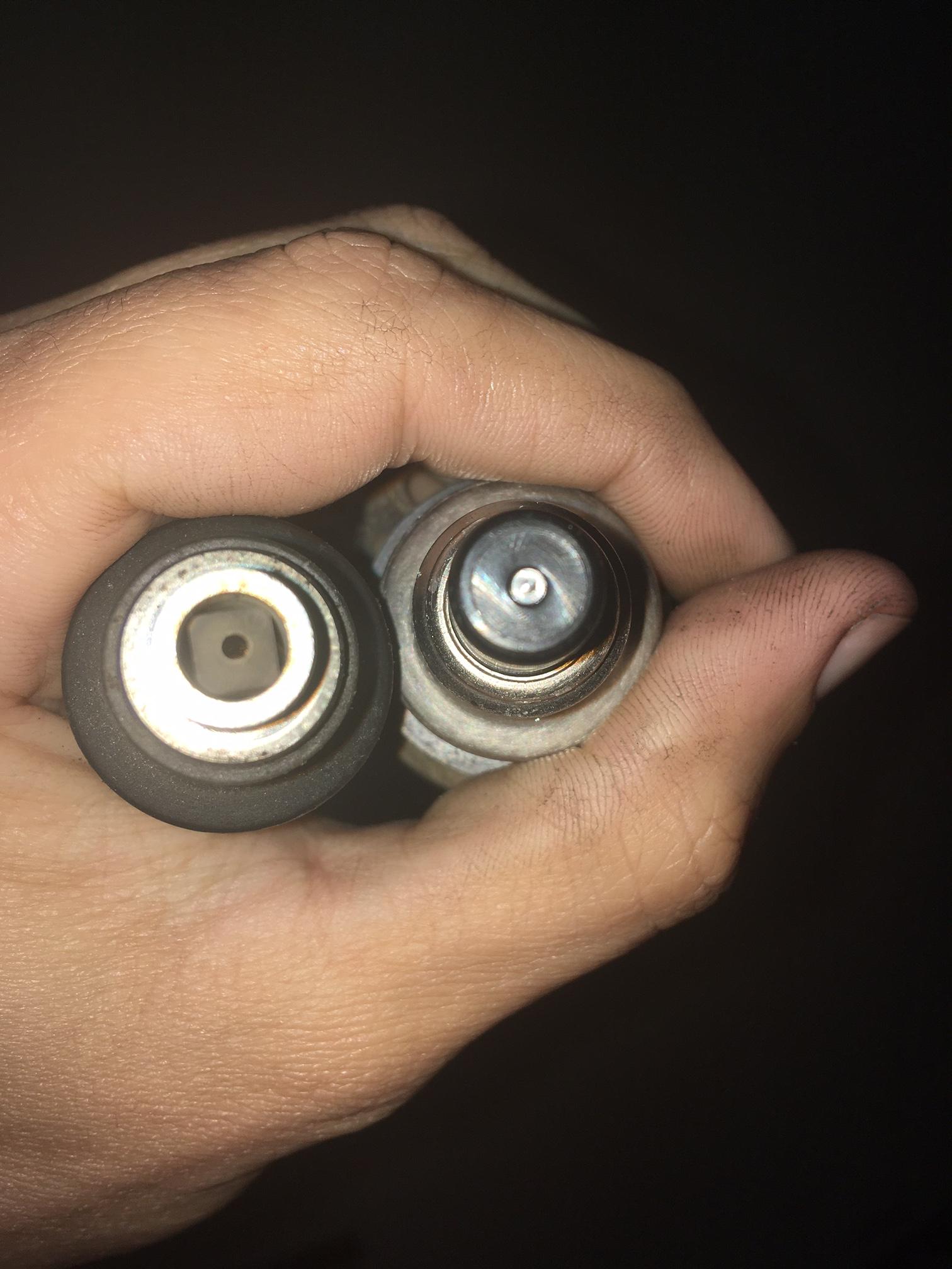

Good point about them matching regardless of flow rate.  I just took a look at the bottoms to compare what was on there (left) and the Bosch ones I bought (right) and they look way different.  Are the ones that were on there for the turbo or just some weird reproduction maybe?
Effective fuel hole diameter  in carbs and fuel pressure determine fuel flow. I think it is the same for injectors.
Fuel pressure in injectors is relative to manifold air pressure rather than absolute air pressure otherwise  a negative pressure in the manifold would combine to  "suck extra fuel".
