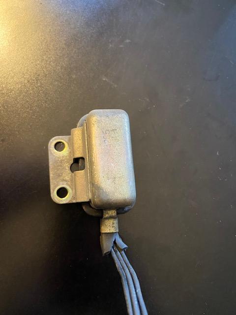

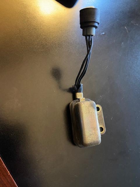

Looking for some assistance on identifying this part under the hood of my 1977 280z. It mounts on the same bracket as the voltage regulator on the driver side wheel well.. The original fault was my door buzzer stayed on constant. Then heard a strange hum under the hood. Tracked it down to this guy. Tapped lightly with a hammer and it fixed it for short period of time. It continues to be an issue so need to replace. No cue what this is?!?!?! LOL!  Thanks for any help!!!

Zcarsource.com looks like they have them but they want a lot of money for them. And they are used!
Check to see if it can be taken apart. Could be a set of contacts that just need to be cleaned.
Assuming it is failing and not something else.
Edited by rcb280z

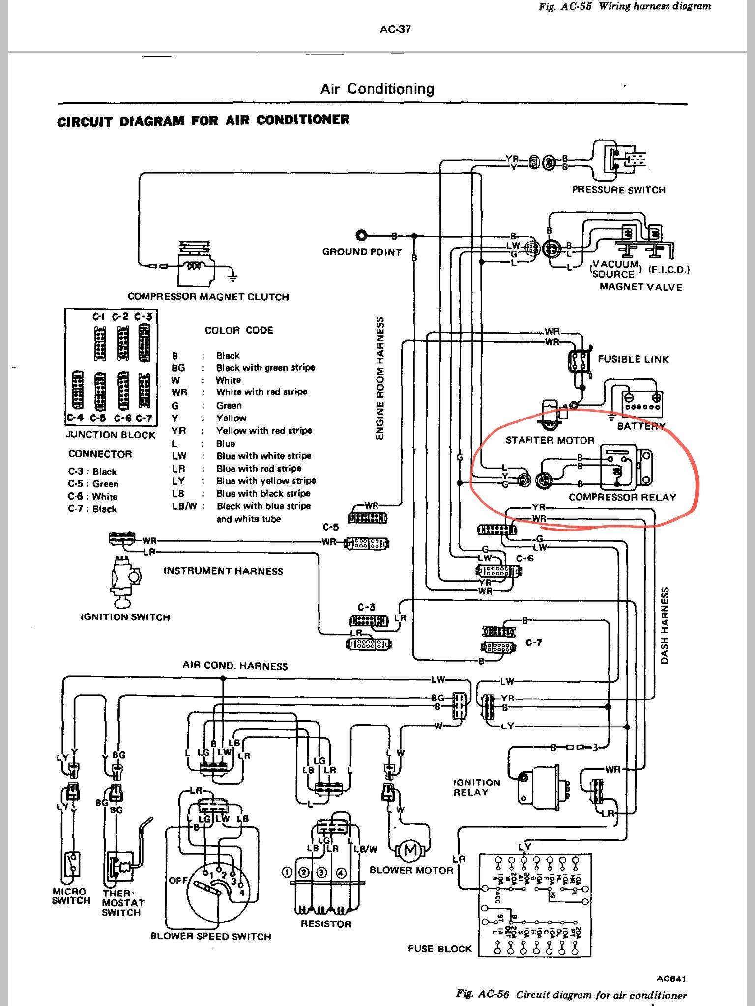

more info
Where on the car is it mounted. I frequent 280z’s in salvage yards all the time and next time I can take a look for you . It might be a 6-8 weeks before I go back. I’ll put it on my list but let me know if you buy one somewhere else.
If you are not concerned about keeping it original, than you can use any stanard relay.
The relay isceasy enough to test to see if it is working properly.
If you look for one in a junkyard, you will need the model 280Z up to August 77.
After August they changed the relay connector plug to a rectangular 4-pin connector. It does the same thing, but it has two power supply wires were the early version with round connector has one power wire and it is bridged to the relay coil internally. I hope that makes sense...
Update-  First... wanted to say thanks again to all that replied!!!  You steered me in the right direction! I decided to take it apart based on someone suggestion. It had a single contactor inside. I was able to clean the two contact points and seems to be working fine now. Dont you love 70's technology!!!!!  Seriously, thanks again to all! Jeff
