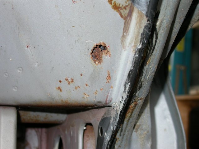

And possibly hard to find. I found about a one inch square rust hole on the passenger side of the cowl bucket, just in from the passenger door. Probably not able to be seen with the dash in. Looking from outside the car, the hole is WAY BACK in the corner of the cowl bucket, and I pulled a big chunk of sealing material out of that corner (that looked original, but came out really easy after 34 years). Thus, if you didn't try to get the sealant chunk out, and didn't remove the dash, a problem like this would have probably remained a mystery. See the attached picture from the inside of the car, about where you'd be sitting in the passenger seat (if there was still a seat there!).
