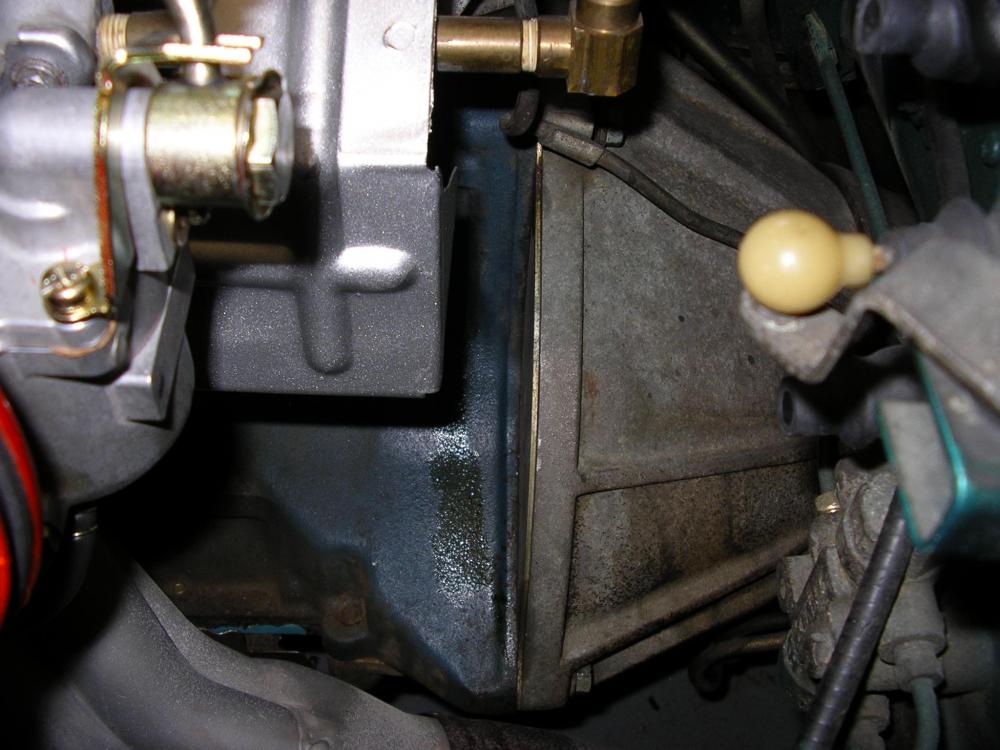

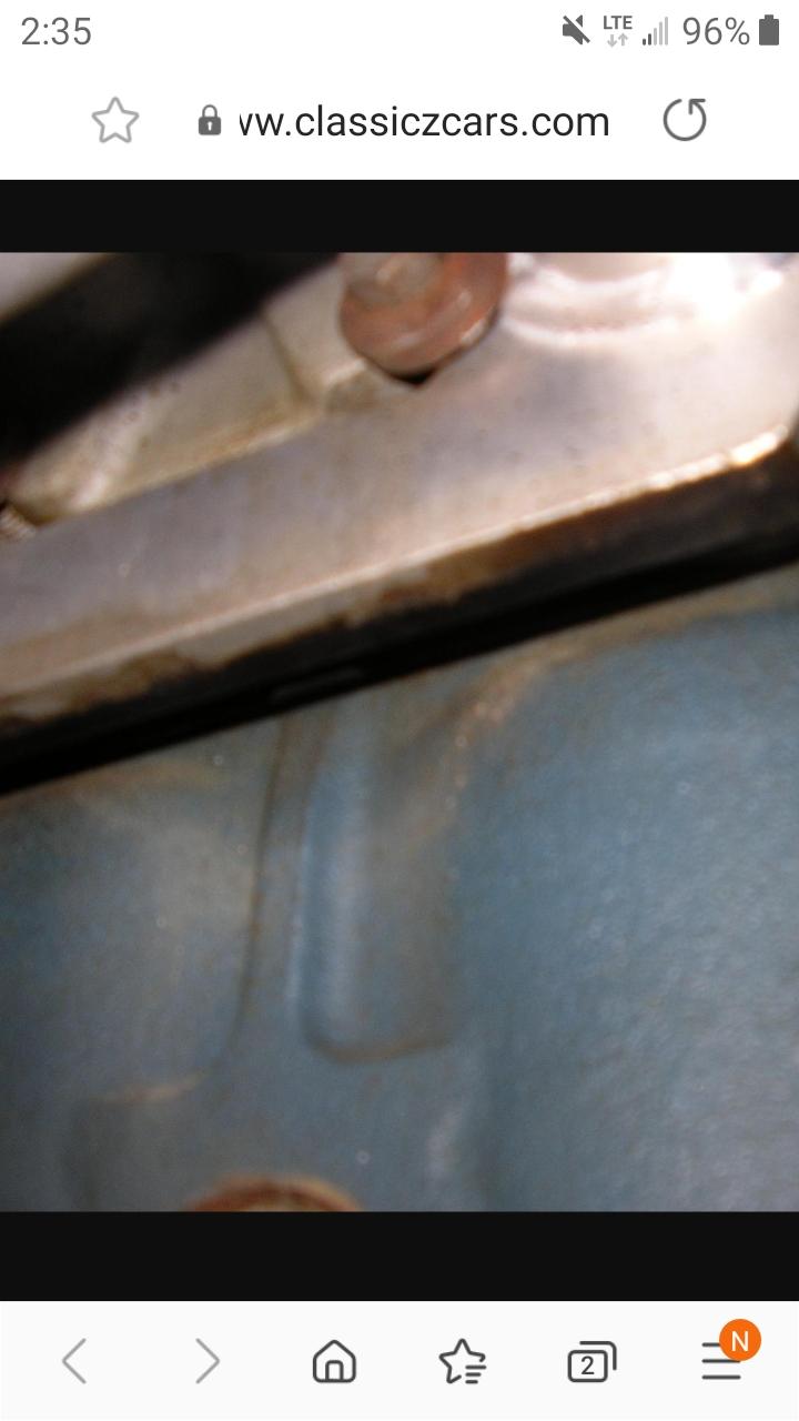

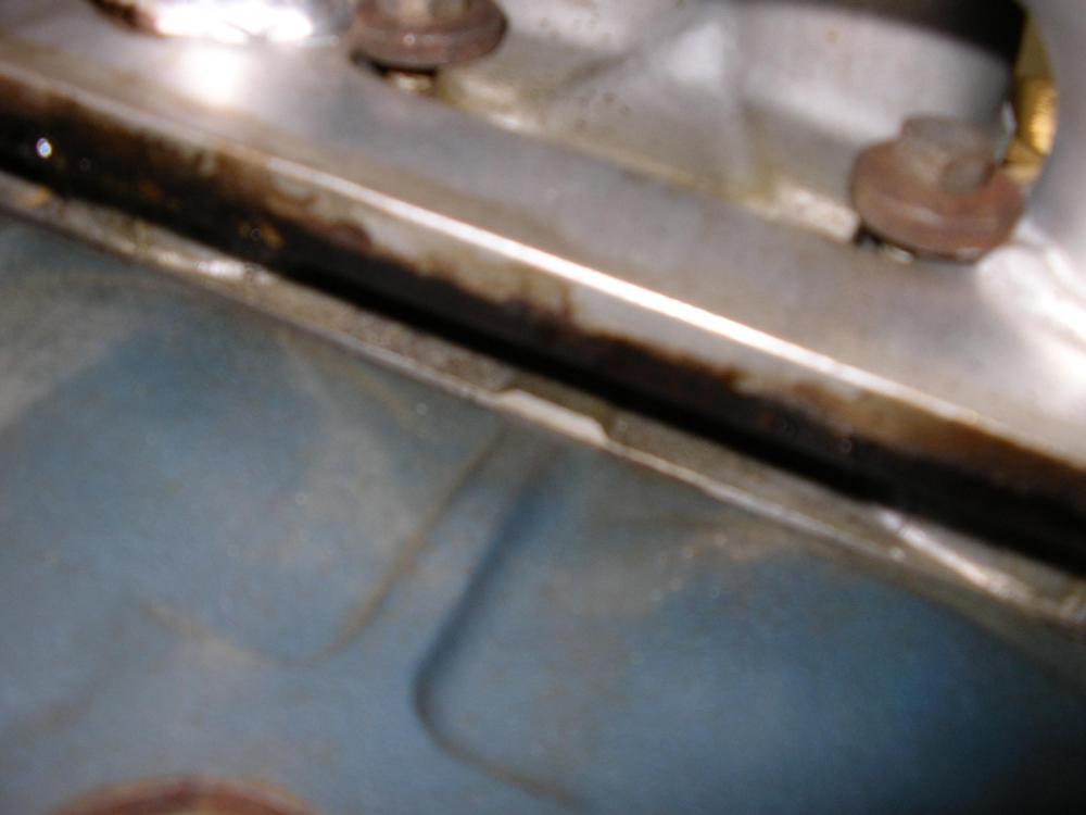

I now have a oil leak from the # 6 cylinder header bolt dripping down by the bell housing , it looks like the second bolt in on a n47 head is this just a bad gasket ? all spark plugs look great , when I assembled the motor 25 years ago I used the old hardware I did not know at the time about changing out the hardware . so I  now see msa auto sells the new hardware kit and gasket . I sprayed carb cleaner around the intake and have no rise in rpms . is it just a bad gasket and old hardware ? thanks for the help

no it is oil that is running down the side of the motor at the # 6 cylinder no a lot . when I wipe my finger under the header it is wet with oil . I sprayed carb cleaner all around the intake manifold with no change in rpms either . the cylinder head is not leaking as far as I can see and the motor runs and idles perfect . I drove it yesterday and at a stop light I thought I had auto start stop it was so smooth .  could it  be the bottom of the intake ? maybe bolts? I did use all the old hardware back in 1997, and at that time I had no idea that I was supposed to use all new hardware I guess for stretching ?  does any of these bolts go into any oil passages? I also did not use any bolt / threat sealer back then either.

I will check again on the valve cover but it looked dry , I will get a picture posted also thanks
