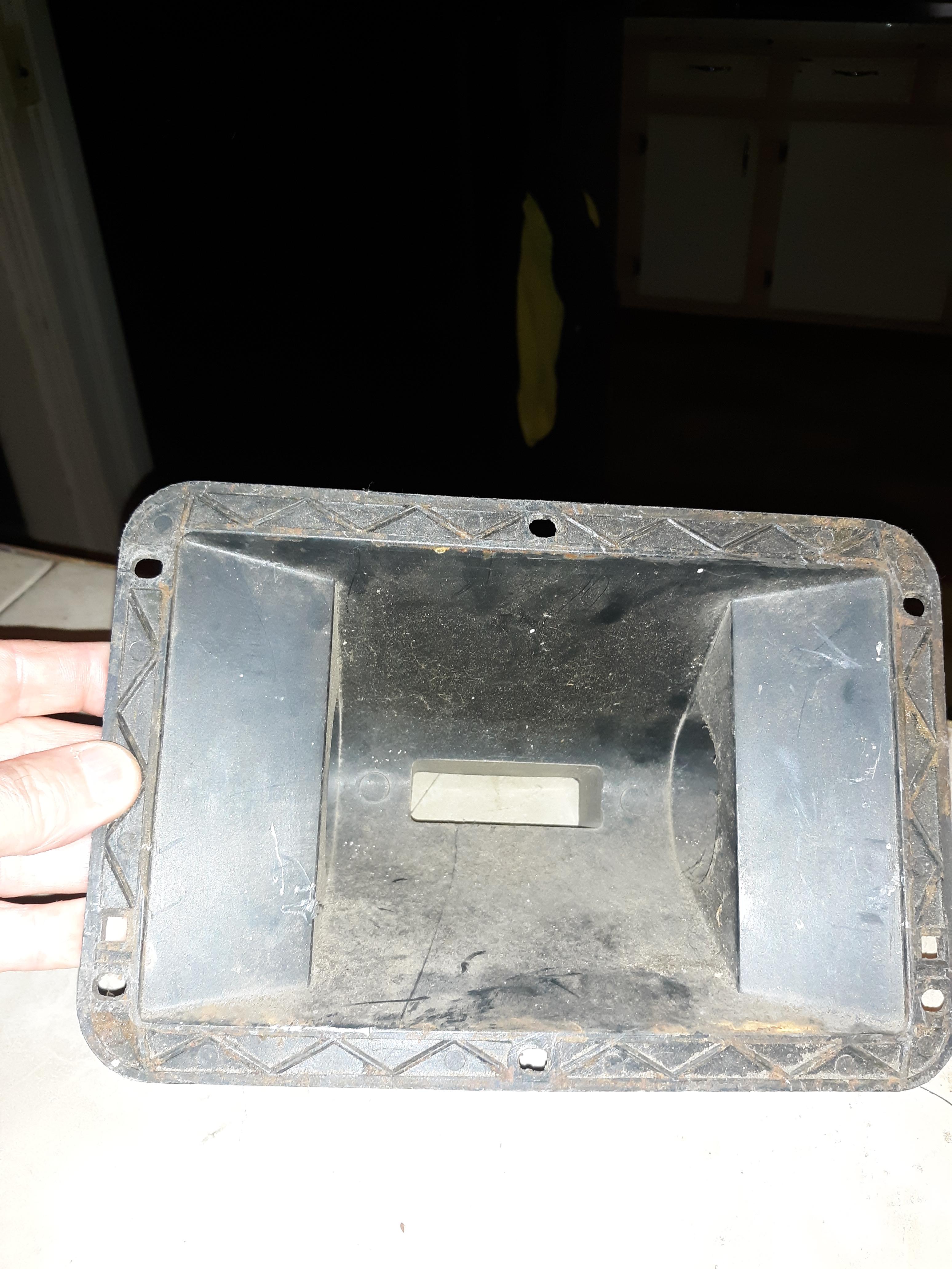

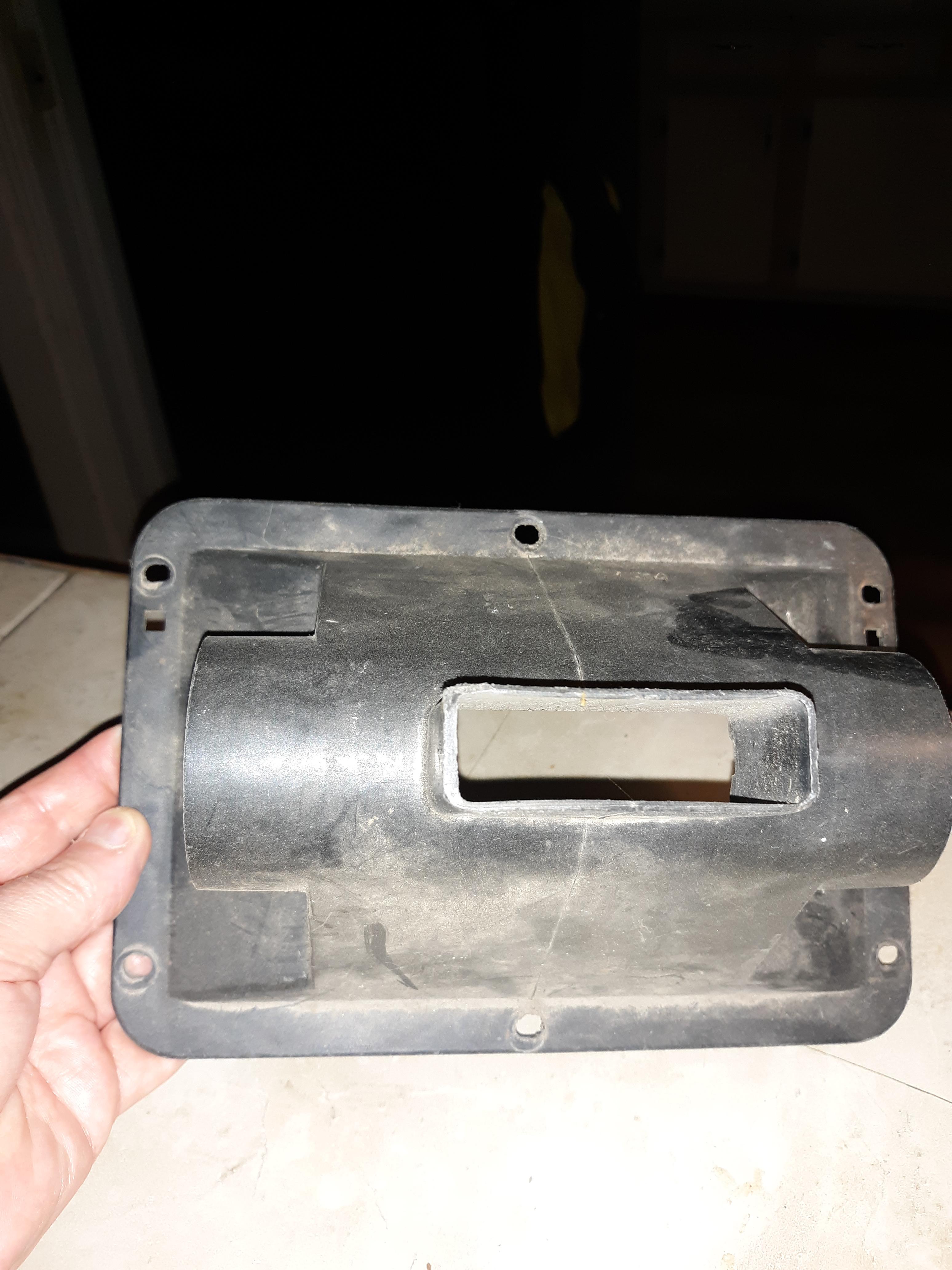

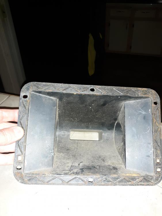

11 hours ago, siteunseen said:
Anyone know what this is? I found it recently in my storage building.

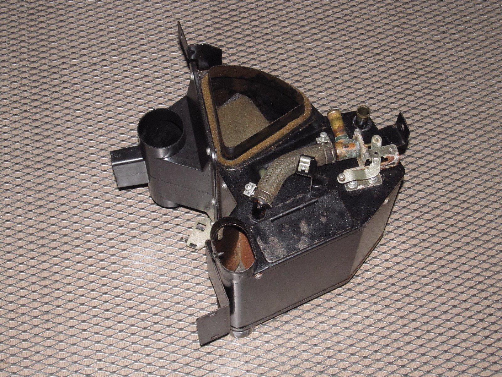

Its part of the front of the 240z heater box that sits behind the center dash vent that directs vent air forward and to the two eye ball vents on the ends of the dash. Doesn’t exist on a 74-78 260/280
and this would be why the 240z add on ac pretty much sucks. It puts the evap on the suck side of the blower and then has to direct air thru this tiny center vent duct. I remember my old 72 having that system, and it really was not very good as far as cooling.
