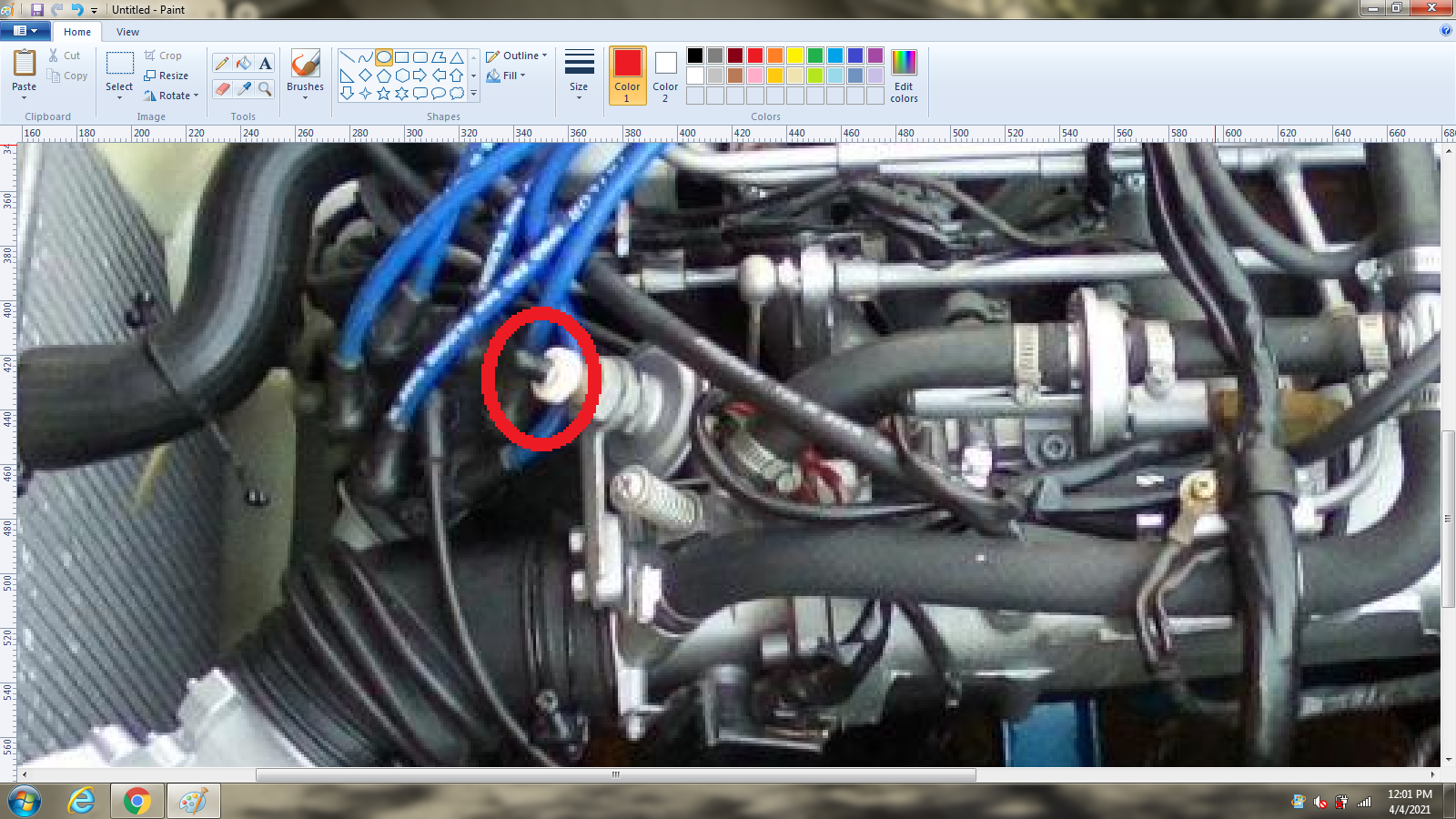

I haven't a clue about covering the hole on your throttle stop dash pot but I've always read it should be "open to the atmosphere"??? Anyway someone smarter will chime in and say.

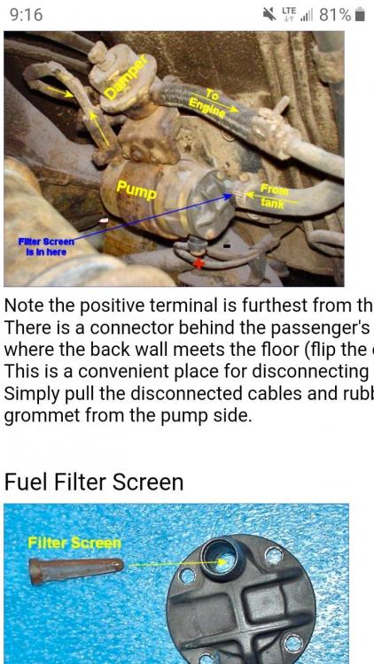

Hey Cliff, the throttle stop is currently open to atmosphere. I think the picture was taken while I was trouble shooting. Good eye, though! Putting in another fuel filter is not a bad idea. I read somewhere on the forum there's also a screen type filter in the pump that should be checked. I've wondered about the internal condition of the tank. I'll revisit the coolant sensor as well. I replaced that and the thermotime in the Fall but I've questioned the wiring and connections. Thanks for the links. I'll check them out. Happy Easter, Craig
