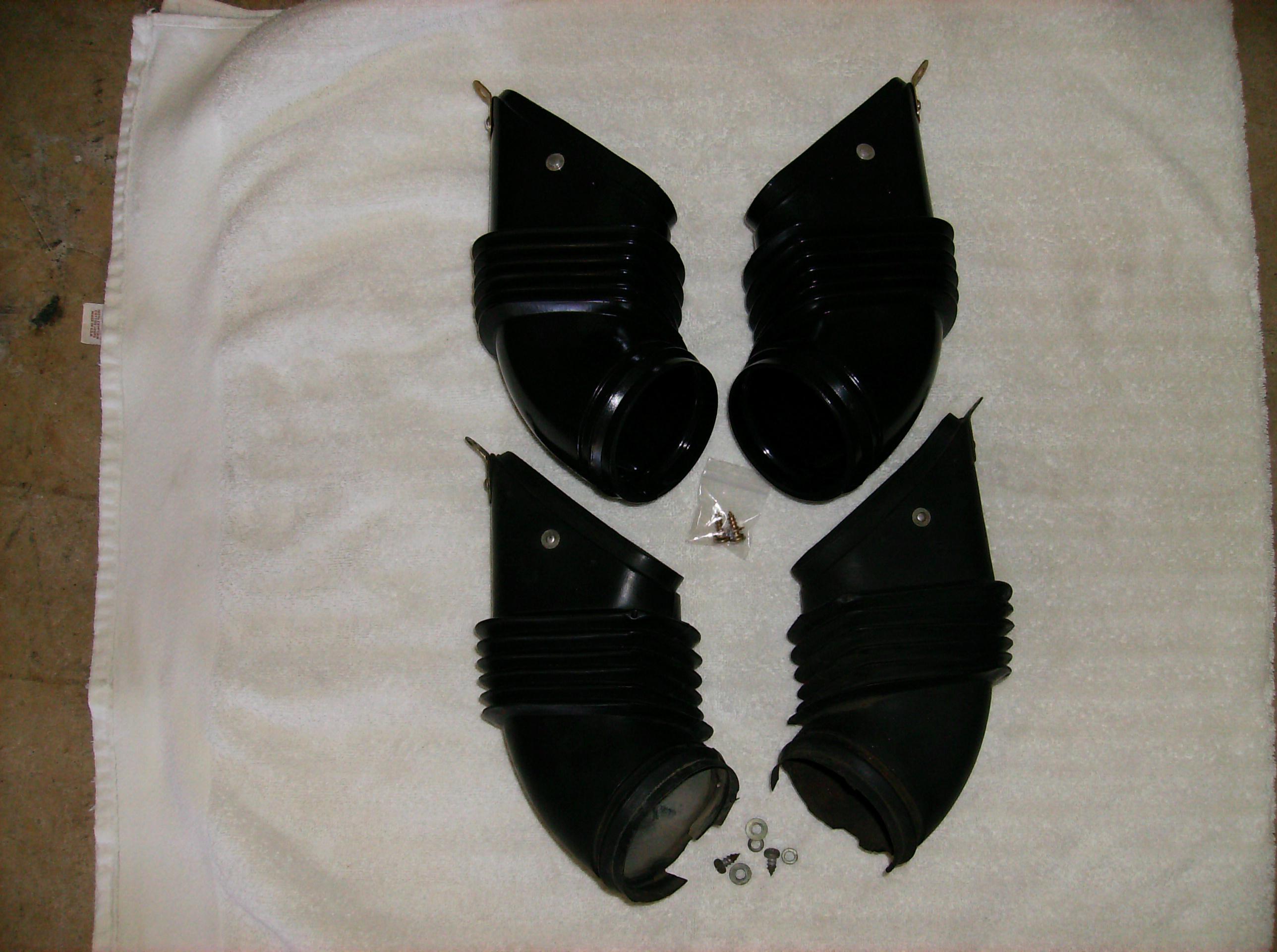

I was wondering if there are some alternatives to the OEM air ducting that goes from the radiator section into the body cavity. I was thinking that a 3” brake duct tube might work, it would just be a matter of figuring out some mounts for the chassis.
anyone do this before? Or have a set for sale 😐.

I’ve seen those; $200 is so expensive for that piece. 😔
i saw this online, but the mounting still has me a bit confused, it looks like a 3” duct can be used.
