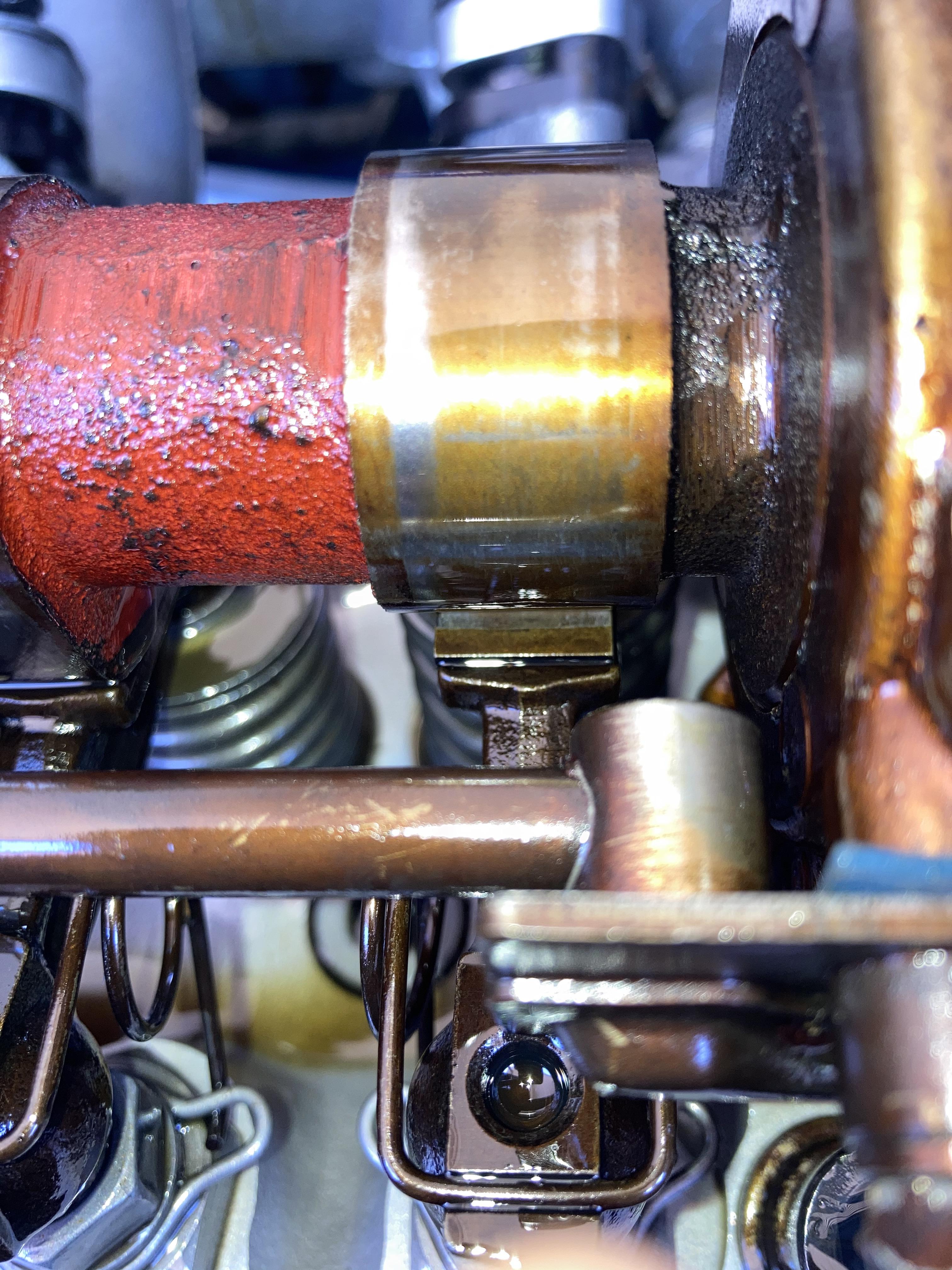

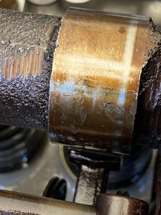

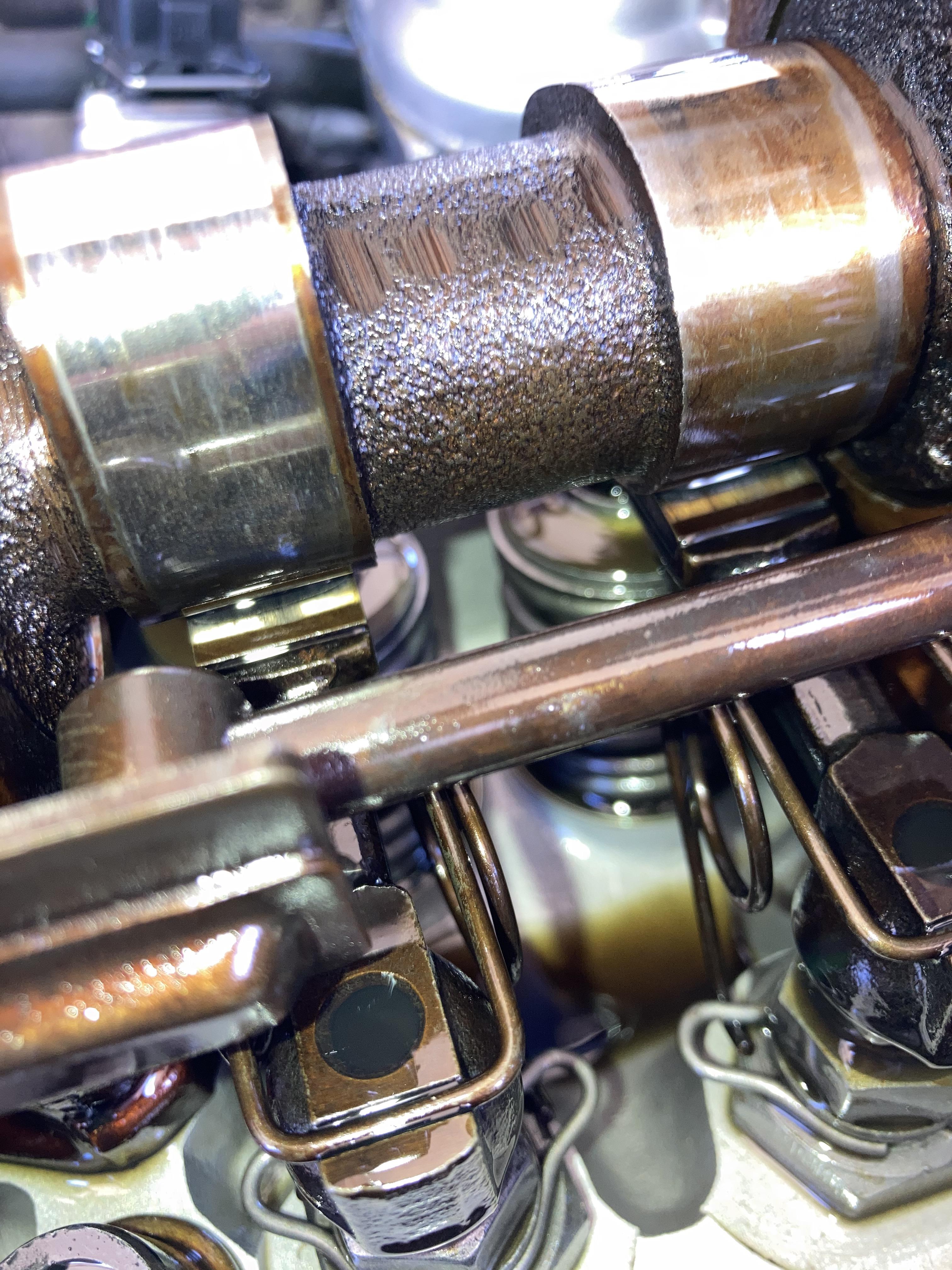

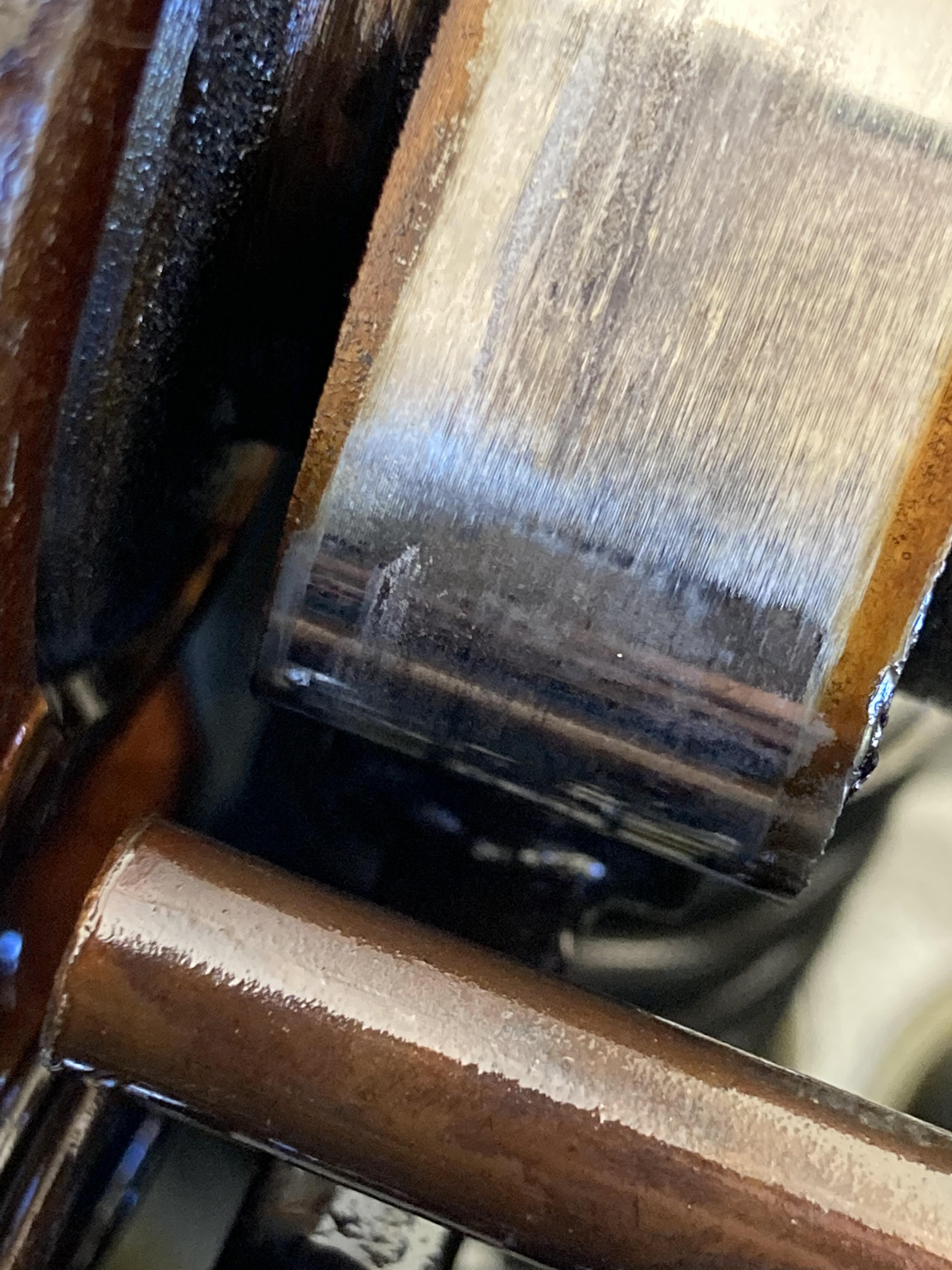

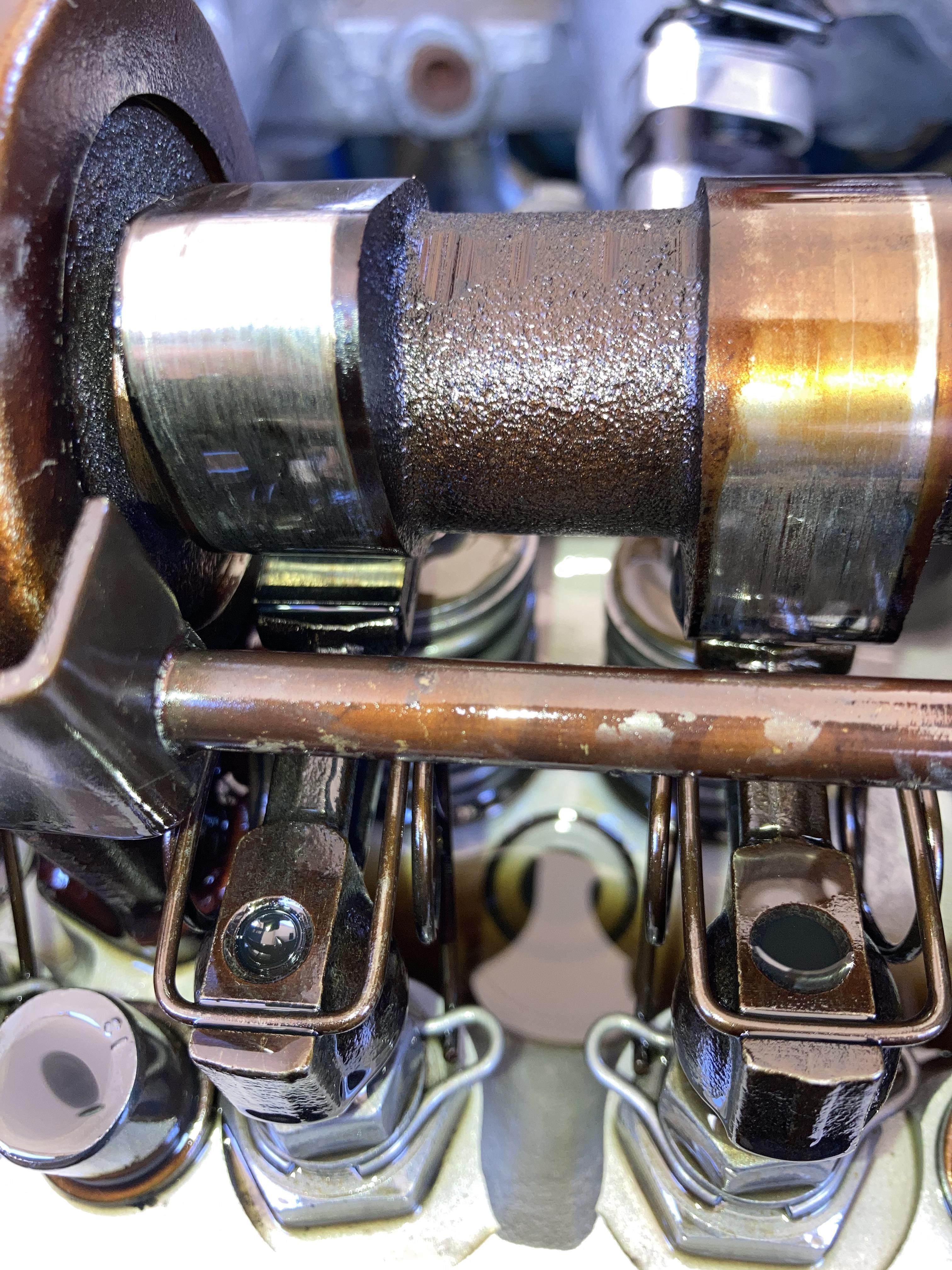

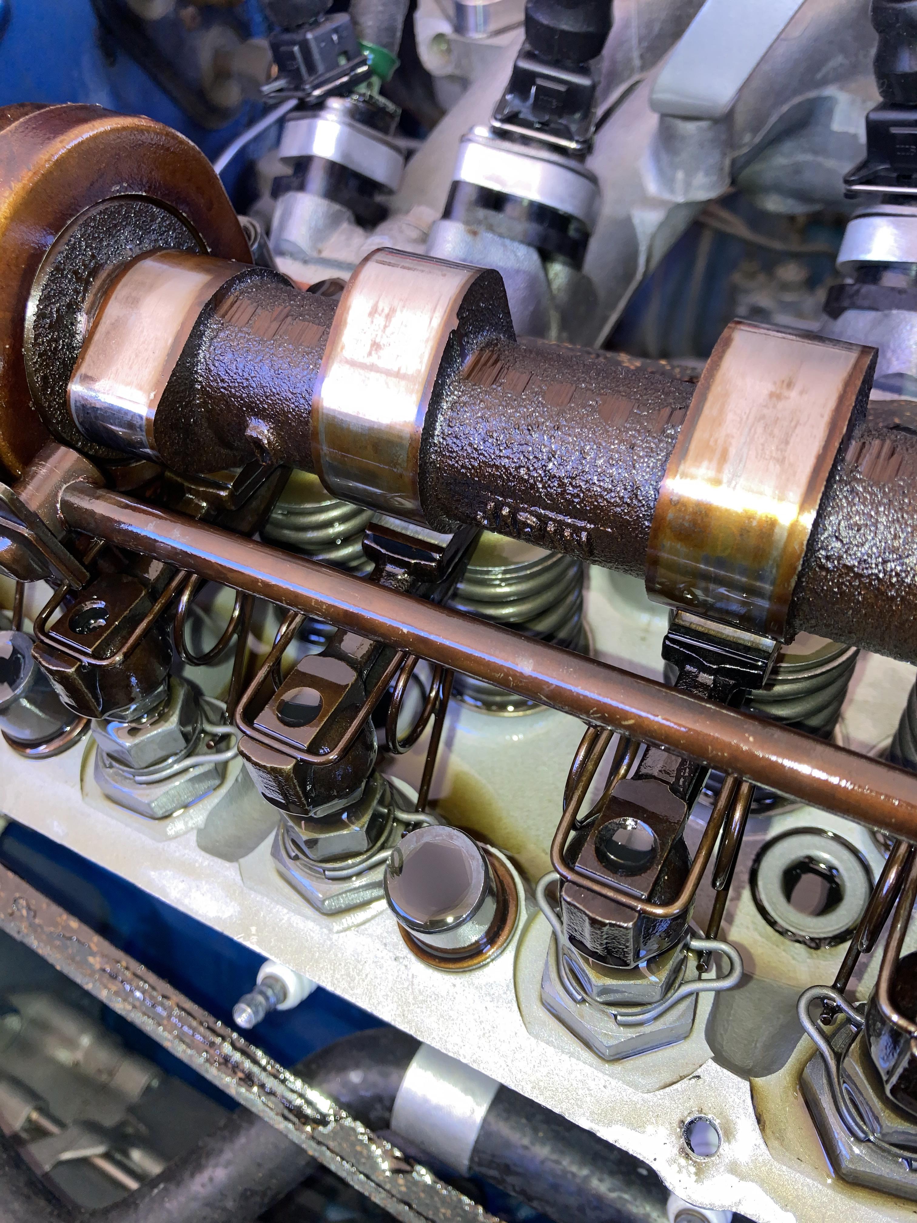

Ok, so I took a ton of photos and a video. I think my wipe pattern is ok-ish, but I may not understand the concept completely. Enlighten me. Also, the cam has score marks on it in certain places, does this mean I am screwed and need a new cam. I think I narrowed it down that my spray bar just isn't providing enough oil, however the engine wasn't turning fast either. Some holes in the bar had virtually no oil coming out, while some had decent spray for such low rpm. In addition, sometimes the oil looked like it was just spraying straight down.

Good pix of the cam. Looks like you have so damage. Could be the oil galleries  in the spray bar are plugged. I would remove the spray bar and make sure they are not plugged. Also check the holes in head that attach to the spray bar to make sure they are open. Also, I think there are gaskets the the spray bar attaches. Make sure these are not leaking.
As a note: I'm not sure  that the 77 had a spray bar. My 75 cam was damaged (loud lifter noise/couldn't adjust out)  I replace the cam with a 77  or I believe it was a 77 cam. The new cam was used and had holes in the cam lobes . This eliminate the need for the spray bar.

The cam lobes that have a shiny line all the way around the lobe are probably too tight.  The portion of the lobe with no ramp should not be contacting the rocker arm pad.  That's where the lash, or gap, is measured.  I'd recheck all of the lash measurements.
Hard to tell on your spray bar.  The head bolts and various crevices are all full of oil.  Probably fine once the engine starts.  Your cam doesn't look bad considering the time that it's been running.  Once they start to grind up the lobes it happens pretty fast.

Wow, thanks for all the replies! Do you think it is ok to keep running that cam for now?  So I think the issue with it's oiling efficiency is that I half assed the gaskets. I used a cork type gasket instead of rubber, because it is what I had at the time. You can see the cork is sopping wet, because it is obsorbing the oil and I am sure letting some leak out. I am going to find a rubber sheet somewhere and make new ones, hopefully that will help. None of the galleries were clogged. New valve adjustment coming up as well.
The car is a 1/77 280z. So I am not sure when they switched to an internally oiled cam. This is what the car had when I got it, and it was a pretty unmolested car. Is an internally oiled cam better?

So you had a internal oil cam and spray bar? I was told by a Z mechanic if you used both you wold have very low oil pressure.
I totally agree.. I don't think thats original.. if you do want that you need a bigger oilpump !!
In this pic i see a lot of wear on the left lobe.. it's eating the lobe.. not good.
If you want to install a new camshaft, also check the rest!

Another update after a hard day's work. The Datsun has won again. Did a valve adjustment, some of the specs were crazy off. Mostly tight, but definitely not at what I set it to before. Redid the oiler gaskets with new proper ones. Realized that I didn't even have a gasket in the middle:( Anyways, fired it up, cold it was quieter, but once warm it was louder than hell from the valvetrain. I am thinking it's time for a new cam, internally oiled, and probably a hotter cam as well. So that's loss number 1
