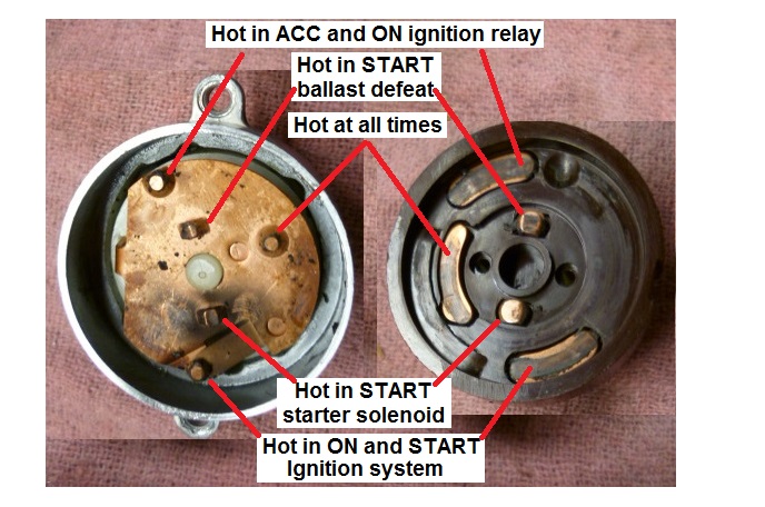

The small yellow wire that activates the starter seems to be low amperage. Why does this need to go through a relay?
I have measured the current into the starter solenoid in the past, and while I can't find my notes, I believe it was approaching 10 Amps. Seven or eight maybe? I do know that it's enough to eventually burn up the insides of the ignition switch:
So if you're planning to use a push-button non-stock starter button, you could use something beefy and maybe get away without a relay. But if you're planning to use the stock ignition switch, I would suggest a relay to cut down on the current to the switch.
I think it's mistake that Datsun didn't do that from the start and if you're already making changes to harnesses and stuff, it would be the perfect time.

Well honestly, I'd put in a relay anyway even if you find a switch "rated" to 10A.
Why? First because switch ratings are usually lots of garbled confusing corner cases that rarely reflect the real world conditions under which they're used, and second, If installed using a socket, a burned up relay is a lot easier to replace than a burned up switch. And probably cheaper too.
You're making a harness from scratch? I'd just cover my bases and wire in a relay between the switch and the starter solenoid.
10A DC is not something to be trifled with in the switch world. It burns up contacts. And if you're using it to power an inductive load, it burns up contacts even betterer.
