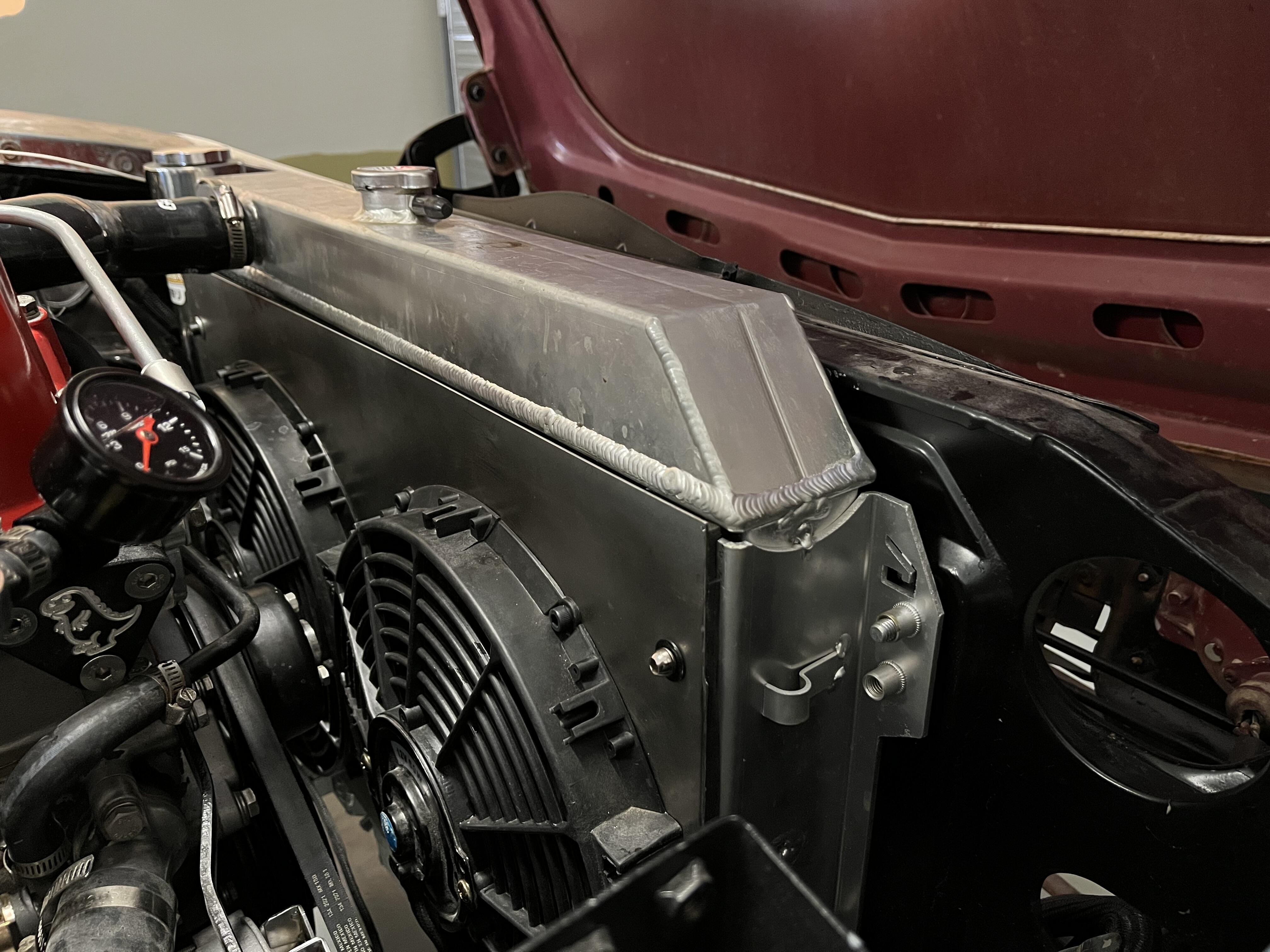

Regardless, times are good and I have been able to finally take the car out for a spin longer than 1 minute! I was having some high temp readings with my radiator setup. Nothing too crazy, but sitting towards the M on my TEMP gauge. Since I am running no shroud, I did a quick DIY with some left over aluminum and foam to get a seal. I am now always running right in the middle temp. I also grabbed a generic overflow container and just waiting for the line to show up in the mail.

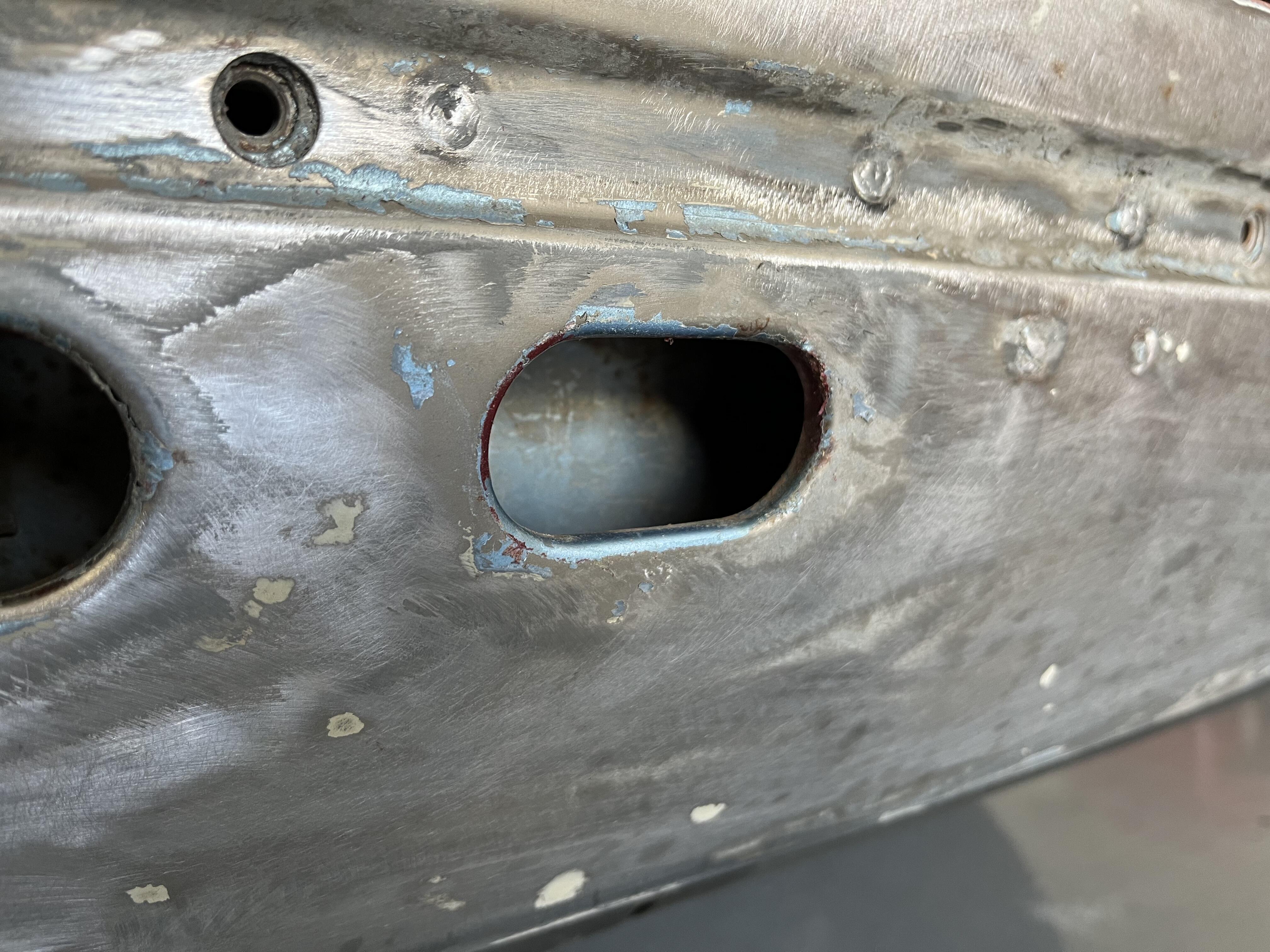

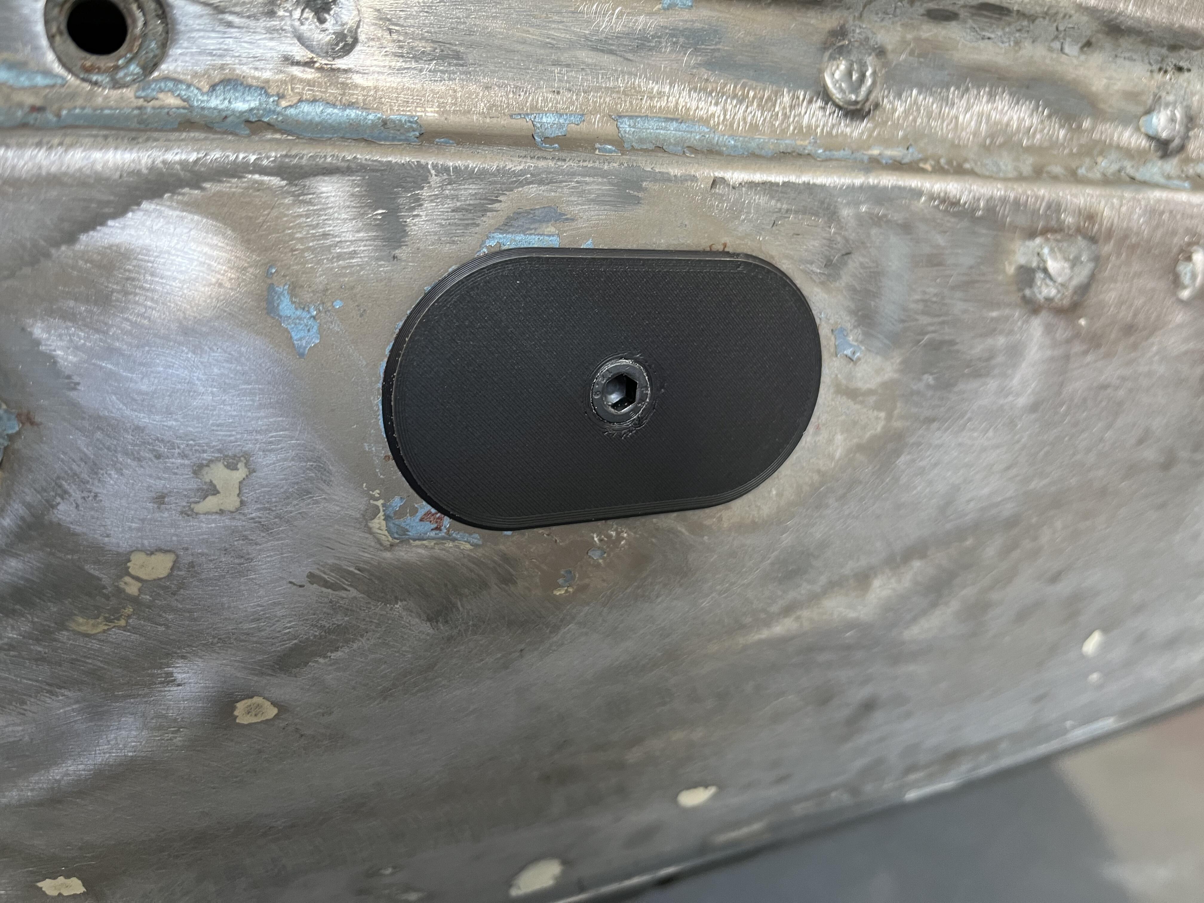

Other than that I have been busy working on some new bumper plates and other misc. fill plates. I originally used a snap in design but the tolerances were so tight that I would occasionally run into broken clips or a loose fit. I switched up the design to be a two piece clamp style. This will give me room for any variances in peoples bumpers while still providing a nice solid mount. My goal for this design was to provide a bolt in solution. I know many people don't have access to a welder or don't want to sand their paint, weld, repaint. While this doesn't provide as flush and clean of a look, it is still better than a gapping hole in my opinion. These are sandable, paintable, and wont warp due to heat. Here is an example for the small bumper holes, but I have created plates for all the rear bumper ones, even the awkward side bumper mount holes, as well as for the side indicators. I hope to start selling these soon!

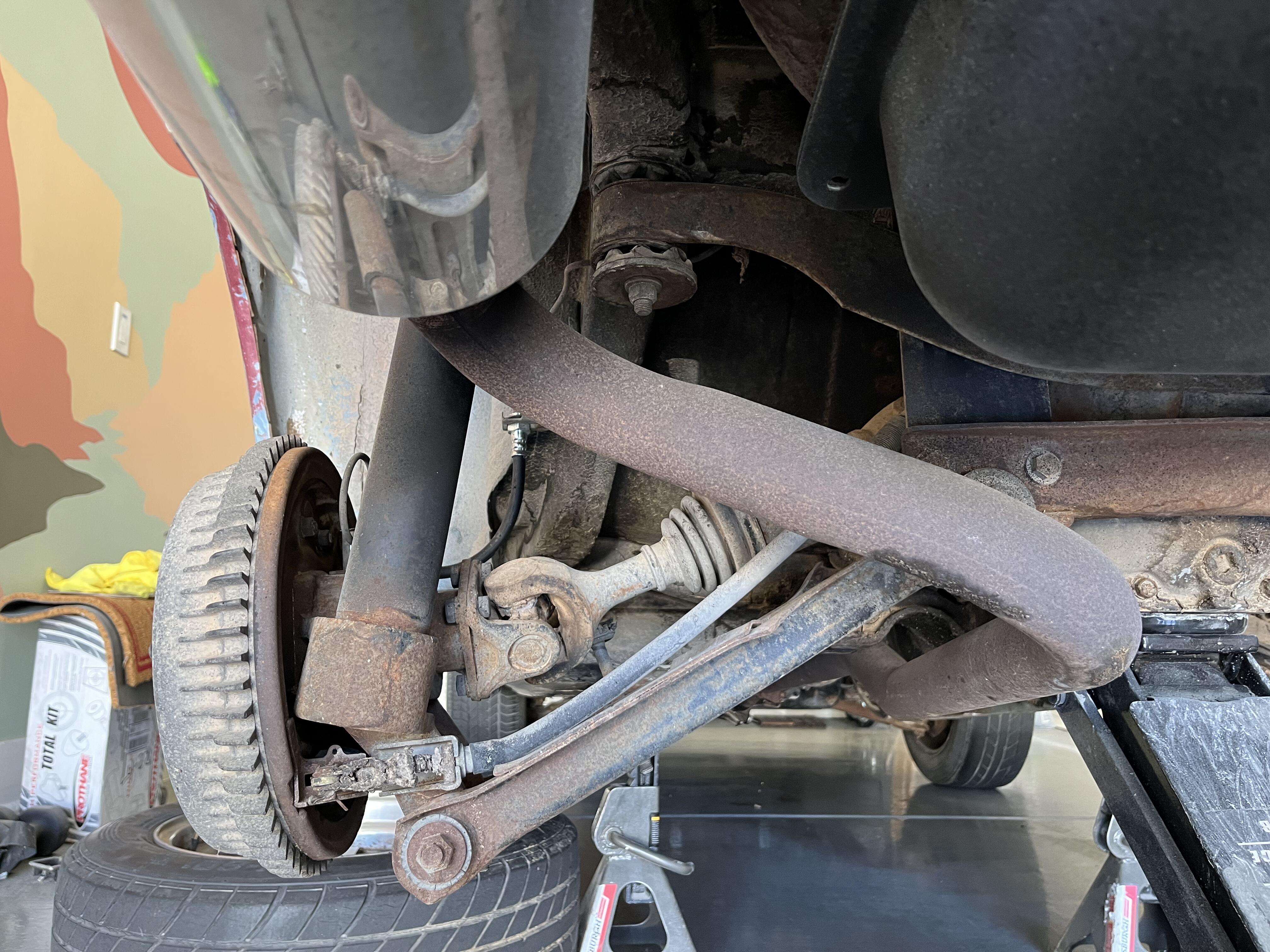

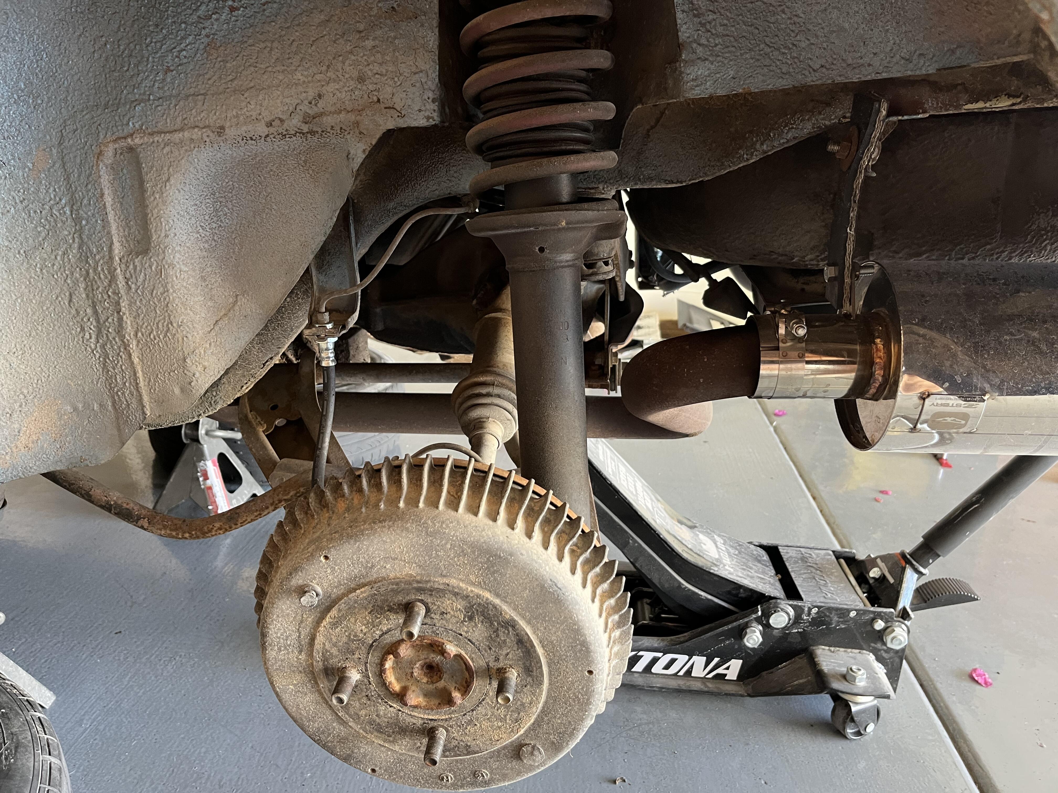

Today I spent the afternoon tackling the rear suspension. I’ve been dreading this since I first started my restoration. The spindle pin horror stories prevented me from doing suspension before the engine but we are finally here.
I started off by ordering a set of eibach springs and Koni yellow struts. Topped off with a poly bushing kit, urethane bump stops, and MSA’s street camber strut isolators. All four of mine are toast and it is the same price as going with an oem replacement.
Here’s what we’re working with. Luckily being and Arizona car, there’s little rust.
Don’t worry, the exhaust is not welded up and just there until I can get it to the shop 🙂
Thanks to @Av8ferg for the tips in his build log on how to remove the rear end, everything went super smooth. I had the entire assembly out in just about two hours.

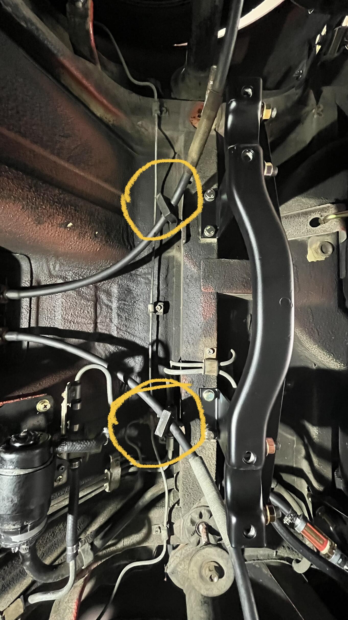

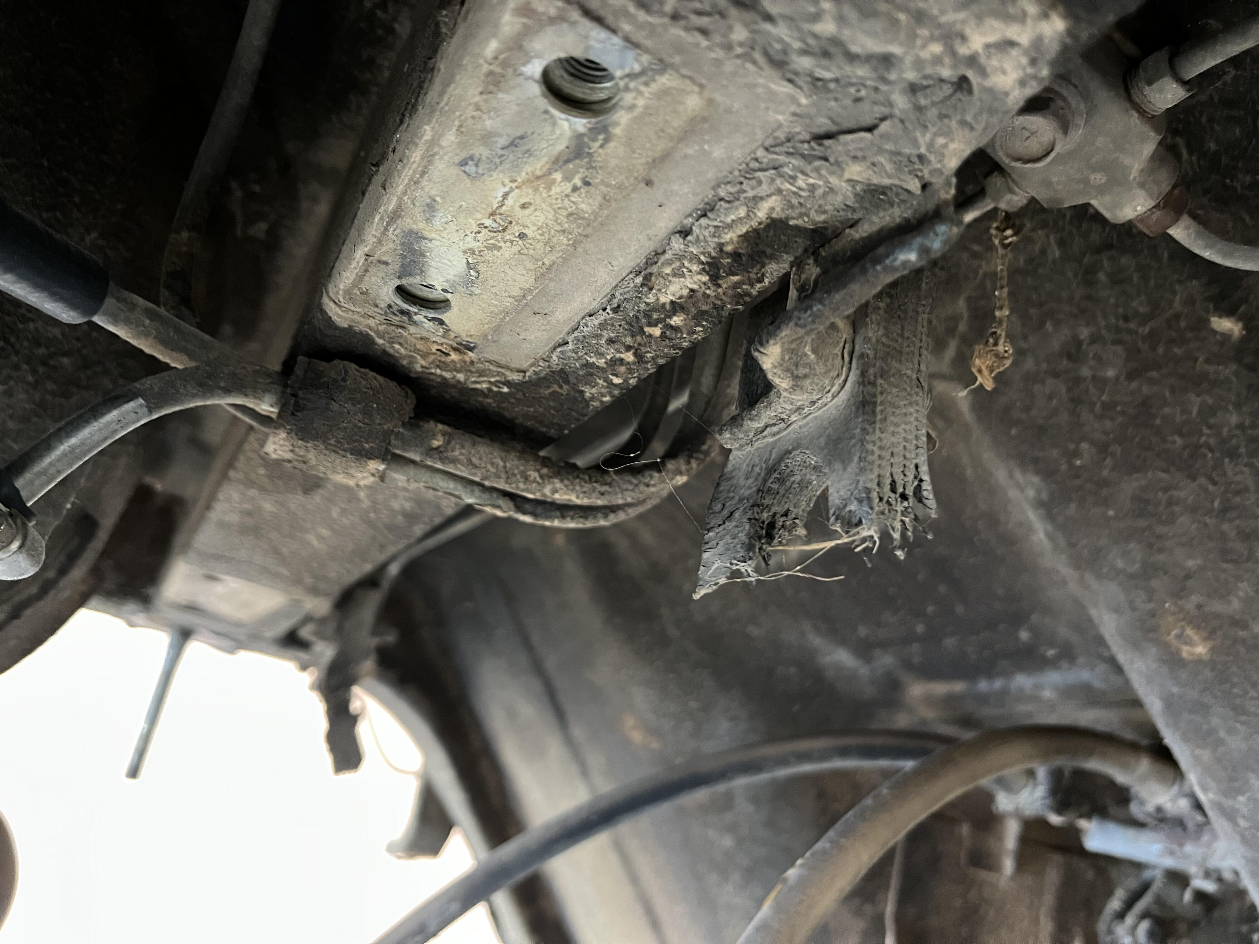

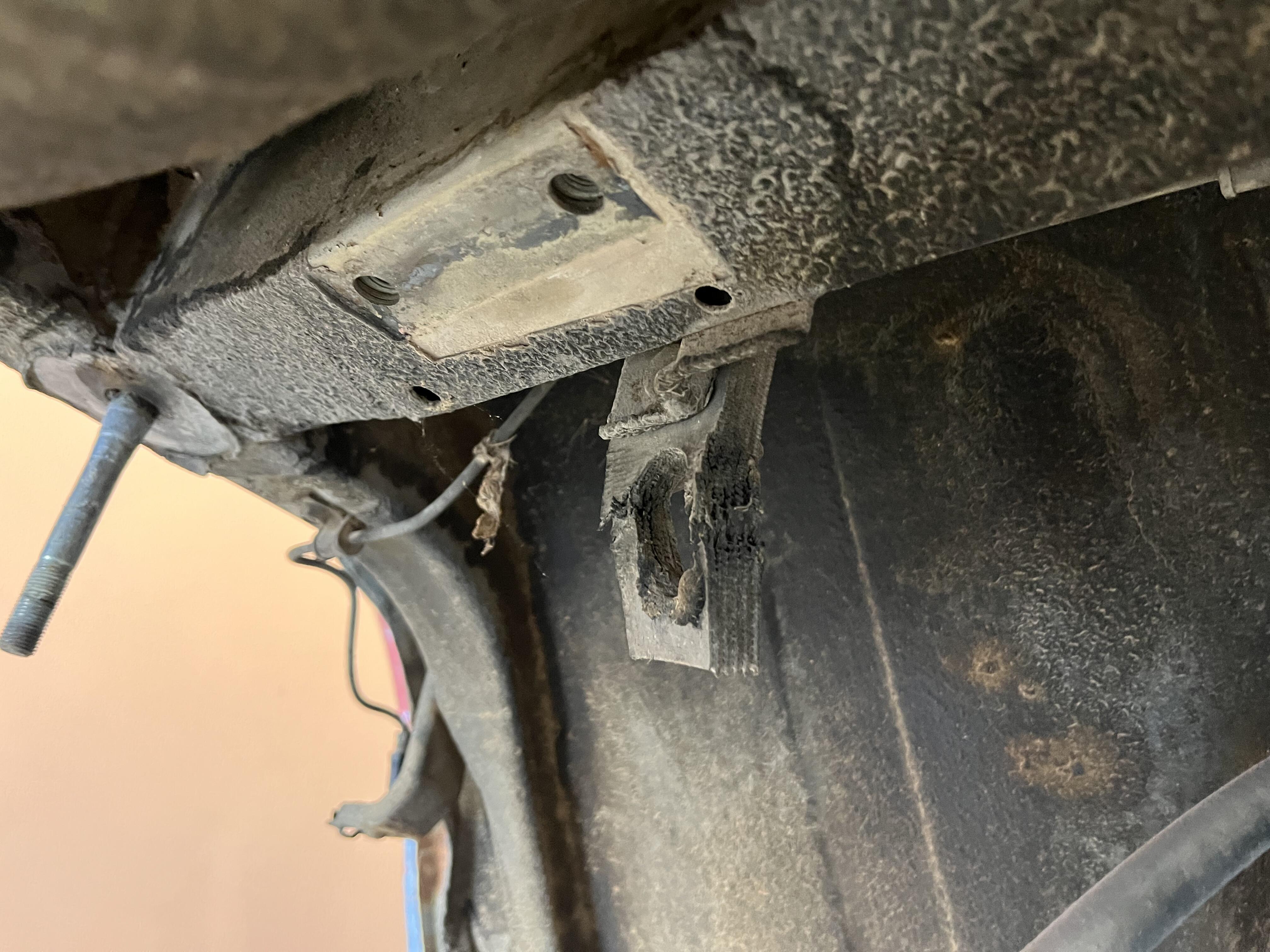

My diff strap was still in one piece but brittle as hell so I’m glad to go with the technoversions diff mount. I did notice these two straps that are torn, can anyone let me know what these were for? I originally thought it was an exhaust hanger but there is one on both sides and they’re too short for a hanger.

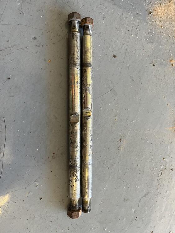

I was going to leave this as is for now. I didn’t want to dig into the spindle pins until the weekend in case things went south. I told myself, okay let’s undo the locking pin only. But it my surprise they came out without a fight. With the spindle pins staring me down ready to fight…I gave in and grabbed my breaker bar. Each pin had one nut that was fairly tough to release and then one that was nice and smooth. I imagine this is due to the direction it was facing on the car. I didn’t have a sledge hammer handy or a puller but I grabbed a standard hammer and started to give it hell. Within 3 blows it started to move! I couldn’t believe it. In the end, both pins came out without a fight. I think the Datsun gods gave me a lucky draw today…or maybe it’s just the Arizona car 😉
lots and lots of cleaning to do but the part I was dreading is passed. Knock on wood my bushings don’t put up a fight as revenge!
Dan, you’ve made some good progress.   I’m about to start reinstall.   I took this pic for you showing the e-brake cable routing through those hangars.   I think you could use Muffler Hangers from AutoZone.  I know they have them.
